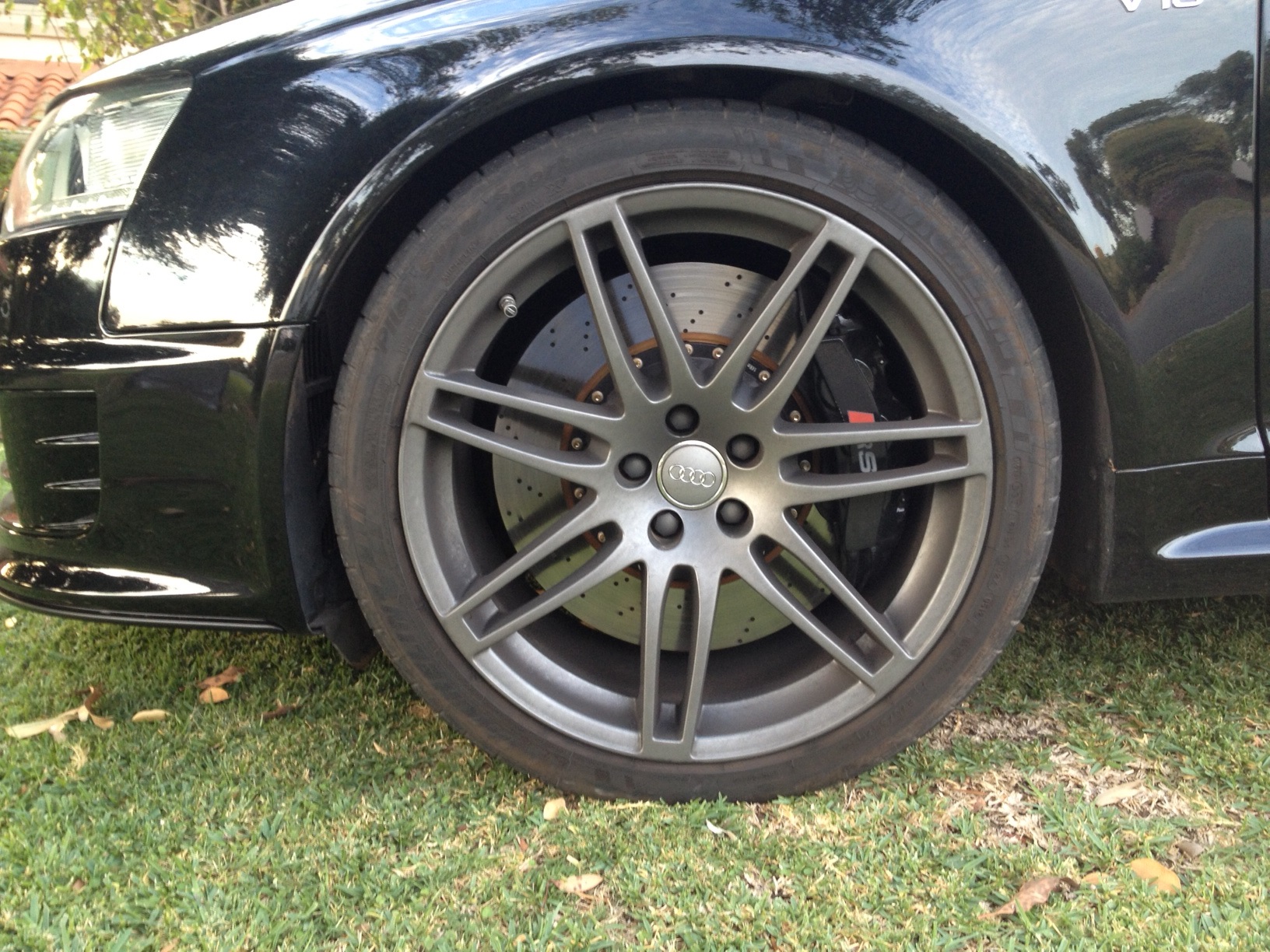

getting back on topic re the brake upgrade available for the RS6, I ran the RS6 at the local drags with the Michelin PSS and MTM 390 steel fronts.
Could only manage 11.4 secs with terminal speed of 204 kph. The Michelin PSS were spinning a bit on take off so may have affected the ET. The RS6 felt stronger with the secondary cat delete JCfabweld exhaust as per the improved performance at the Wyalkatchem Racewars 1000metre sprint.
A real positive from the run at the drags was the car pulled up a lot quicker in the braking area with full confidence with the MTM 405mm front steels compared to the OEM front 390mm steels on the OEM 20" rims.

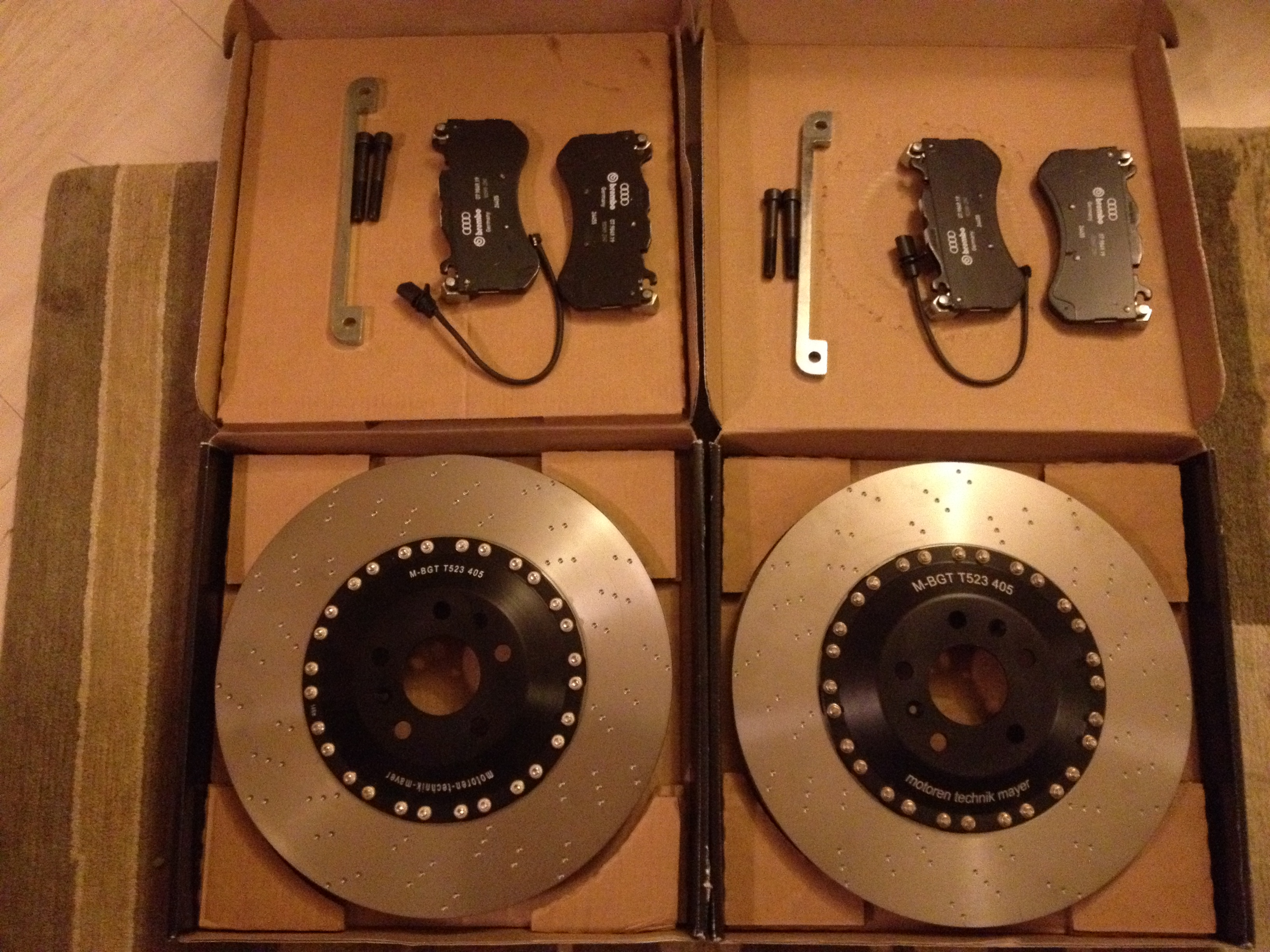

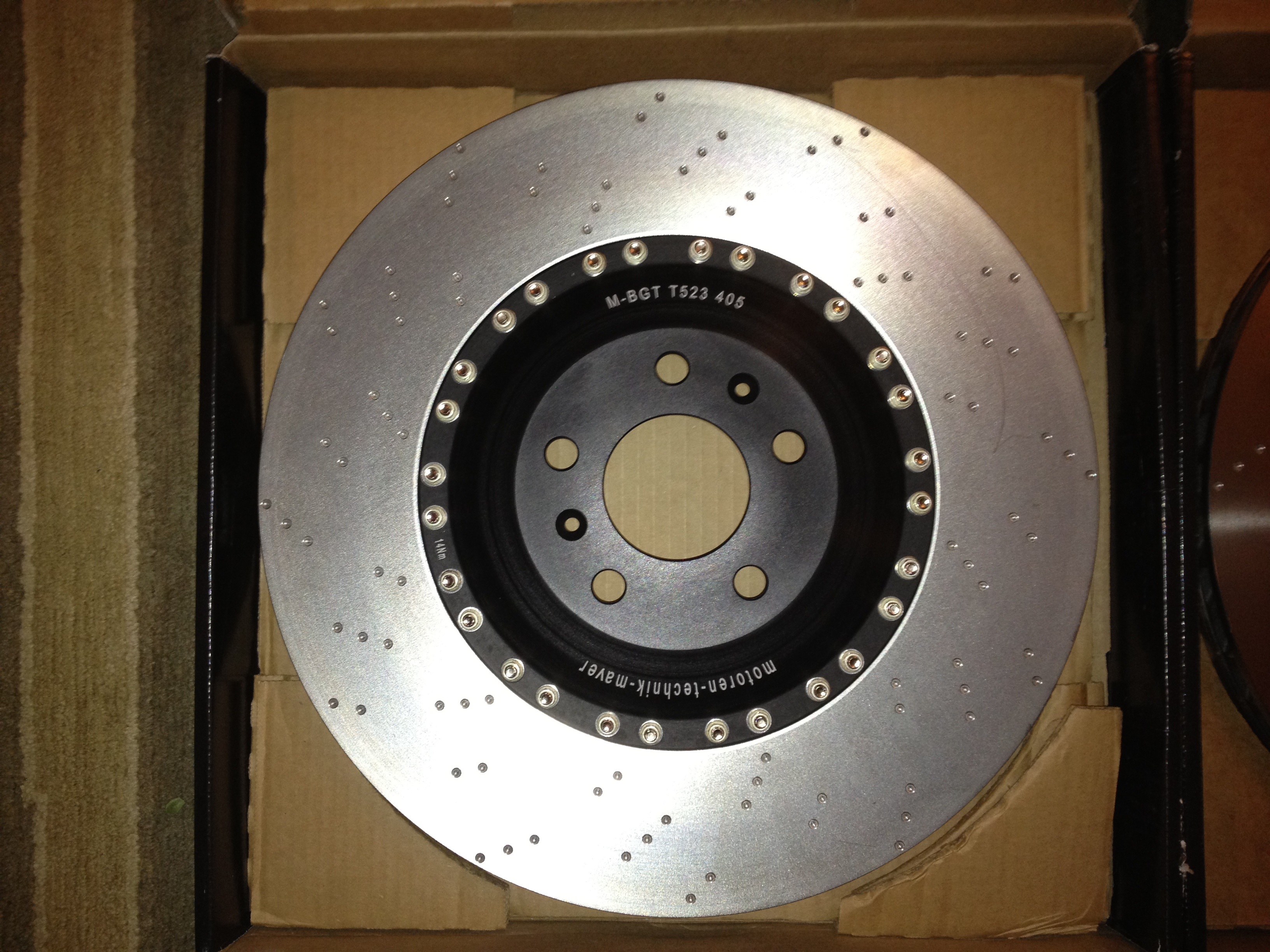

I enclose some pics of the 405 mm front steels with the mtm bells/hubs and Performance Friction 405 mm friction rings on the RS6. Also the kit supplied by MTM. The 405 mm fronts enhance bragging rights

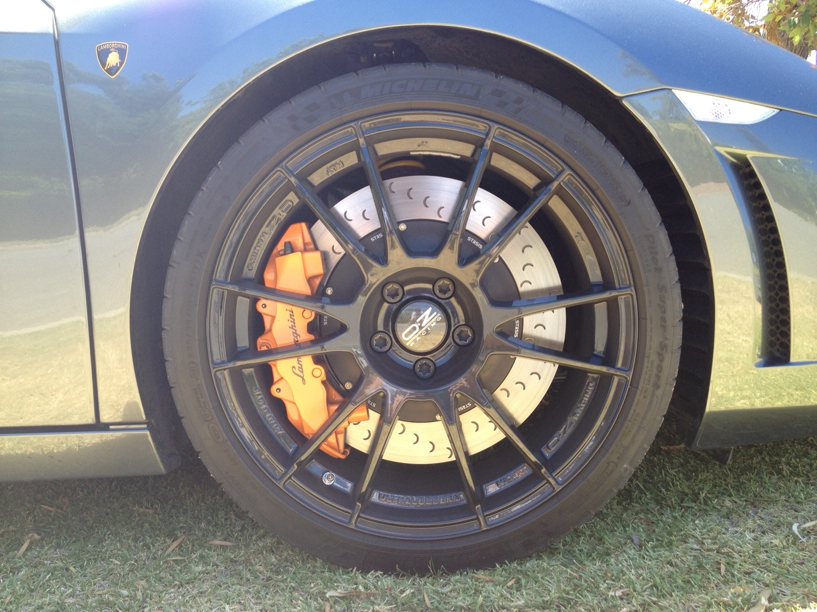

As a fan of steels, I have also increased size of front rotors on the Gallardo 19" rims from OEM 365mm to maximum size Stasis Audi R8 390mm Alcon rotor upgrade. Noticeable increase in braking power.
I cant argue against ceramics, but I did want to have to upgrade ABS etc. with installation of ceramics. The 405mm steels are not grabby when cold. Brake application feel is just like the standard OEM steels.
Just my two cents worth.

The MTM brake kit looks great! Im also a fan of steels as I think the dosing of brake force is easier.
