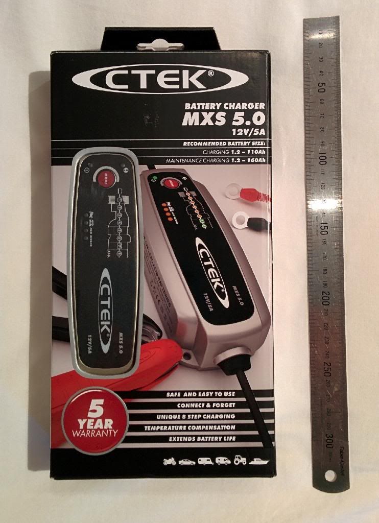

I've been hovering over the buy button on a Ctek MXS 5.0 (with red button) for weeks now. Is this the same one everyone else uses and recommends?

I have the MSX-10 which is beefier than the 5. :bigblink:

What I've got, from Ultimate Finish iirc. It's all you'll need. Everyone with a 3+ year old car should have one. Surprised more don't know about these.

Cheers. Well, now have one. It's actually a bit smaller than I was expecting, but not a bad thing as running short of space in the garage anyhow! :beerchug: Image
