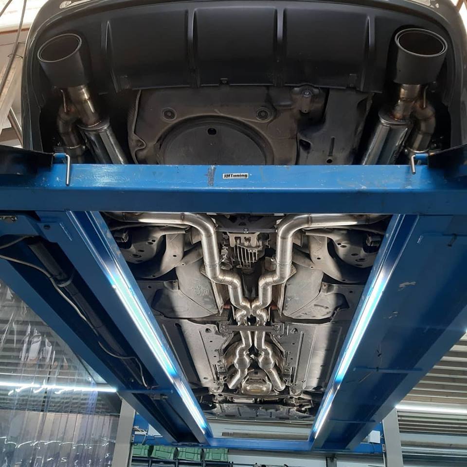

I found some pictures of the exhaust system. Apart from the X-over it looks really good.
https://www.facebook.com/JDEngineering. ... =3&theater
https://scontent.fltn1-1.fna.fbcdn.net/ ... e=5F5F1D2A
Nick
