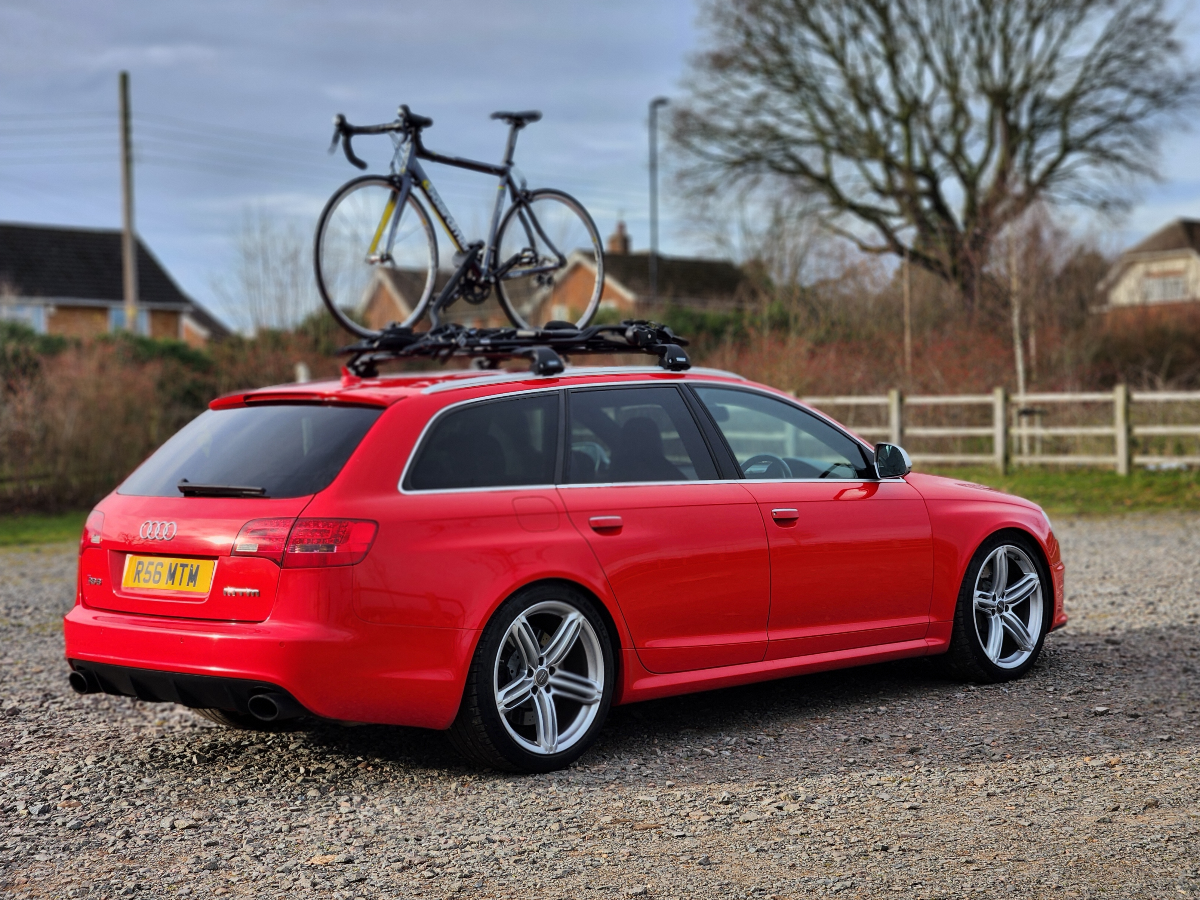

Coilovers fitted 😀
Set the height slightly higher than I want it at as it should set a little lower after being driven a little. Will make final adjustments next weekend.
Will measure it up to decide how big spacers I need too.
Set the damping to 4 (around half way but a little to the firmer side) and it feels great.
Coded the DRC out (unchecked the elec suspension options using Vagcom and removed 2 fuses on the passenger's side).
Happy days 😀
