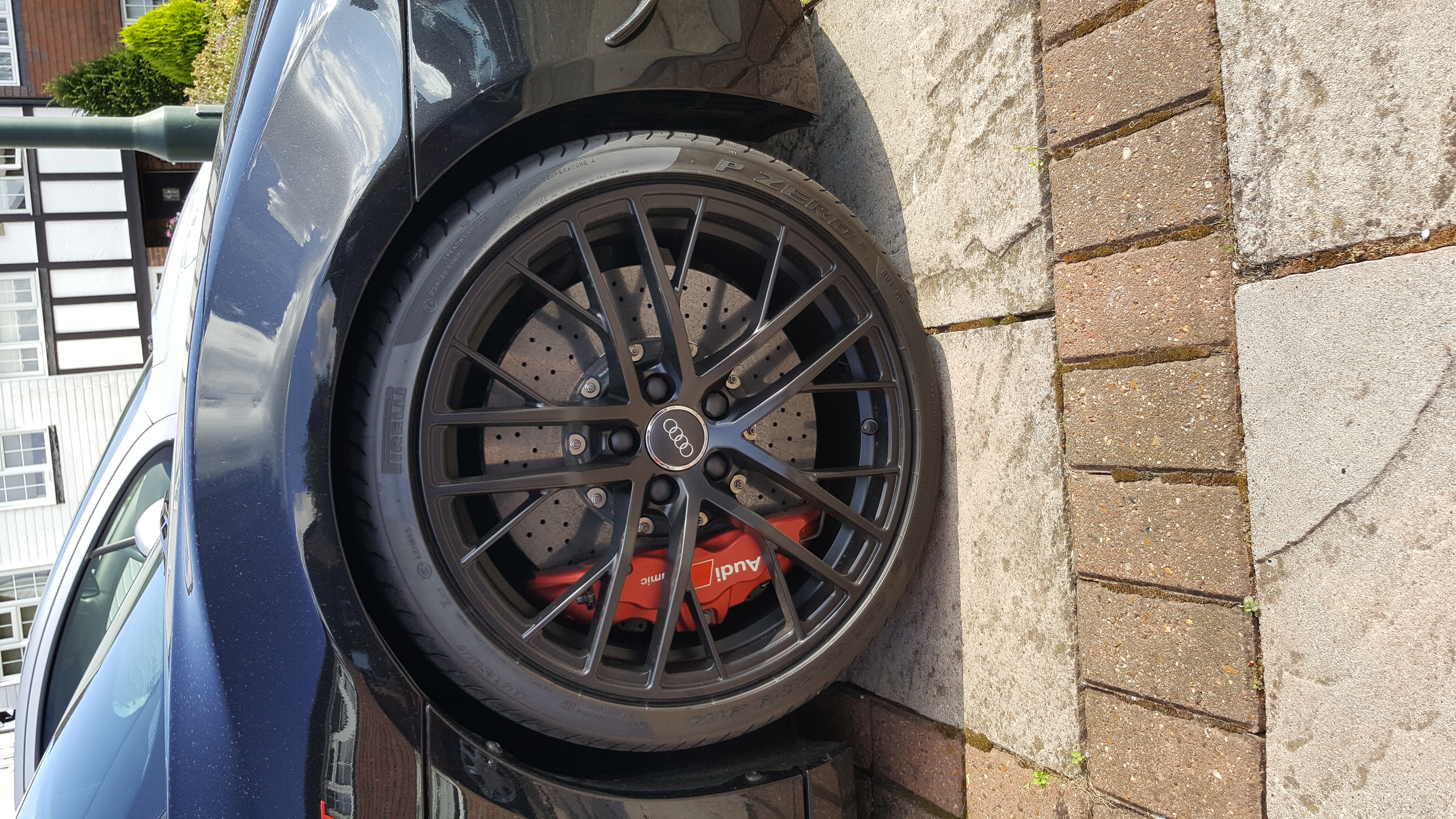

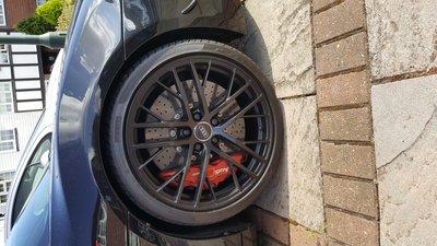

Post by classba » Thu Jul 28, 2016 1:41 am
LMAO... I best swap out my R8 GT ceramics to their lesser capable steel brakes to take it on the track... hang on... but the R8 GT is made for the track so I'm well Feck'd then lol :) Best call Audi Gmbh to ask them to read this thread and to learn something. LMFAO. You got to laugh :)
To all those that has not experienced the ceramics in a C6... I will ask you this.... would you straight swap with NO cash exchanged for your so called TRACK spec steel discs set up for the OEM ceramics if you were given the chance??? :) Go on make my day and say "NO". :biggrin3:
