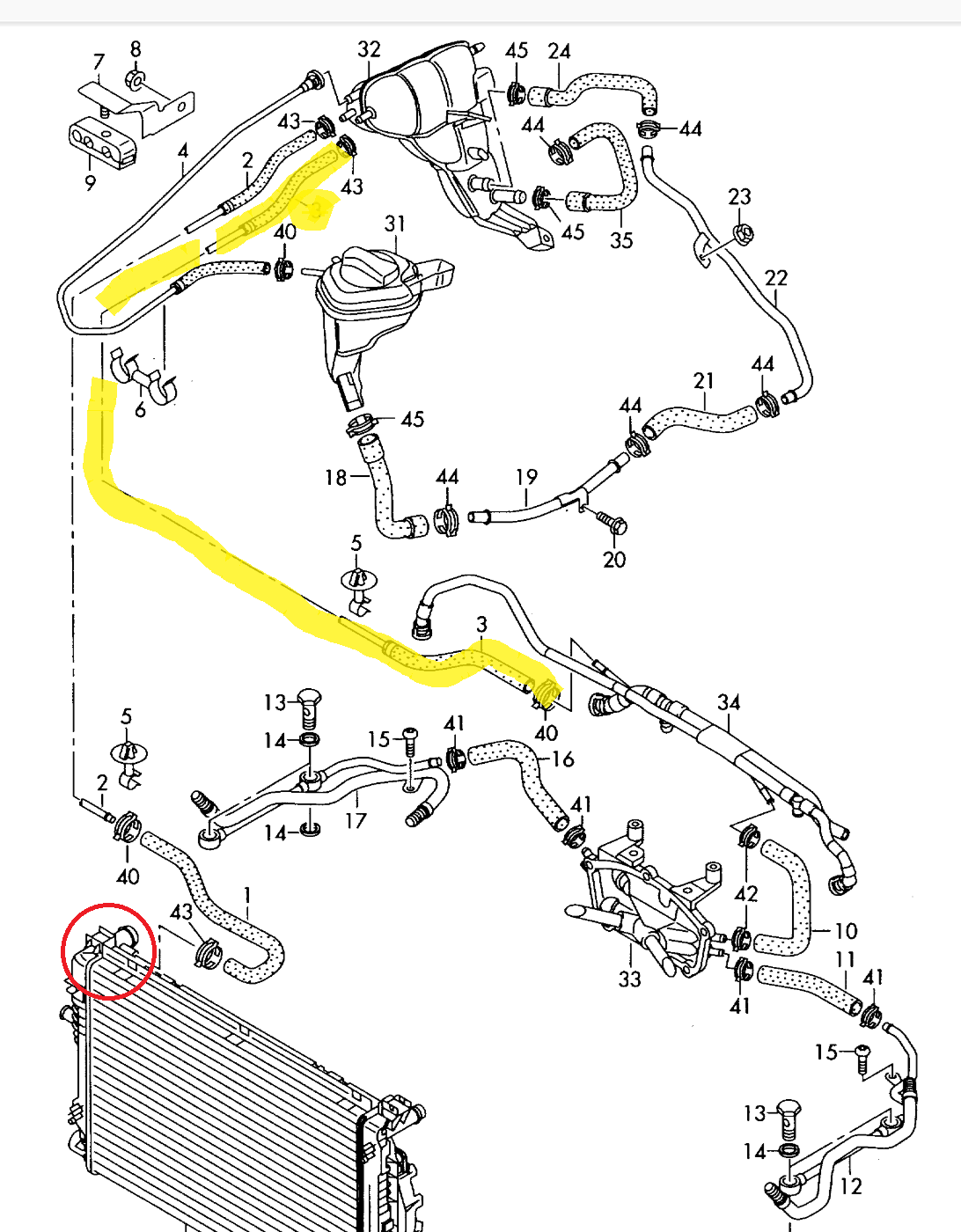

Once I'd completed that I located another coolant system problem with the plastics lines that go under the same side wheel arch into the main reservoir (Yellow number 3 Part in the diagram

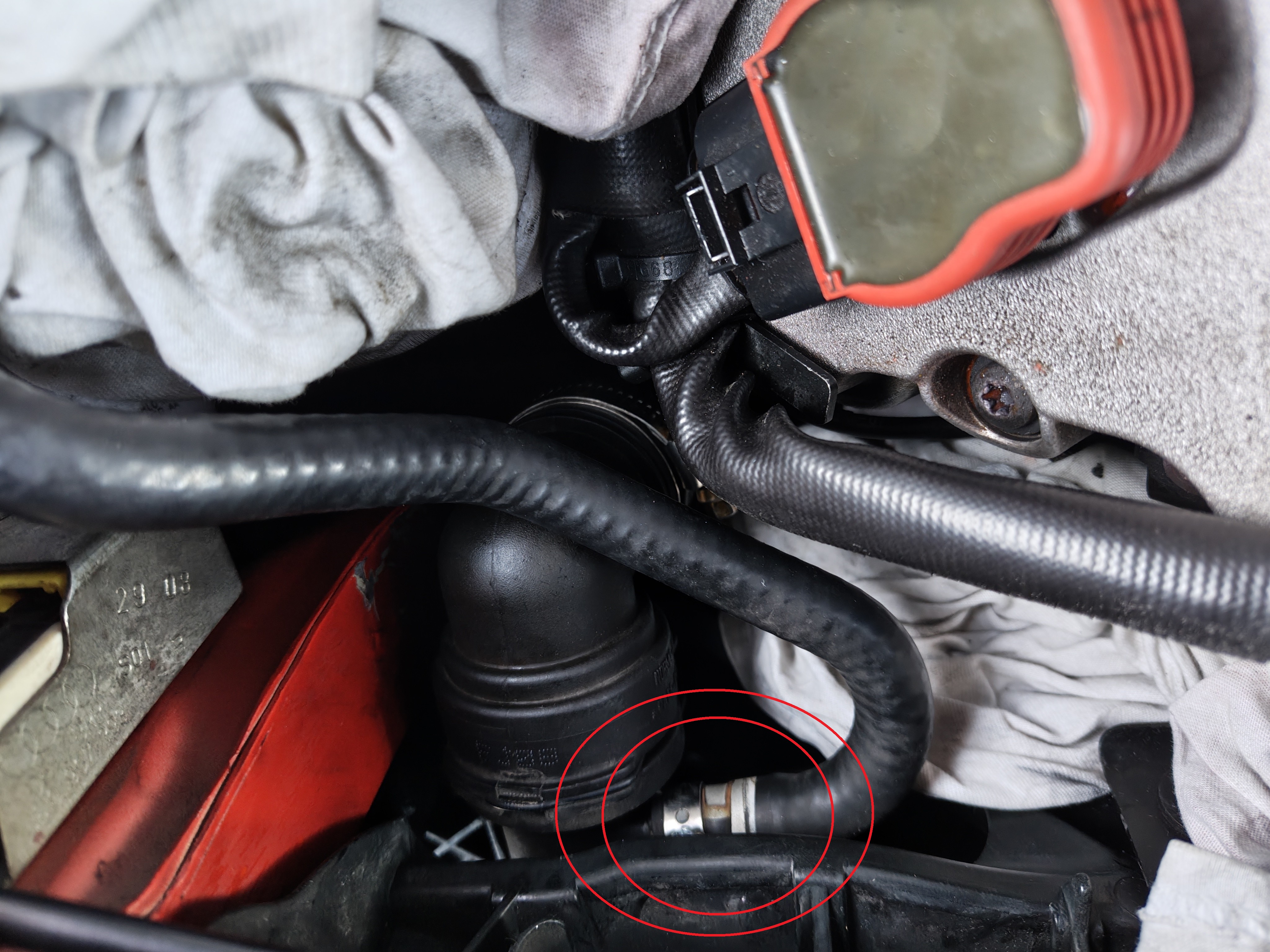

). So I replaced one of these with some hose and clamps, chuffed that I had plugged all the problems with the system. I did not bleed the coolant system properly (!!!) and proceeded to take it for long relaxed drive. I think we did about 90km. Just as I was nearing home a radiator hose blew off and the I dumped majority of the coolant on the ground and the engine temp started heading in the wrong direction.
Having today fixed that radiator connection (see attached pic ) with another hose clamp, I noted that the smaller coolant (return?) line that goes into the same junction on the top corner of the radiator (red circle in the diagram and bottom right of photo) is buggered. There is literally not much plastic to clamp a hose clamp back on to and I guess this is actually part of the radiator side ?? Is it possible to get a replacement for just this part or do I need to get a whole new (very expensive!) radiator just to resolve this small piece of broken plastic on the corner?

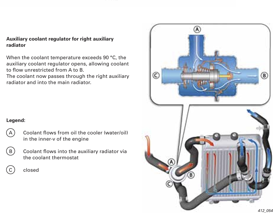

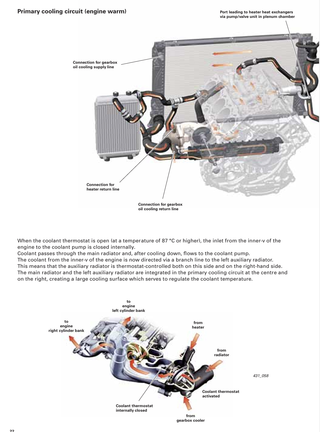

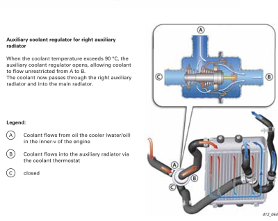

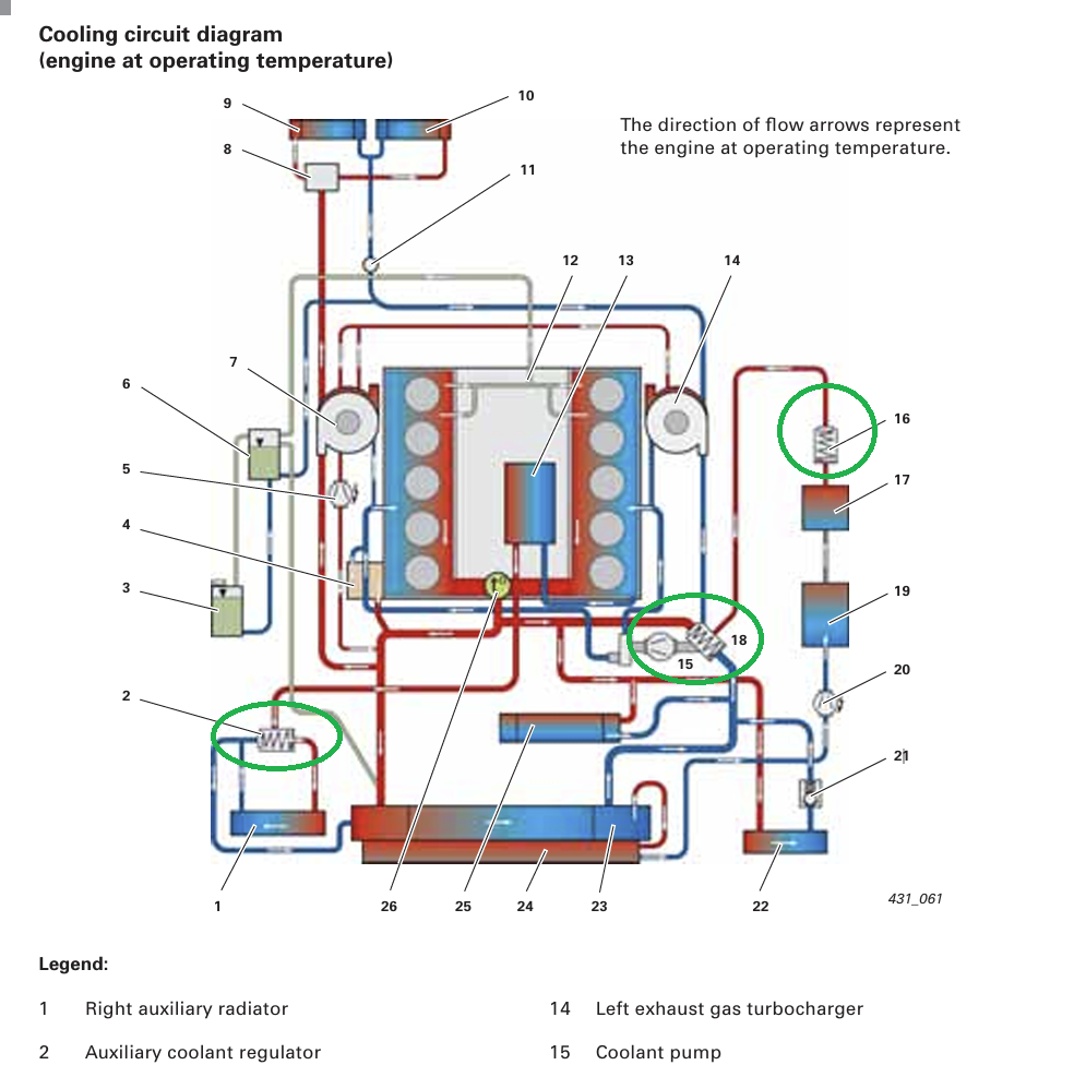

To partly answer my own question about the Thermostats it looks like it has 3:
