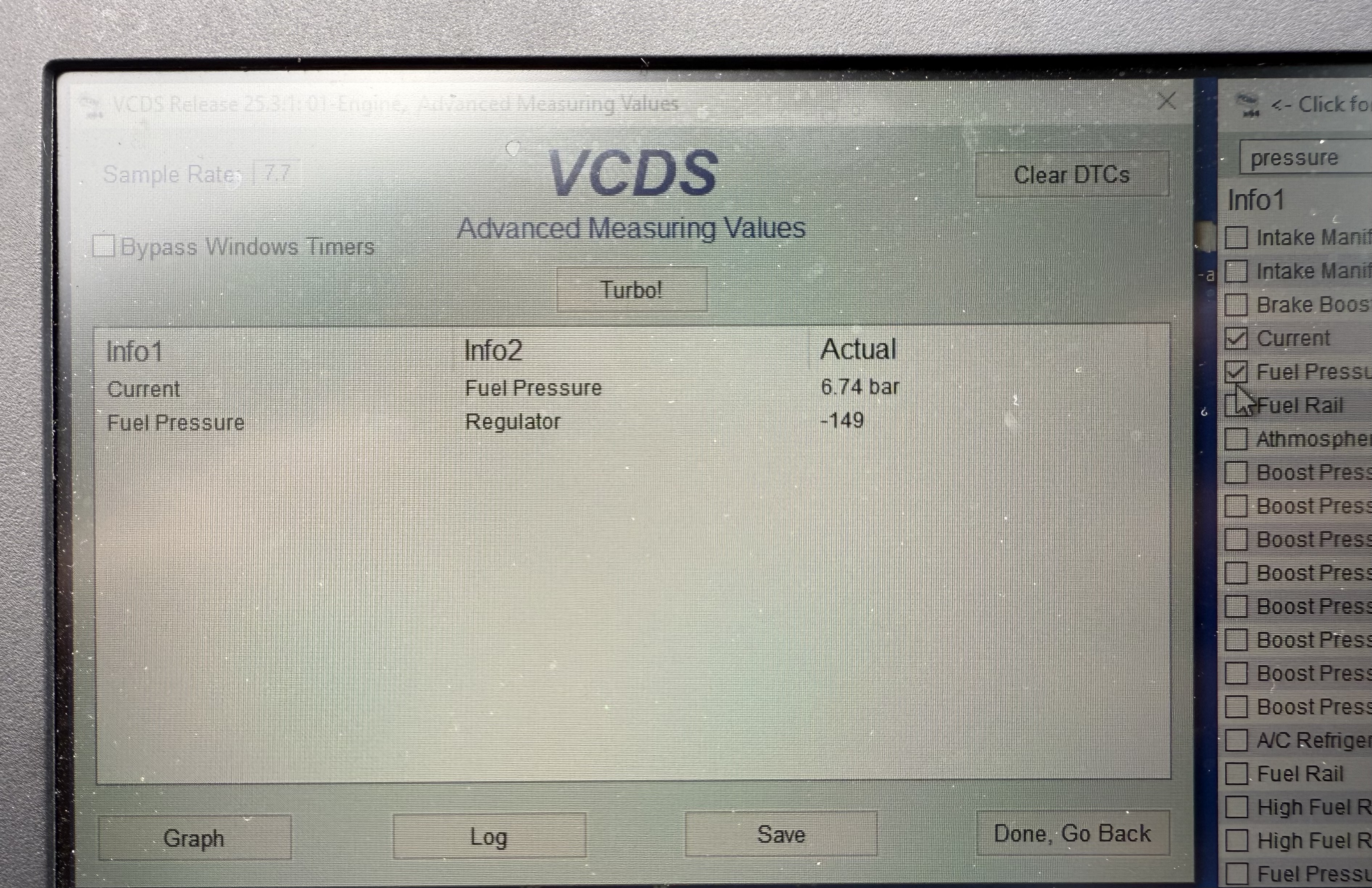

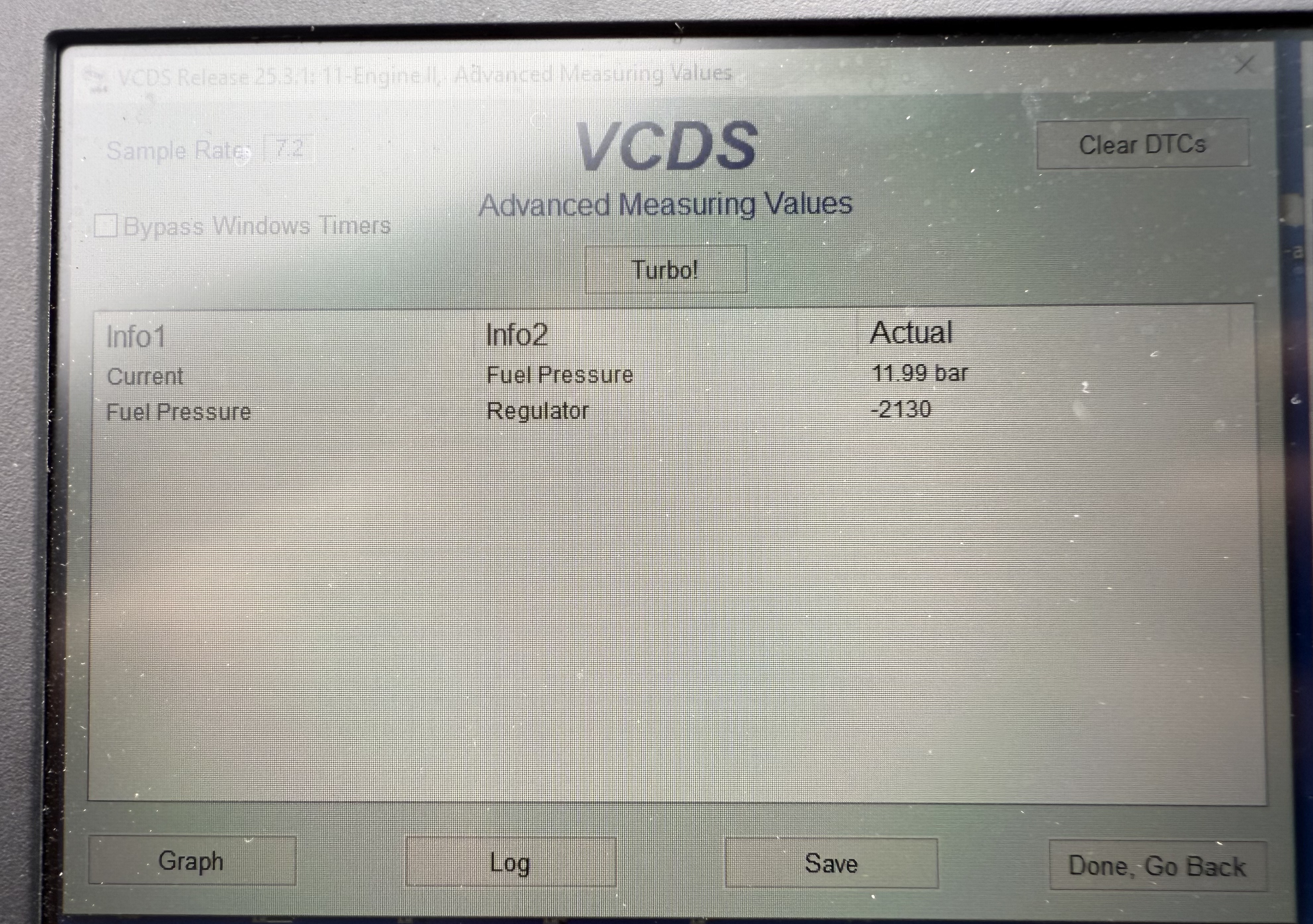

Hi Ian,
Below you have the readings from my car. As you said, there is only 1 low pressure sensor, so my logical guess is that since the ECU's are in a master-slave setup, the 2nd once can't get a reading from that sensor.
ECU1:
ECU2:

Post by IanH755 » Sun Jul 13, 2025 4:26 pm
Awesome, thanks for that, kind of confirms the "only ECU 1 gets the signal" theory for me and means my fault must still lie elsewhere.
