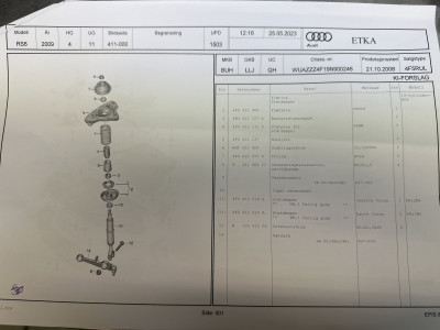

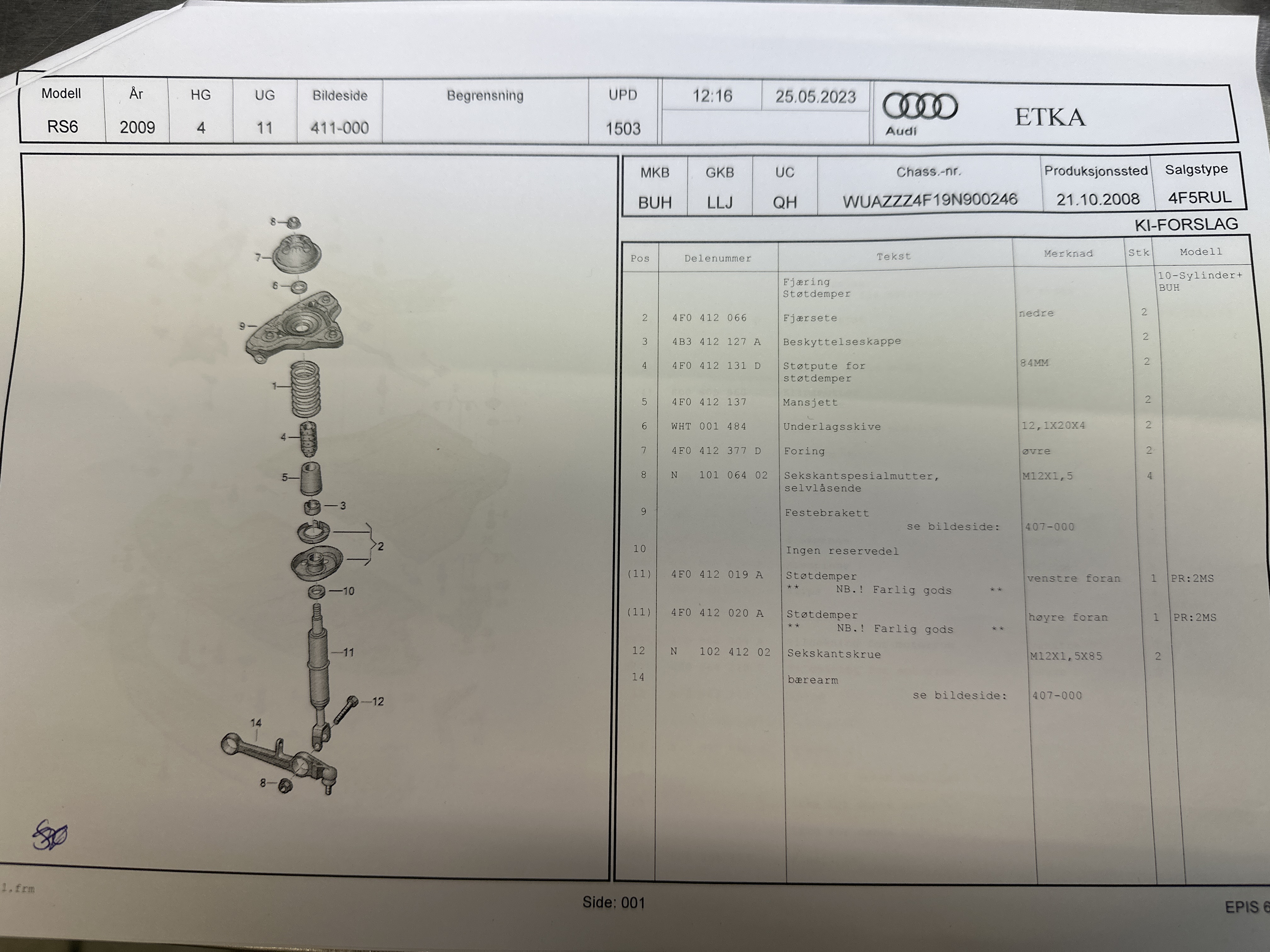

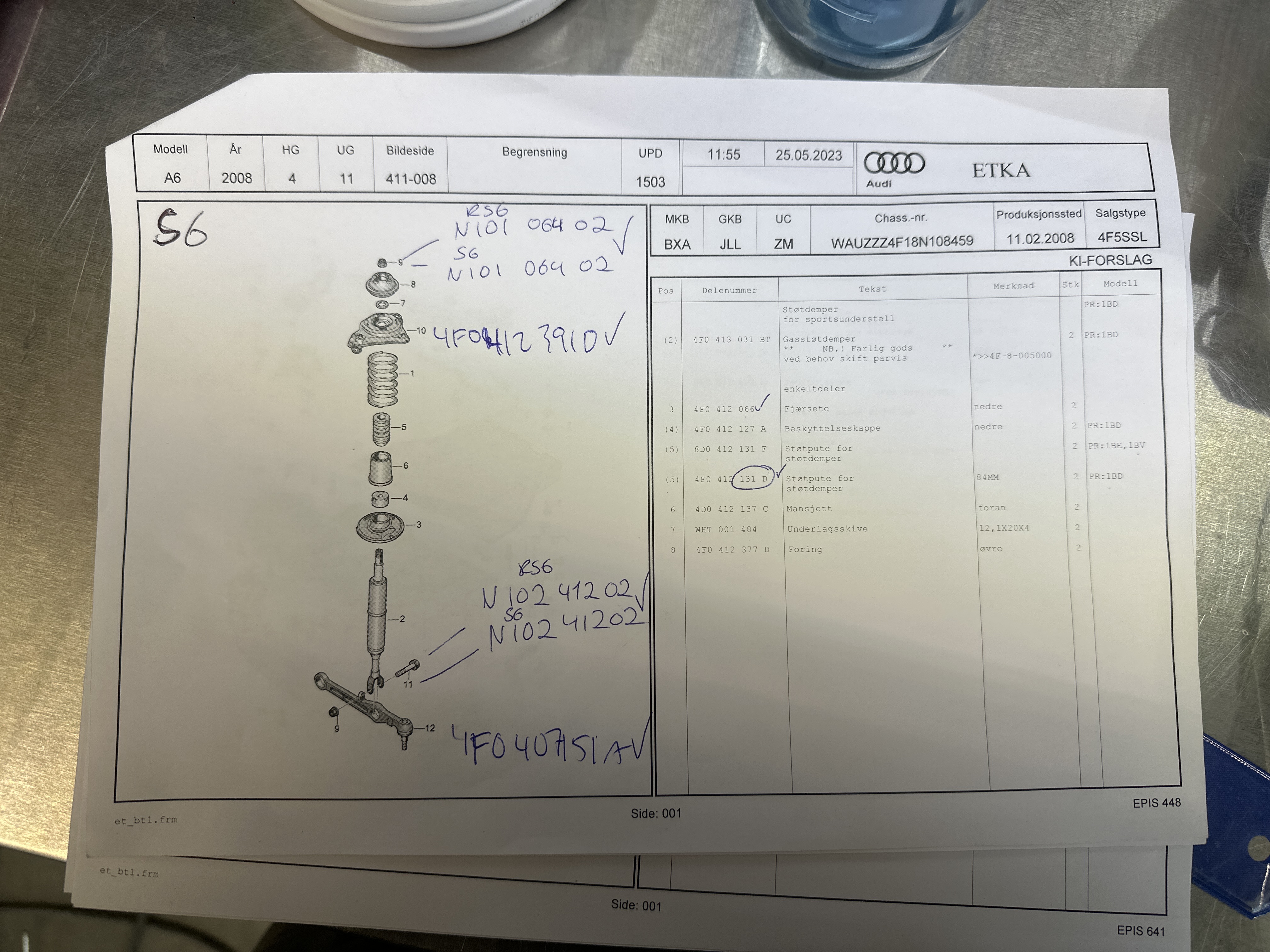

Hello wonderful people! I am a new member on the forum and a proud owner of a c6 rs6 that I just bought.
The car had 188.000km and needs a little love, starting with the suspension. I need new shocks on the front, but these are hella expensive and I cant seem to find any pair that will fit except for OEM from dealer.
I am however trying to find out if the c6 S6 shocks will fit on the rs6? I know they have a different part number, but absoloutley every other part for the struts are the same. The S6 shocks costs 220€ from dealer while the RS6 ones costs 950€.
My questions is, are the S6 shocks compatible in the front/and rear? My RS6 does not have the audi drive select function. And if there is any place online that sells shocks for the RS6, I would be very greatful for a link as I cant seem to find anything.
I am attaching photos from ETKA for both the RS and S model.

No when i press car i get menu with different options like exterior lightning ambient lightning acc etc. The attachment i posted with stated model RS6 is my vin and number 11 is 4F0 412 019 A & 20 A is part number that dealer gets up for my car. 4F0 413 031 BT is part number from a random S6 C6 to compare. All the parts are the same part number except for the shock absorber itself.

I will check them out, just haven’t had the time yet. I have however compared the part numbers for the front suspension of s6 vs rs6, and all the part numbers are identical except for the shock… what is the difference and why is there a difference? Or is it all just fraud. Im attaching photos from ETKA. As you can see in the pdf, I have check marked every matching part number, and the differences in only 1 letter on few, and a couple ones with different part number but same size bolt/nut etc. I find it very strange. Hope we will be able to find out, as S6 parts are much easier to find and a lot cheaper.Jim Haseltine wrote: ↑Fri May 26, 2023 9:57 pmI believe that there are two types of DRC shocks. There are 3-stage used by sports suspension plus (standard fit for UK market) and then there are single stage.

S6 struts are simple traditional Gas Struts whereas the RS6 strut uses a gas strut with an extra section built-in for DRC, the hydraulic system which physically links all the suspension struts together with a pump that moves hydraulic oil between all of the struts so that they can all act on each other to provide additional anti-roll and anti pitch (brake/accel) elements to keep the car "flatter" than just a simple Gas Strut can.
There was an optional extra for the DRC in Europe called DRC Sports Suspension Plus which allows the driver to select from 3 different damping rates for the DRC via the MMI, this is standard fit on UK cars but from the looks of yours (based on your MMI menu) you only have the standard DRC suspension struts.
So, if you fit S6 gas struts then you will lose all of those extra DRC functions and you would need to do extra work to blank off/drain the DRC fluids and connections on the car, plus disable the pump and you may end up with error codes and warning lights on the dash. This would be similar to a C6 RS6 owner fitting KW or Bilstein after-market struts - Yes it would work but it wouldn't handle exactly the same afterwards (most people on this forum who have swapped C6 RS6 suspension go for KW).
Now, if you are driving your car on track or hard around corners on the road, then you'll find the difference between S6 gas struts and RS6 DRC struts to be a negative as you will lose the additional anti-roll/anti-pitch elements that DRC brings vs the simpler gas strut S6 suspension. However if you are only driving fast in a straight-line and then taking it easy on the bends then you'll probably not notice any difference.
Those are the differences between the S6 and RS6 struts, hope that helps.
