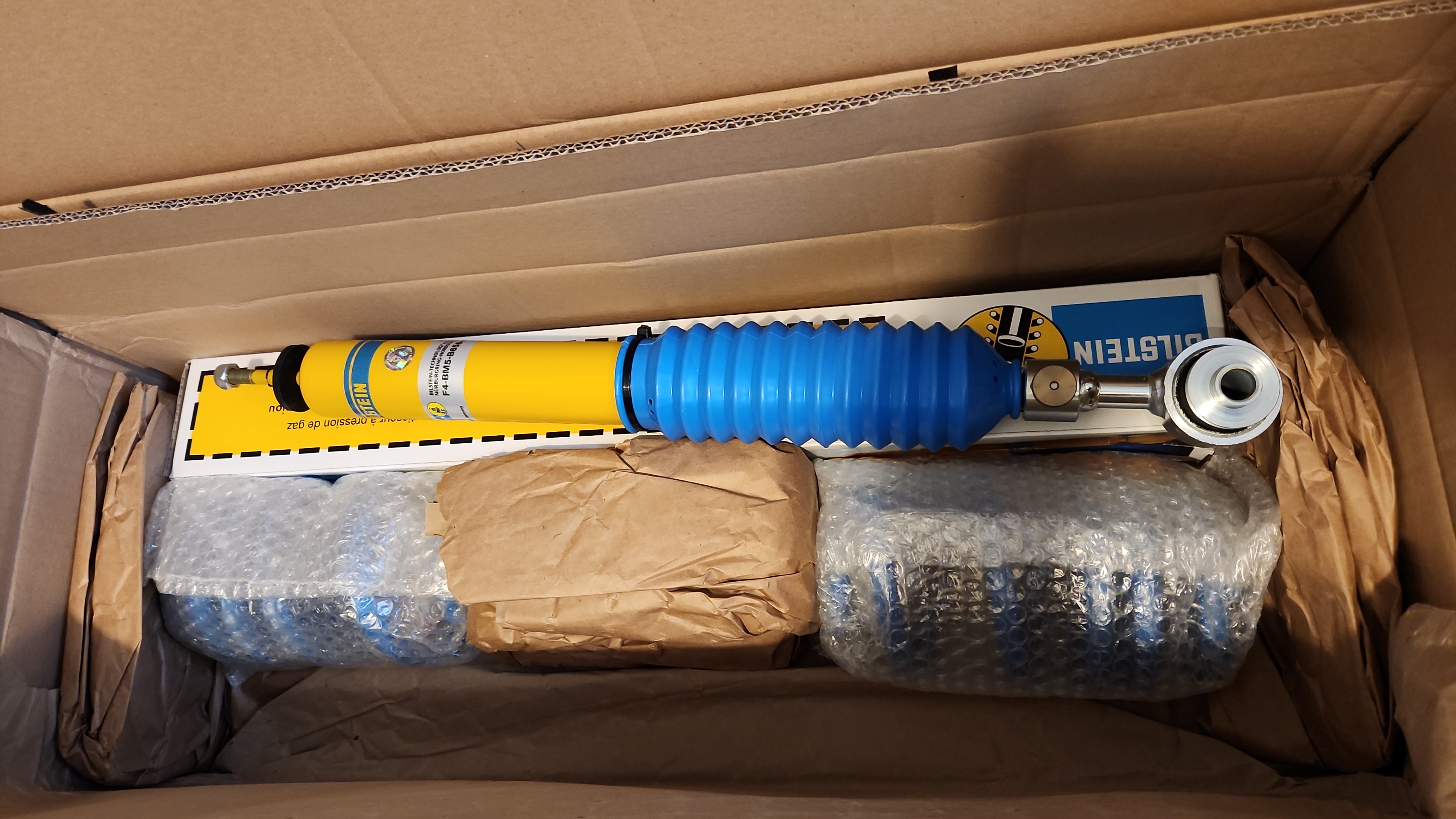

Re: Leaking DRC / Coilovers (Bilsteins/H&R opinions)
Ended up ordering PSS9's as the H&R will take 2 months to arrive
More expensive but at least I'll have damping i guess!
