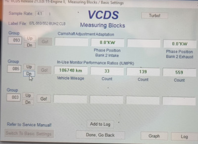

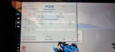

Phuketpaul
Posts: 71
Joined: Tue Aug 18, 2020 1:01 pm
Re: Camshaft chain lengthening, MVB 93 ?
Post by Phuketpaul » Mon Jun 07, 2021 12:15 pm
Hope this is of some use, Car is 2010 and has done 66,000 miles

ruedisrs6
Posts: 41
Joined: Fri Mar 29, 2019 12:16 pm
Location: Hockenheim, Germany
Post by ruedisrs6 » Mon Jun 07, 2021 1:01 pm
This is definitely of use ! Many thanks for it. Seems that your bank 2 is perfect ! And seems that I need to prepare myself for a chain change.
