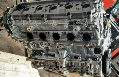

Well, there are lots of pieces to this puzzle, and I just got another one. I thought I'd try to find a scrap RS6 or S6 engine, but it turns out there aren't very many of them.
However I did find an R8 engine, and I've had to find some space in my shockingly cluttered garage.
It's not exactly what I was looking for, but the possibility of having an actual Lambo engine in an RS6 was intriguing. After all, they are the same engine, aren't they?
Nick
Nick

What's your source of information? Here's a picture of the back of the R8 V10 engine:
And here's a picture of the back of the RS6 V10 engine:
EDIT: Notice the R8 has the power steering pump in the bottom left corner, and the aperture for the front diff propshaft in the bottom right corner.
