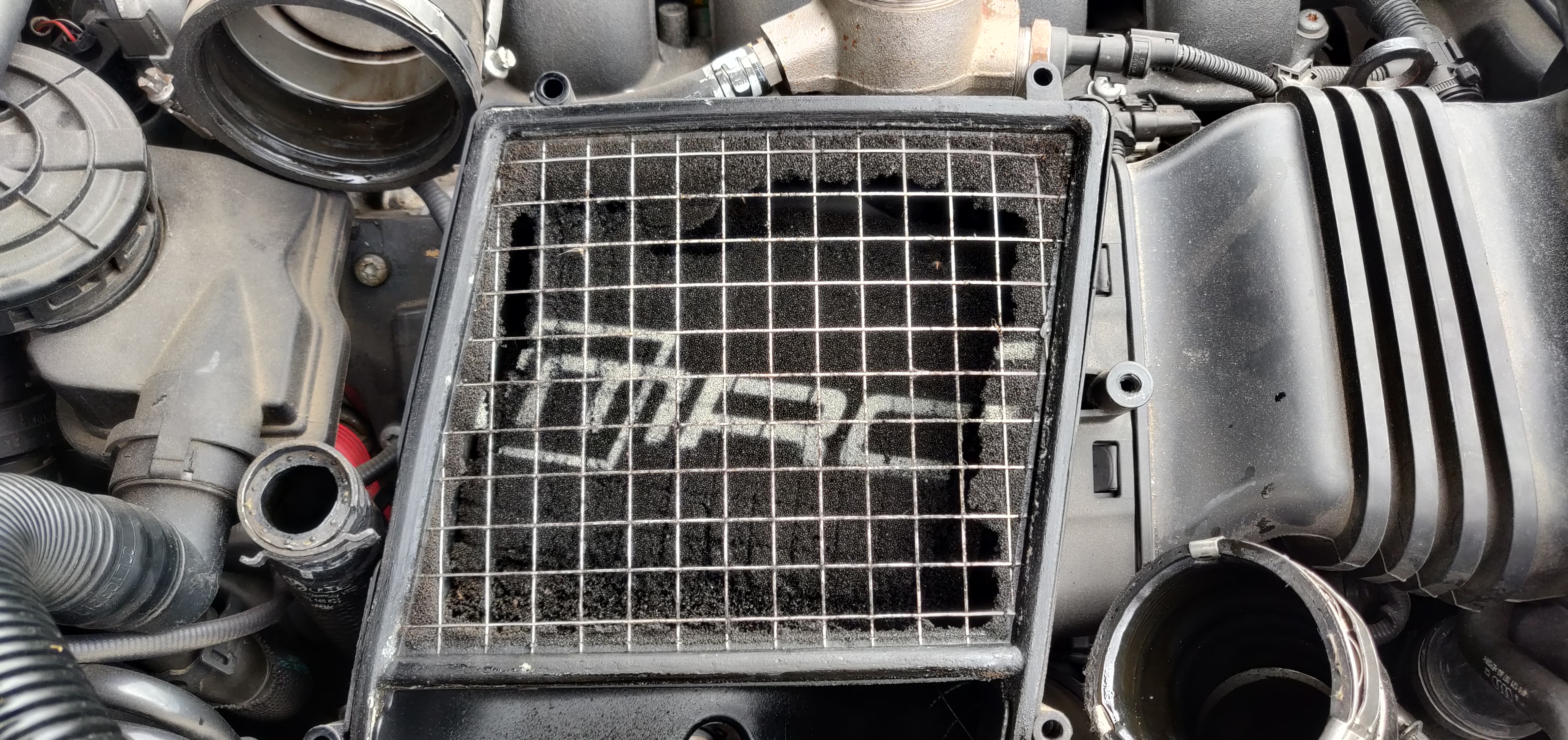

Hi All
Firstly, this isn't a dig at MRC and I'll give the back story. I just wanted to say that if you have their filters, check them regularly.
As per the "interesting development" thread the previous owner of the car didn't do any of the maintenance himself and was unaware that the owner before him took the car to MRC for a stage 2 setup/tune, including air filters. This was 7 years ago. I had seen in the service notes "aftermarket air filters fitted, not replaced" or something along those lines and realised it may be possible that they hadn't even been cleaned in 7 years. I just opened up the air box and found the attached.
Now, I have no idea if these are supposed to be a washable/reusable filter or disposable but either way, if you have them just keep an eye on them, as I have no idea how long these have been going through the intake/engine. Obviously a filter shouldn't be left alone for 7 years but at the same time, this isn't a good failure mode for them. I can only assume these are meant to be disposable.

Re: MRC Air Filter Failure
I'm just hoping it's only happened between the last service and now. I can't imagine a garage would see that and not tell the owner.
Are the MRC filters foam rather than gauze?
Yup, based on appearance and description, I believe they are a rebranded version of these:
https://www.eurocarparts.com/search/909 ... KBEALw_wcB
These do state they are washable and "can be used over and over again". So I'm surprised to see both disintegrate in the same way.
MRC ditched these years ago for BMC, for this very reason. They recommended everyone to swap them out as soon as this was brought to their attention.
Okay cool, glad to hear they aren't still selling them.
