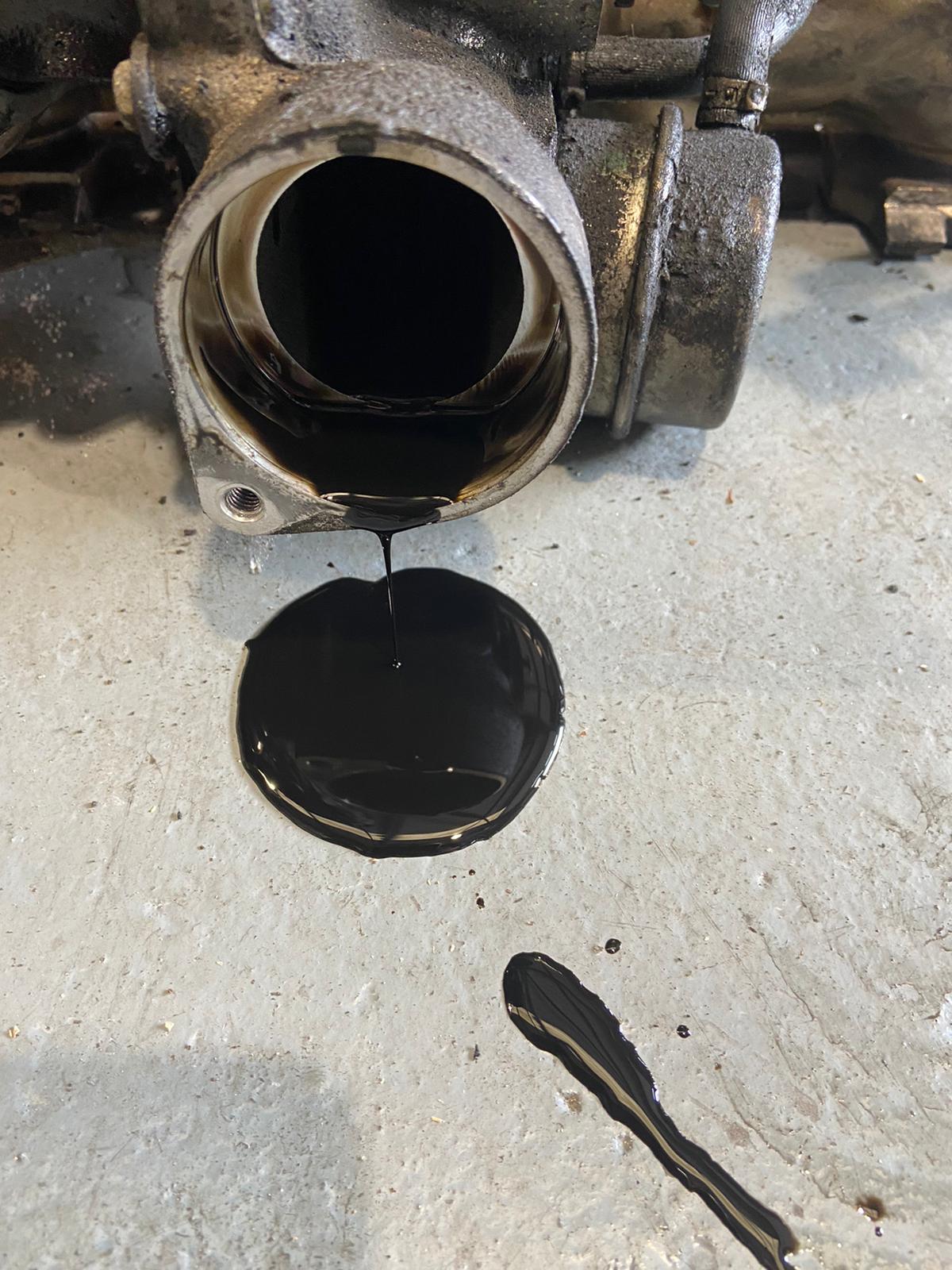

Post by ShazRS6 » Thu May 14, 2020 2:17 am
Right hand side turbo is leaking bad

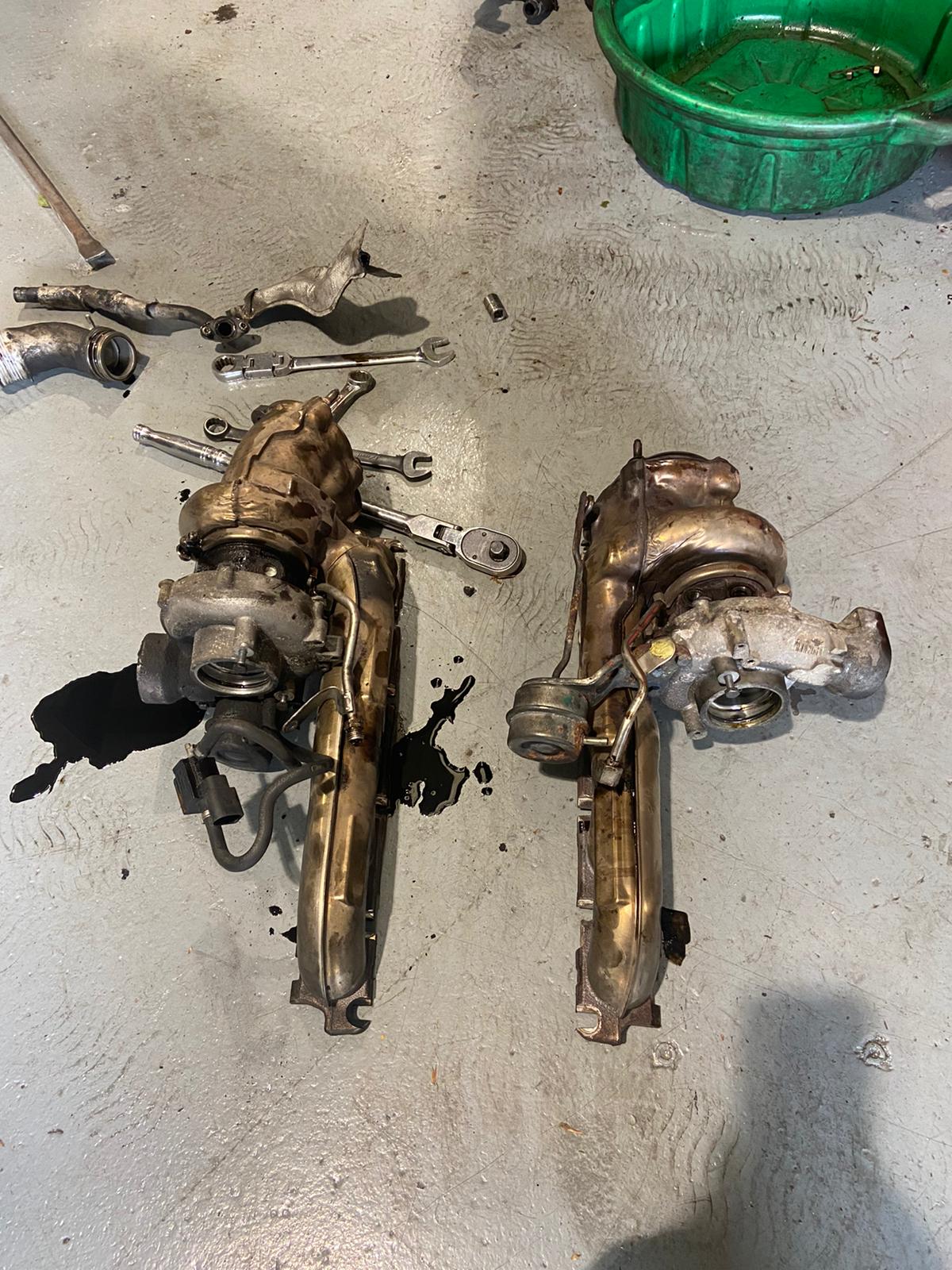

Post by welwynnick » Thu May 14, 2020 9:19 pm
It certainly is! Was the engine removed to get them out?
Biturbos don't usually fail together, but If one of the turbos has gone, the other is probably close behind.
Nick

Post by ShazRS6 » Fri May 15, 2020 7:57 pm
Nick
Yep engine out job
Rocker cover gaskets are weeping a bit
So will get them changed
Also had a very tiny coolant leak which also will be getting sorted
Then off to the lads @hardknockspeedshop to get the 3” system made
