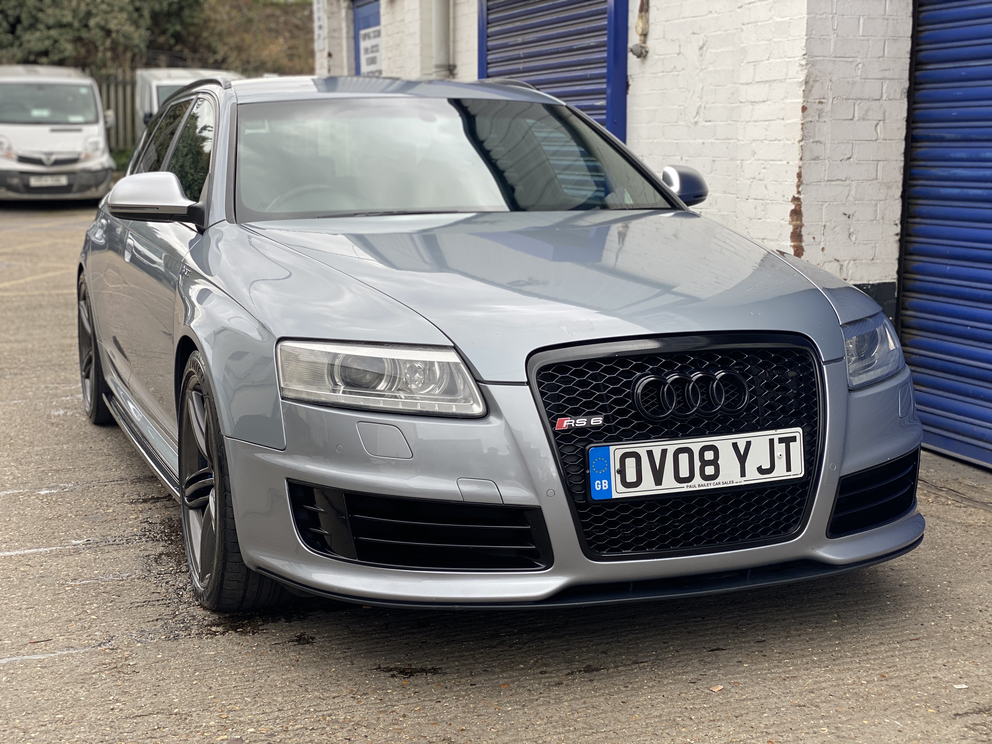

Here’s a pic
New C6 owner

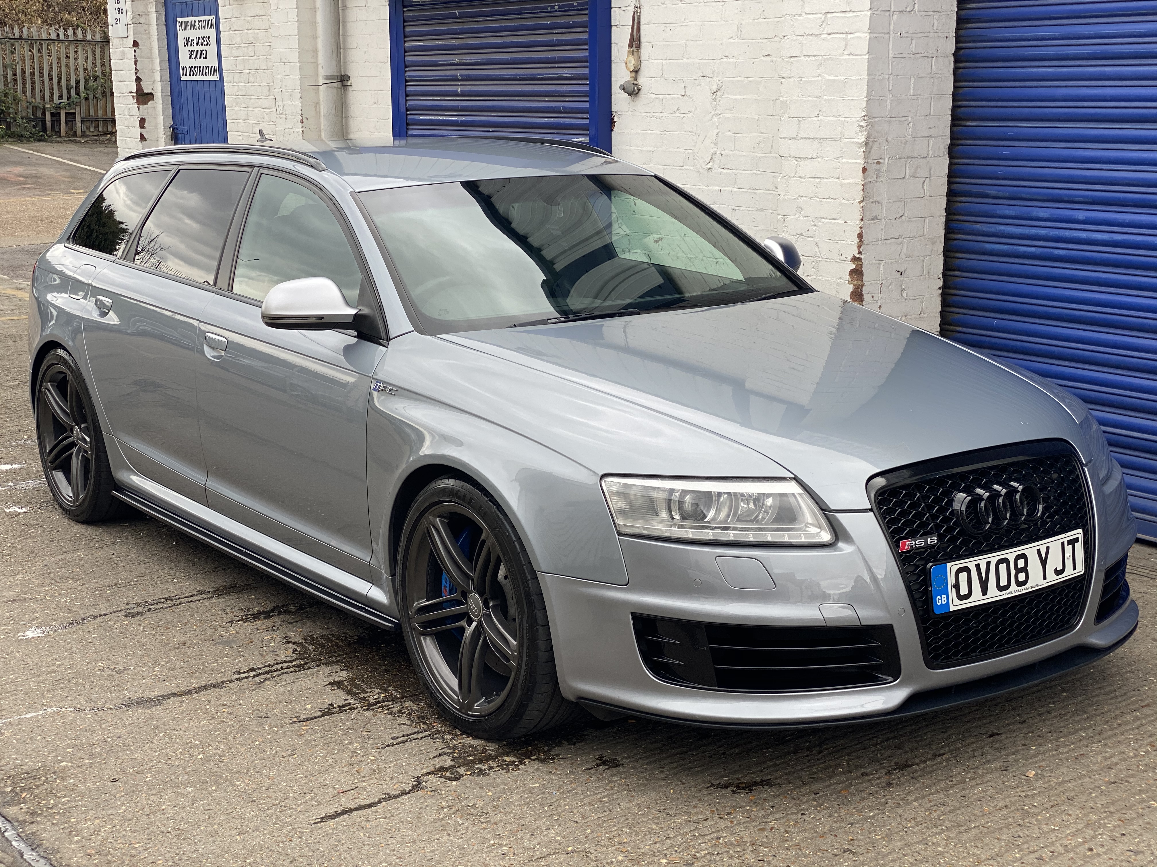

Also when I first saw it thought it was like a moon dust silver colour
When we went to view it it’s actually light blue
Very very nice colour
Going to be taking the front lip spoiler off as I don’t like it and there’s some film type <beep> on the headlights and rear lights which will be coming off ASAP

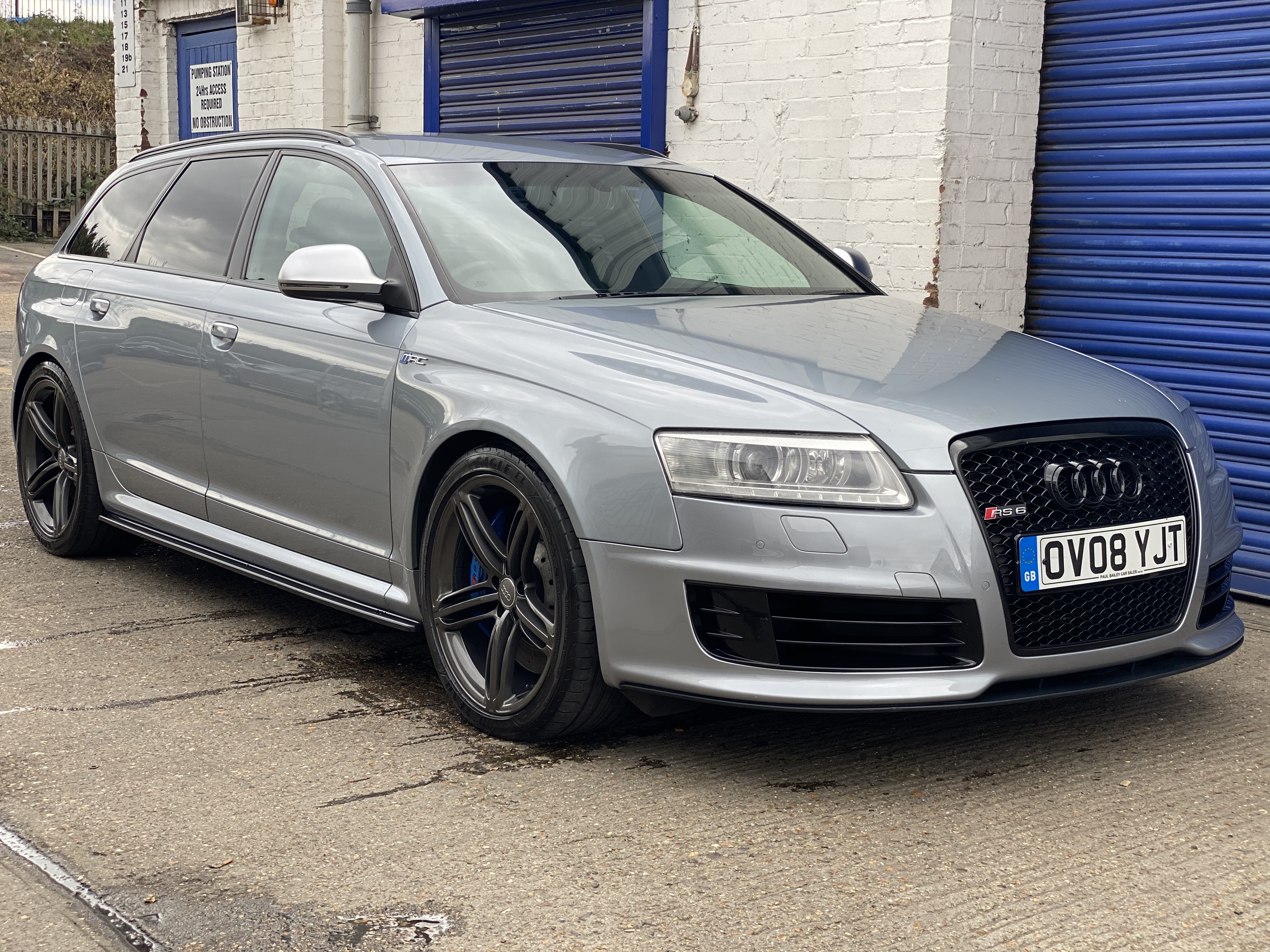

Gave it a good clean today
Took the horrid headlight and back light film off
And the front splitter
Few issues whilst on the ramp
Rear shock is leaking
And so is the front passenger side one
So going the coilovers Route now
How do I get rid of the DRC?
Is there a kit you can buy?
Also both inner lights on tailgate need to be changed
And drivers rear led lights are not working
