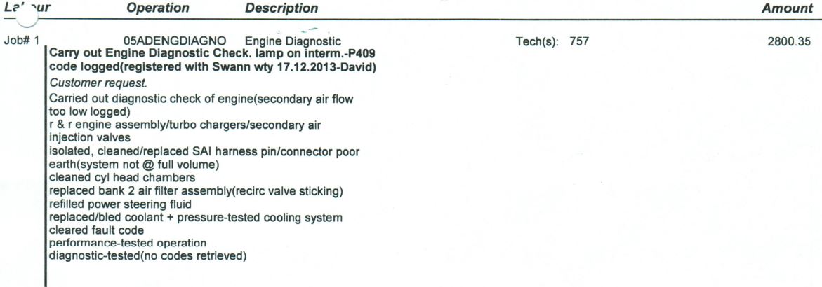

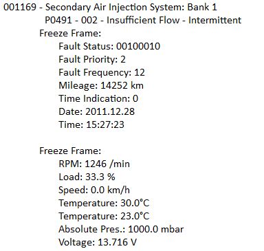

I had same SAI code- see pic 1.
Under warranty, engine pulled for SAI replacement, along with clean up of electrical connectors.- see pic 2.
From trolling Audizine, poor electrical connections are a significant cause of error codes.
After the warranty repair, Audi Diagnostic did not show any further error codes.
Strangely , the beast is running a lot stronger since the warranty work. Cant see why as SAI does not influence turbos/boost etc (?). Maybe some of the other "clean up " work listed improved performance?
