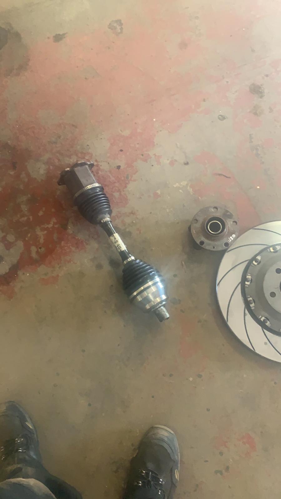

Just to update the thread, went with the suggestions of replacing the CV Joints. Garage couldn't unbolt the CV Joints from the
drive'S though, so I had to order a new set of drives. Surprisingly they arrived from Audi within 48hrs.
Garaged fitted the new drives yesterday, reversed it out and "clunk". The plan now is to replace to the wheel bearings next, the
saga continues..
