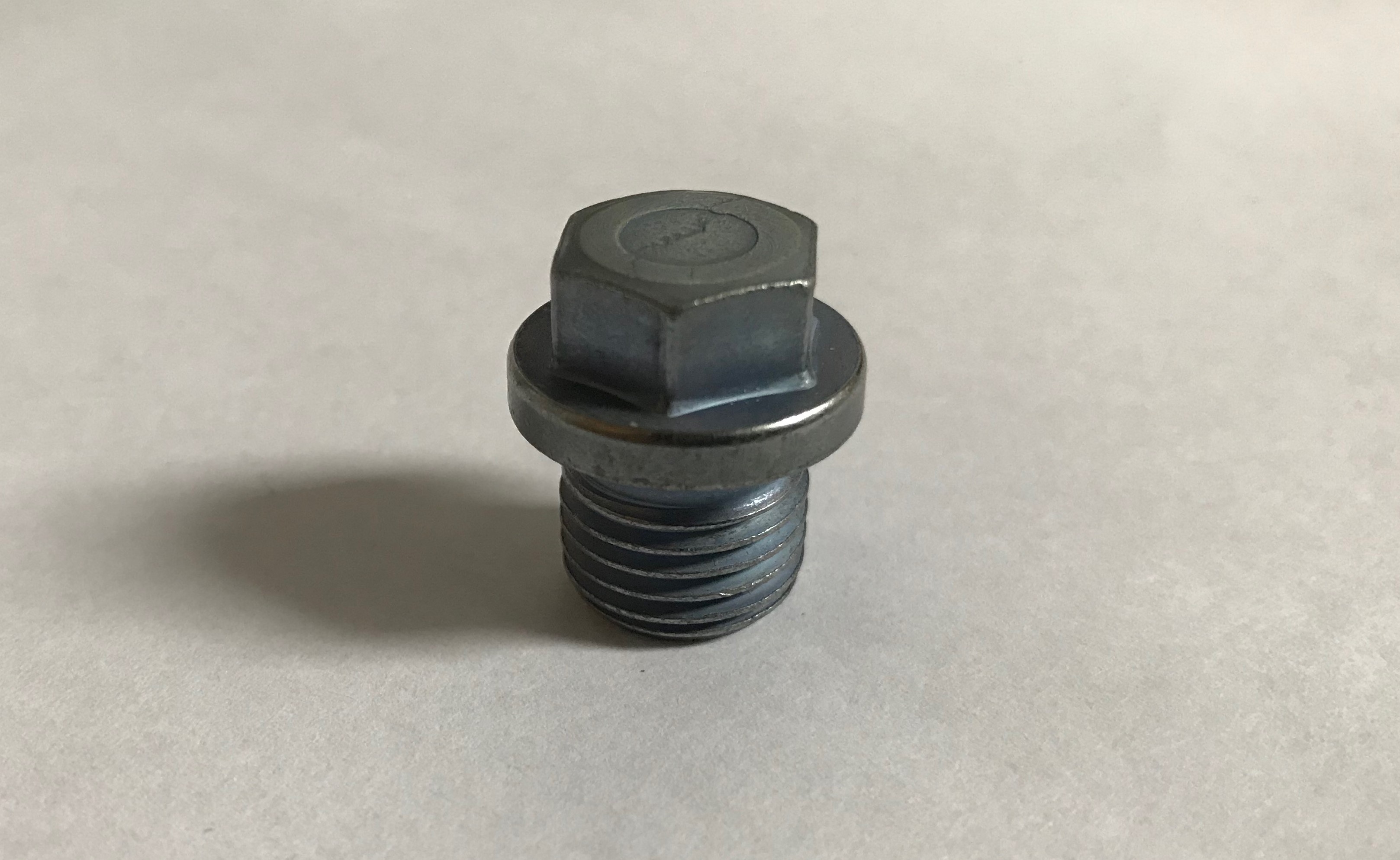

Here is a picture of the sealing plug that was (and still is) on my engine oil thermostat;
It is made from an aluminium alloy and is very light. The dimensions of it are M14x1.5x19 and it is 18mm across the flats. It also has the option to use a triple square socket (I can't remember the size) to loosen/fasten it.
The part that ETKA lists as being the correct part is made from steel. The dimensions for it are M14x1.5x22 and it is 19mm across the flats. There is no triple square or similar hole on the head that can be used to loosen/fasten it. Here is a picture of it below;
Has anyone else come across the sealing plug that my car is fitted with at the moment, or is part number N 908 132 02 the correct part? The reason why I didn't change it was mainly because of the difference in length of the two plugs - 19mm vs 22mm. I know it's only 3mm, but I don't want to restrict the oil flow just in case ETKA is listing the incorrect part and that it should actually be 19mm.

The part - 036 103 193 - is the same part that was fitted from factory, at least, to both Jim's car and my car. The new one I got is shown below;

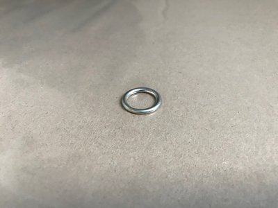

The seal ring I bought - N 013 815 7 - is not flat - instead it is cylindrical, like a doughnut. It is shown below;
It is not the correct part in this instance and I will not be using it along side 036 103 193 on the engine oil thermostat.

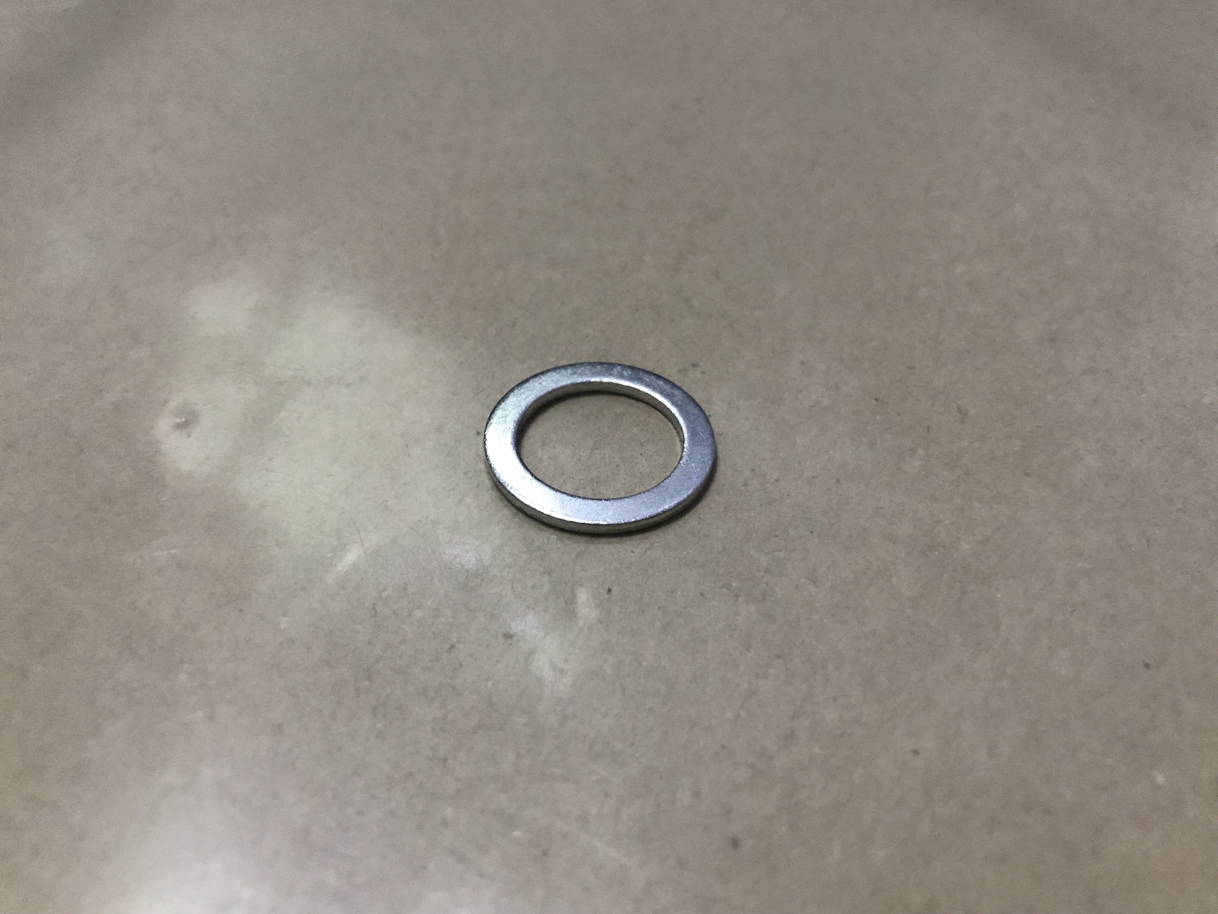

I believe that the correct seal ring for this use is, as I suspected, N 013 849 3, which is a flat aluminium sealing washer. It is shown below;
