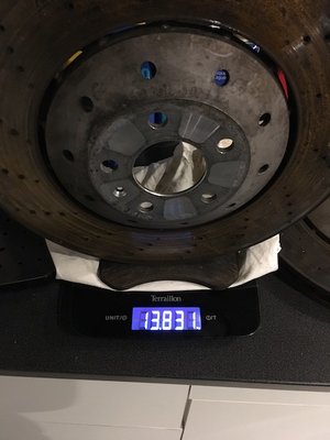

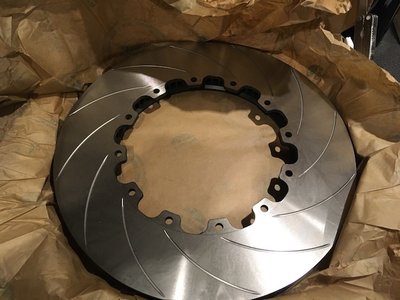

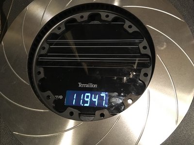

IanH755, I don't know where you took information but let me show you the real weight:
Ap racing :
OEM double sens:
8kg :shock:
the difference is only 618gr per side : so almost 5% less...which is better than nothing.

I weighed mine on my works scales (I only had small kitchen scales at home) and I got the AP's at 12Kg and OEM at 16.5Kg so I think the wildly wrong 8kg per disc came from adding both sides, however neither figures are the same as what you've got which is confusing me.
Could you try standing the discs upright rather than laid down incase there's a difference (thats how I did it)? The reason I ask is that ,if you lift both, do you think both weigh virtually the same, as per the scale results, as I felt the AP disc setup with the hat included still felt lighter than the OEM.
I also know myself and TomRS have weighed our 410mmx36mm discs and both got 13.5kg, so I can't imagine 390mm discs only being 300g lighter than 410mm discs?

I will try your solution, no pb:

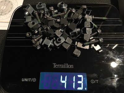

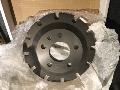

I also has the different parts separately:

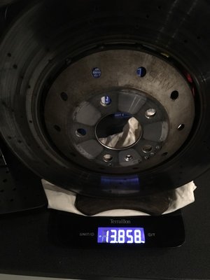

Discs were not that bad,
I double checked the weight:

Wireliner - Thanks for the update, looks like my work scales are wrong then but it's good to get confirmation on the correct weights, thanks.
