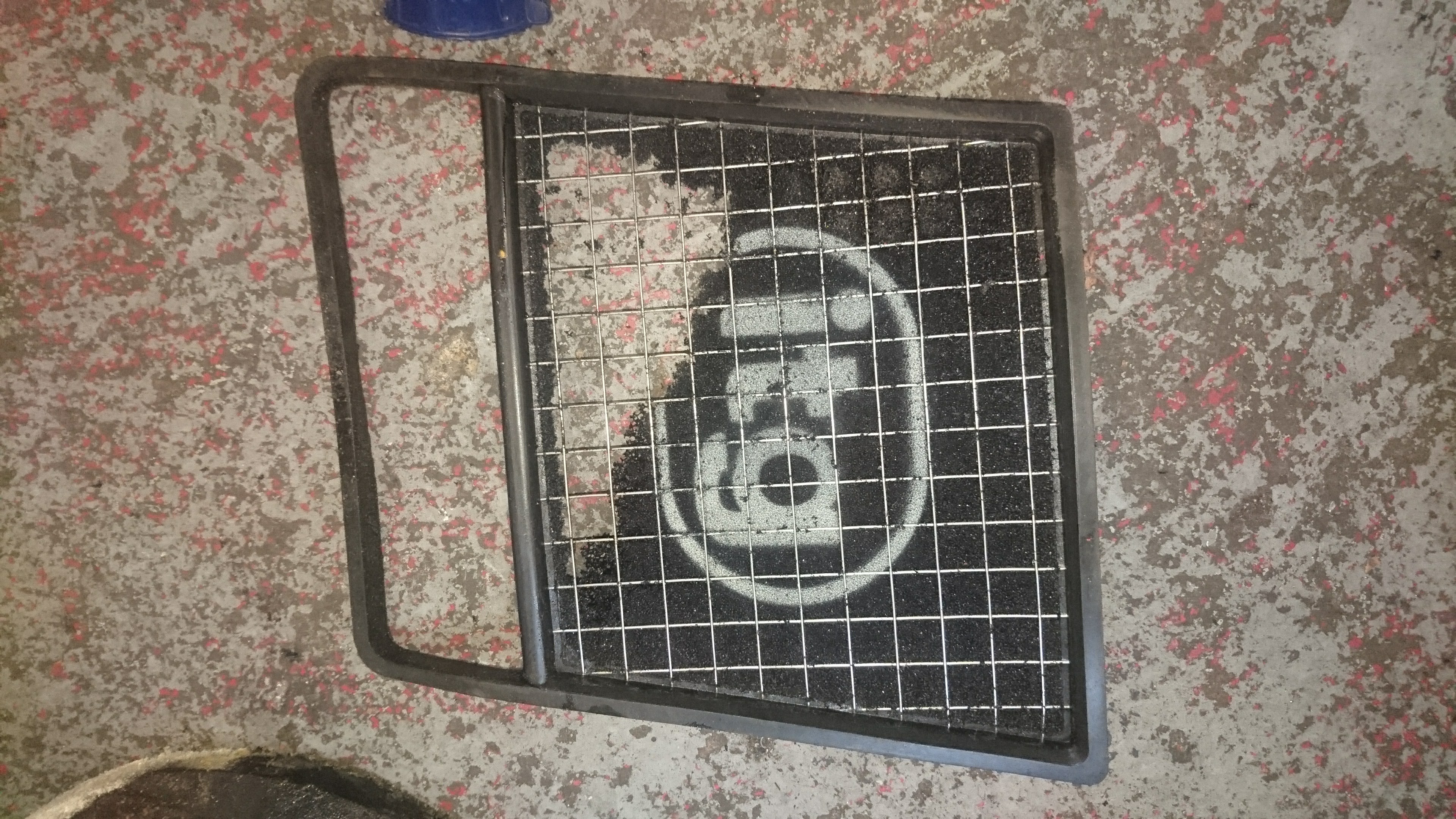

Just carried out a full service and it would appear that one of my ITG filters decided it wanted to let the engine go all pac-man on its ass and start consuming foam filter (see piccy) They were fitted October 2015, had no issues over the past year or so however went 720bhp courtesy of MRC back in March time so wondering if the increased airflow and my general driving habits are not quite compatible with the ITG filter? or I just got a bad one, who knows, either way, lesson learnt on periodic checking of air filters but also a heads up if anyone else has ITG filters!

It's a known issue with ITG filters, as they get older as the engine heat can eventually make them brittle - viewtopic.php?f=47&t=122549#p820905 - MRC have now switched to BMC filters according a reply in my link too.

mine were destroyed as well when i changed them. They arent as well made as the BMC ones, so all the intake pressure on them eats them alive.

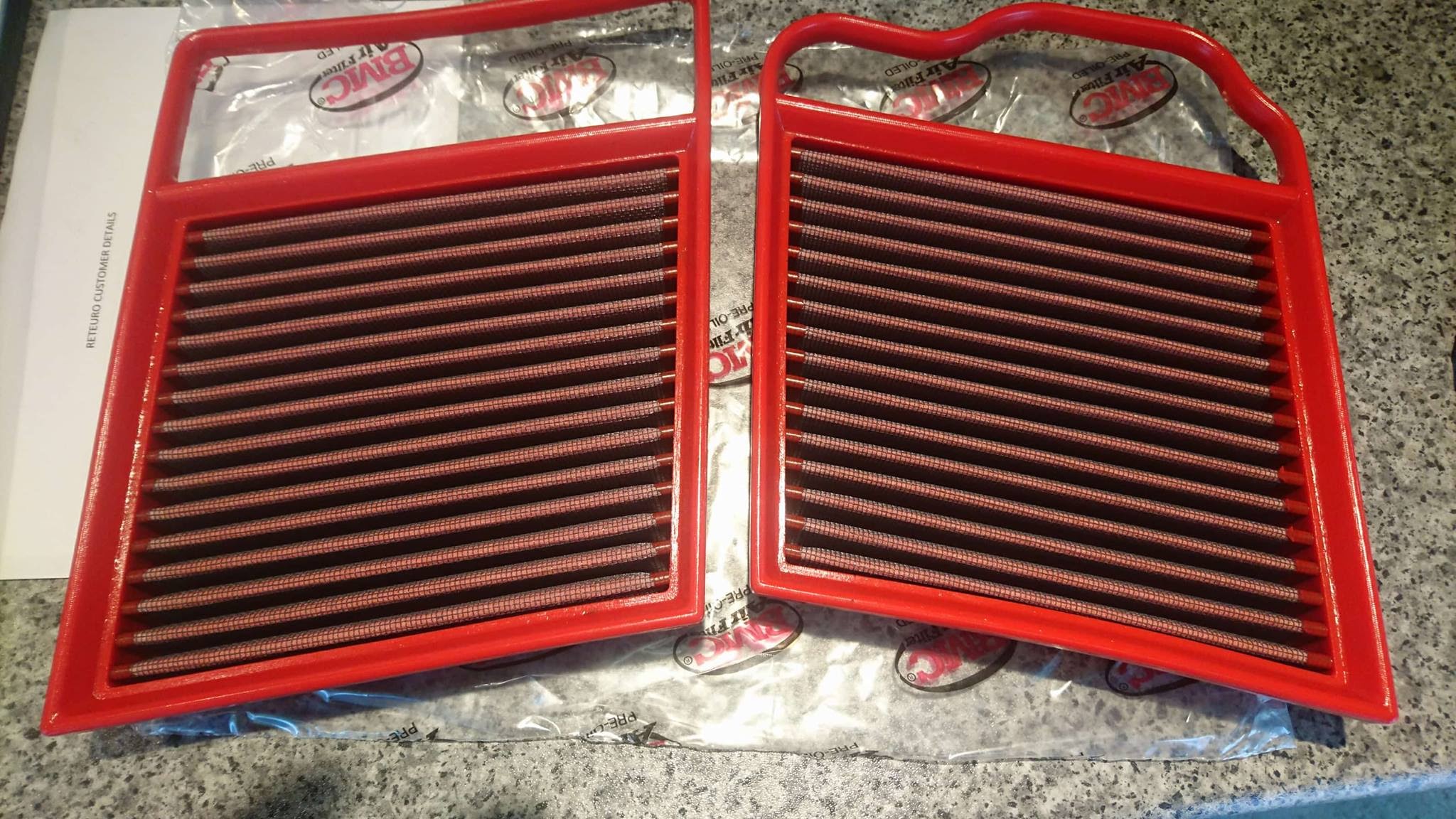

well, really happy with the BMC filters, unsure whether its placebo but things feel much more progressive in terms of power delivery now, plus the BMC filters are red which has kicked off a bit of thought about colour coding the engine bay up, get some red boost hoses on etc.

they were checked and cleaned at the last service and were ok, just a case of it is what it is and move on to something else. The BMC have a lifetime warranty providing cleaning routines are adhered to but the construction alone is worlds apart from the ITG filter despite both brands being roughly the same price.
