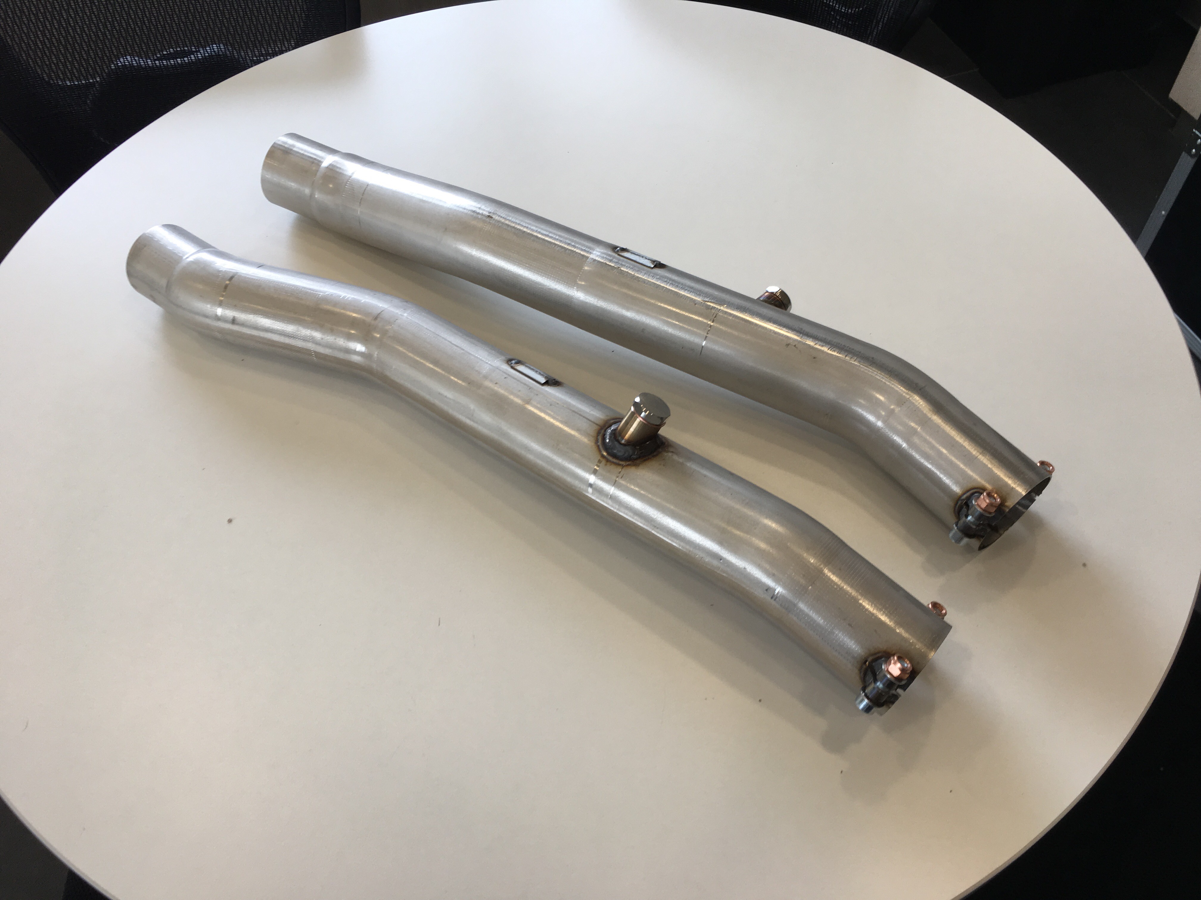

Progress on acquisition of parts progressing slowly...
Secondary CAT Replacement Pipes from Supersprint...

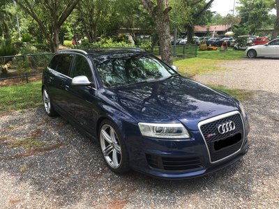

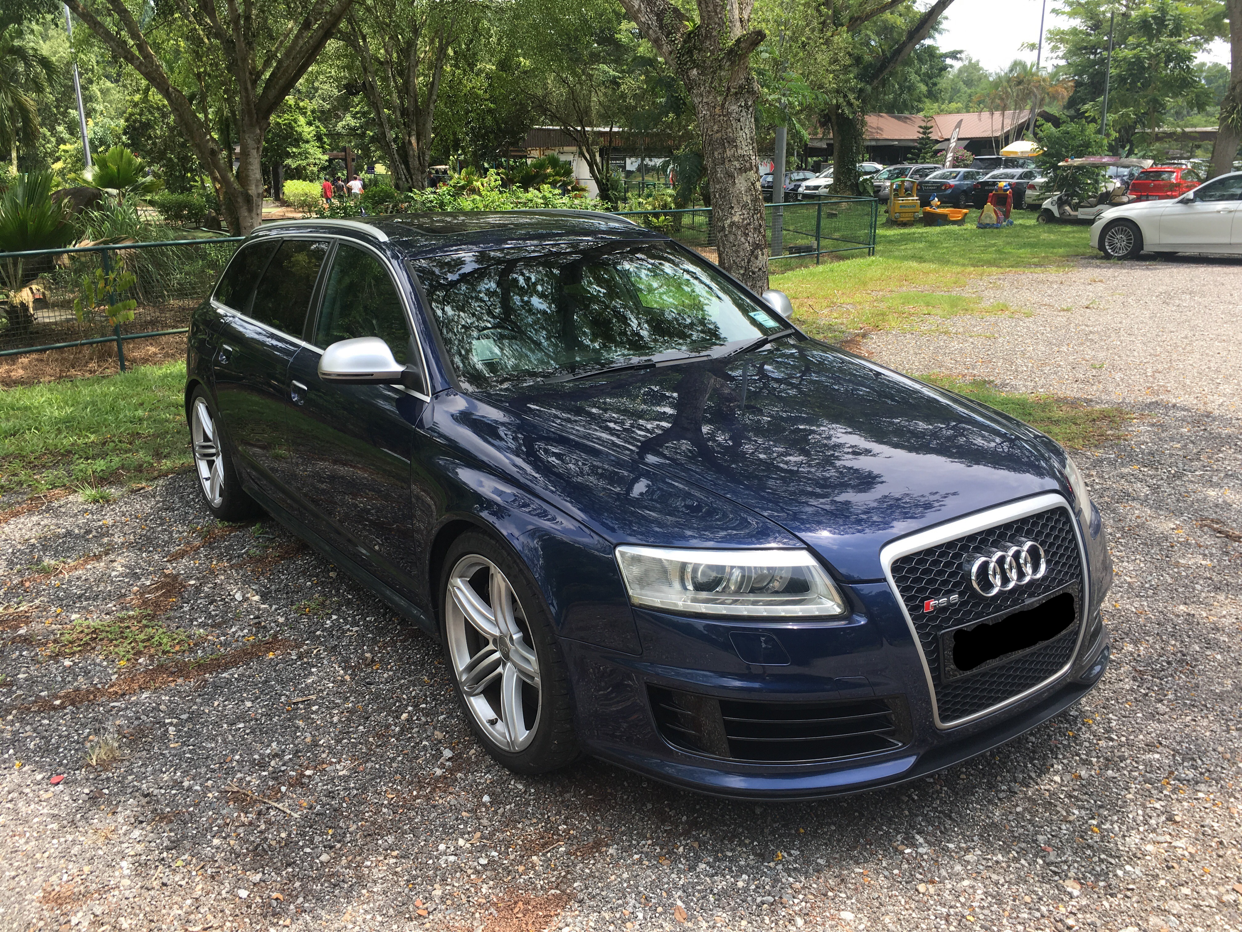

And a quick snap of the actual car... in accordance with FON rules...
