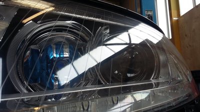

At the time I got my local guy to refinish the headlights while they were off the car once Trups had done his magic, the before image isn't great but they still look good today;

Whats the problem with the Lamps PJ?

Trups, the lens is in an awful state and strangely looks like there’s some discolouration on the inside. If the lens can be replaced, result!

I can supply brand new lens, Clean the insides down, I can also do a few mods inside to get the headlights performing 20 times better than what they do as the projectors in them are not great. Before I would put a new projector in the fog light housing, now I can also change out the OEM projector fully to have a better one in there if you wanted the untouched look,
If any of the chrome has peeled from moisture inside then there is no saving that I'm afraid, I have seen it before.
I would need the headlights sent into to me for the work to be carried out or the car can be left and I can do a drive in/ drive out service.
