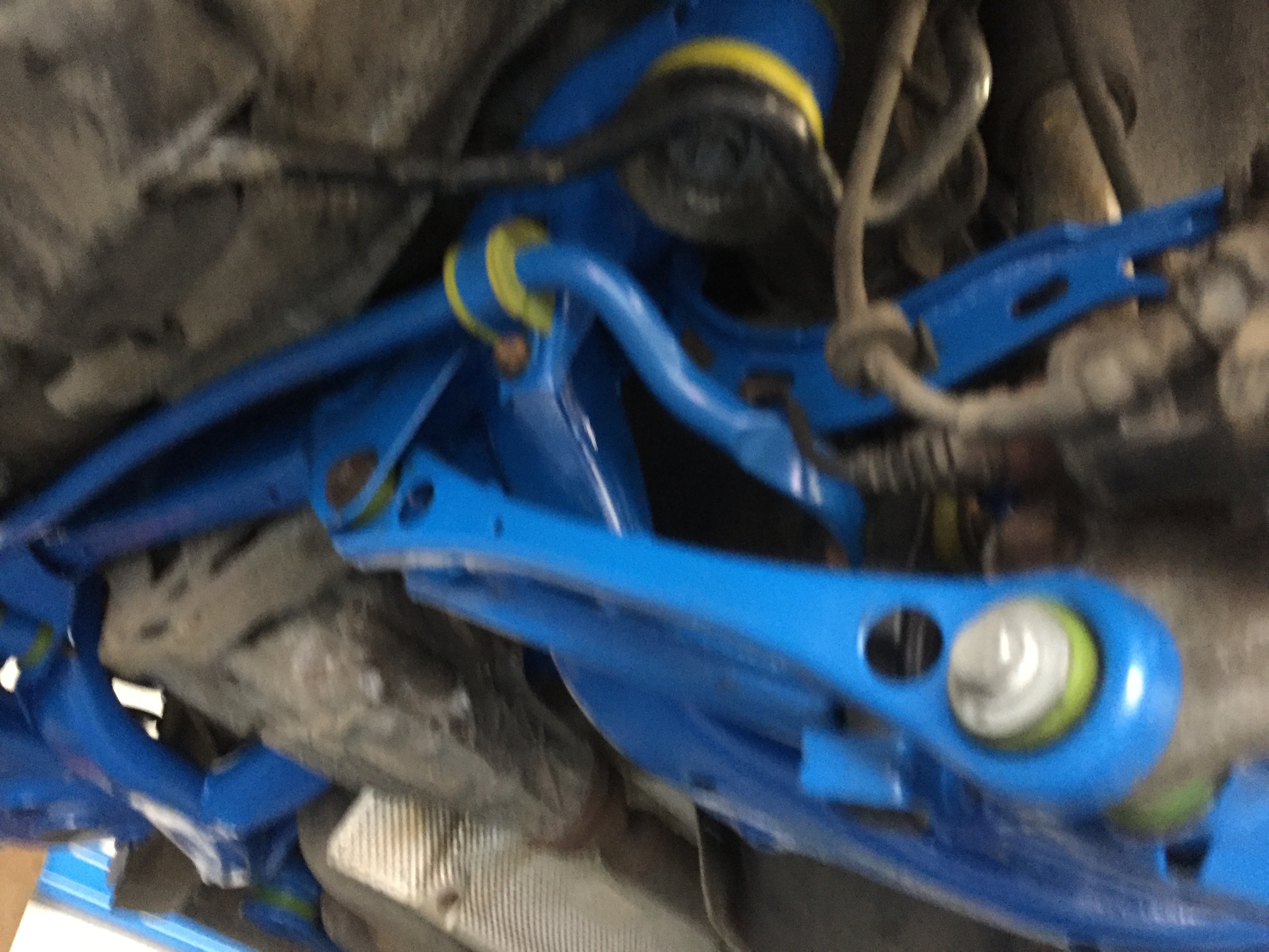

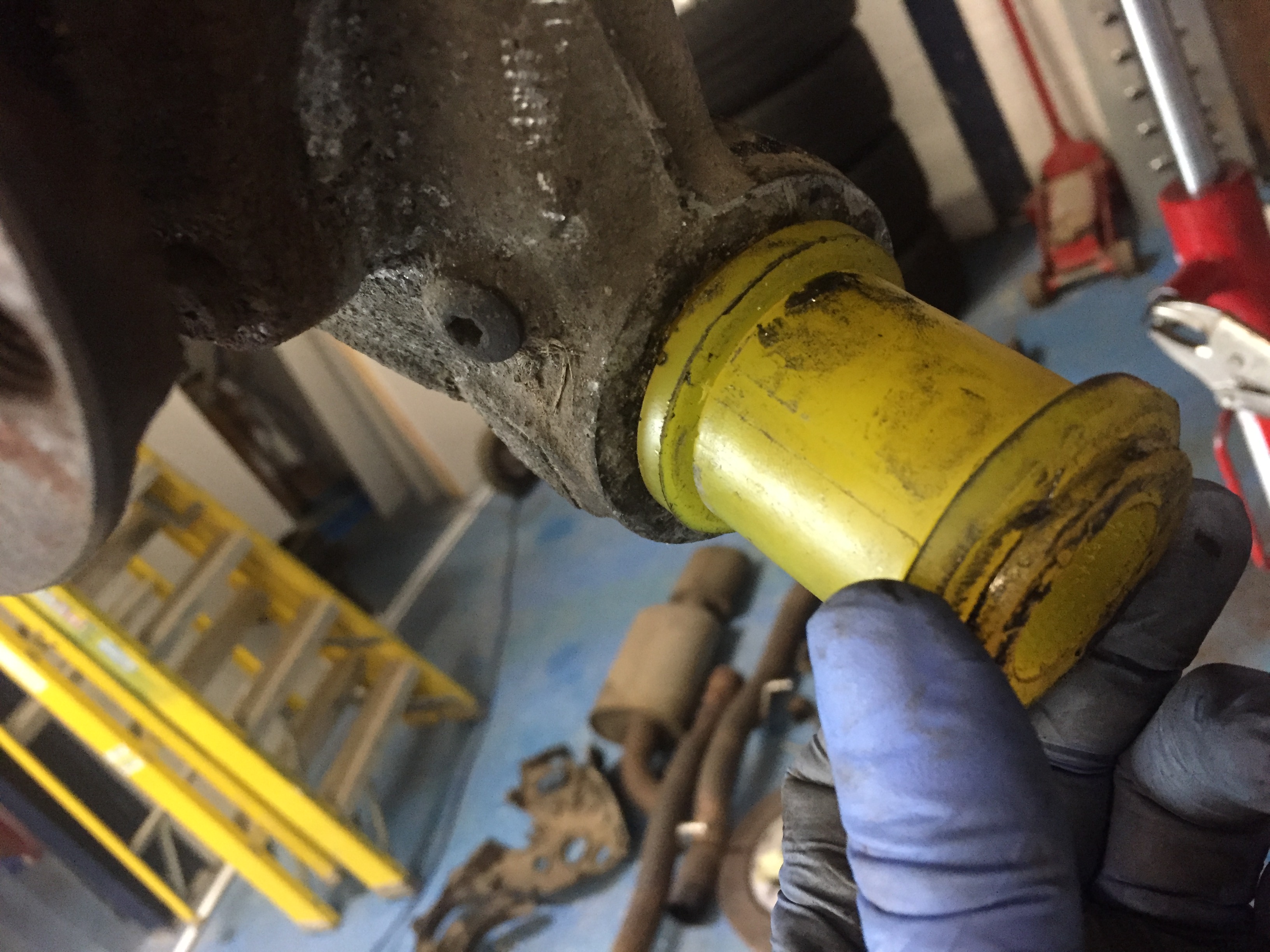

some advice - anyone have a trick' to get the rear bottom bush into place??

A cleaned up hole with lots of lube usually gets me into the bottom bush :D
BamBam style jokes aside, if the hole is cleaned up and lubed slightly would a C-clamp have enough force/torque to press the bush?

A decent quality screw drive hose clip to compress the end of bush often helps. And as mentioned, lubrication.

yep - lots of soapy water - start at and angle then 'flip it in' worked.... now to get the rest of it all back together

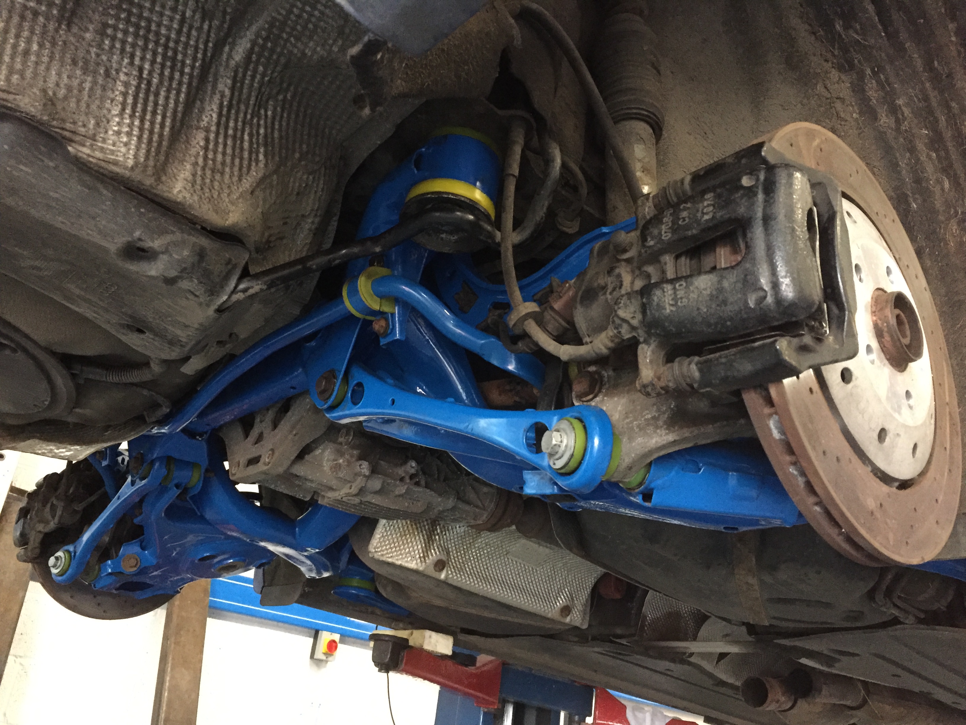

moving fwd - rear end assembled - now a break as i'm off sailing (Fastnet race), before sorting front

I'm really sorry but to me that combination of colours makes it look like you've fitted a kit from the Early Learning Centre.

the ELC suspension is now complete
- having the alignment checked. but car feels much more taught.
DIY fitting is not for the faint hearted but IMHO a definite improvement over the rubber bushes
