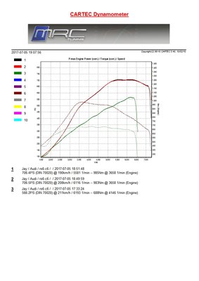

It was inevitable.
MRC magic worked again.
706hp/985Nm with 2nd cats still in place.
