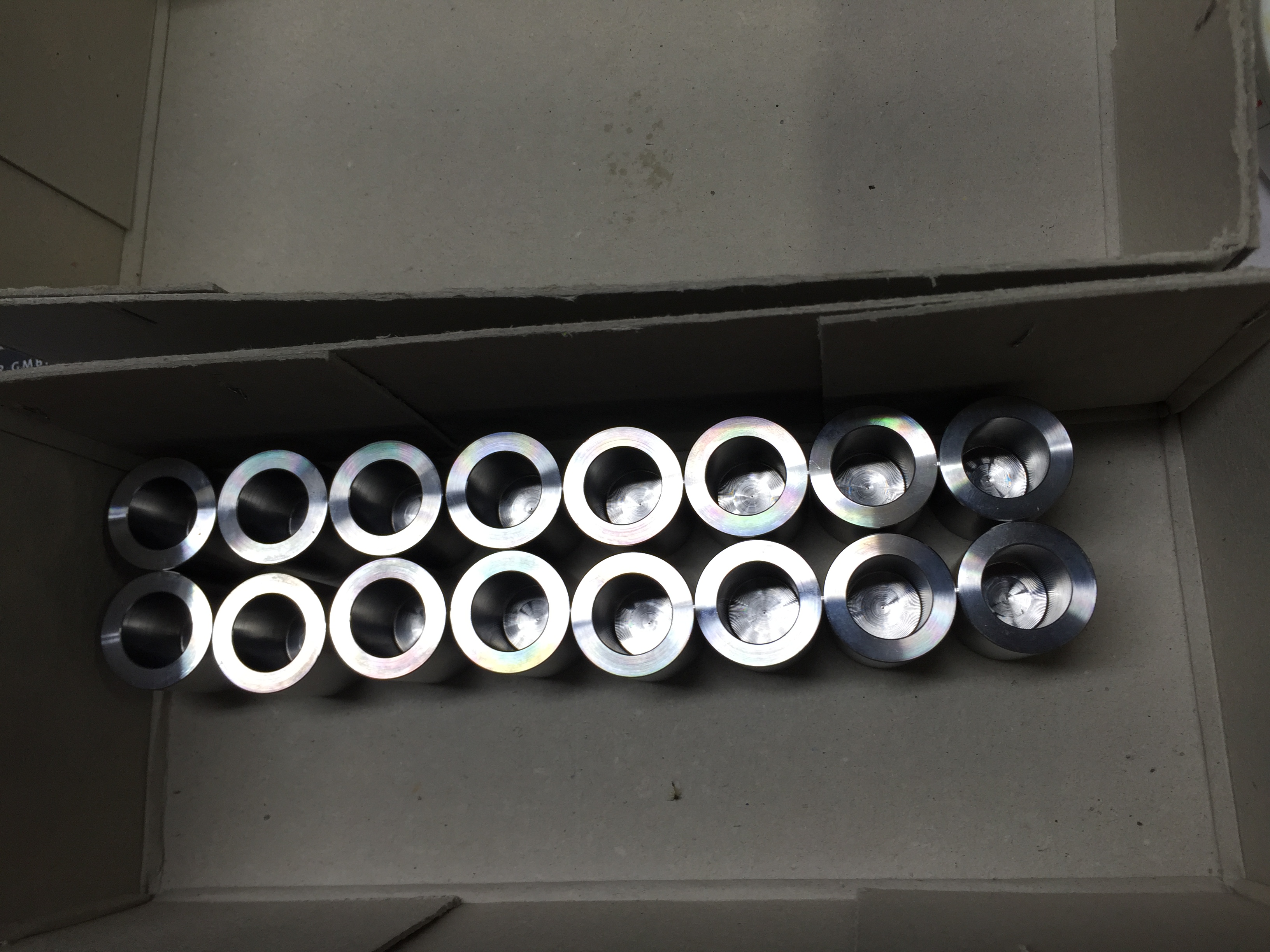

I had mine replaced with stainless steel ones.
They are cnc made and fit perfectly.
Works perfect even on track for one year now.
If somebody is interested I might be able to help you out.
PM me for details.

Common problem with the design of the caliper, the pistons will seize up with age.
Ive got a new set of genuine pistons from Alcon if anyone wants them - not available from Audi.
Very easy to rebuild.
