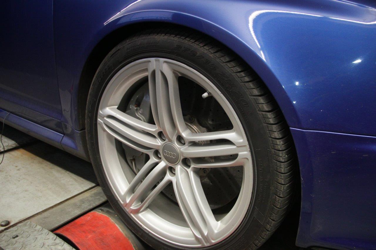

We weren't really looking but a customer traded this in and he kindly managed to get it off audi and sell to us.
Stage1 mapped straight away - so that's all stock without high flow filters - the health check turned into a map.
Rollbars next, to get rid of a bit of roll and bit more feel at the front.

Sepang with Ceramics - great combo. :D

Wow what a find! Originally fitted ceramics or retro fitted? Not that it really matters i suppose! Great car. I am interested in what anti-roll bars you are looking into Doug too.

originally fitted ceramics, the sepang and black piano trim made me buy it - all the spec that I wanted.
I've not even driven it on the road full throttle yet.

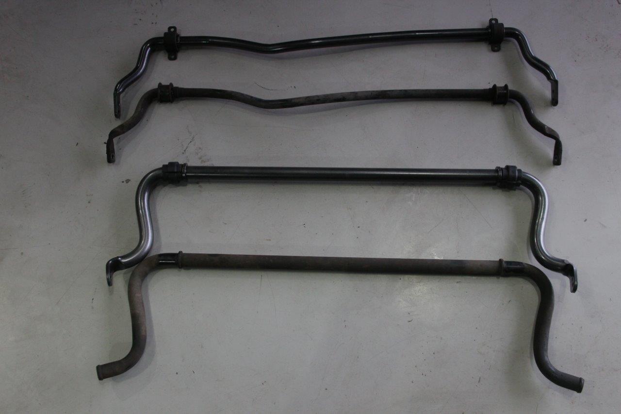

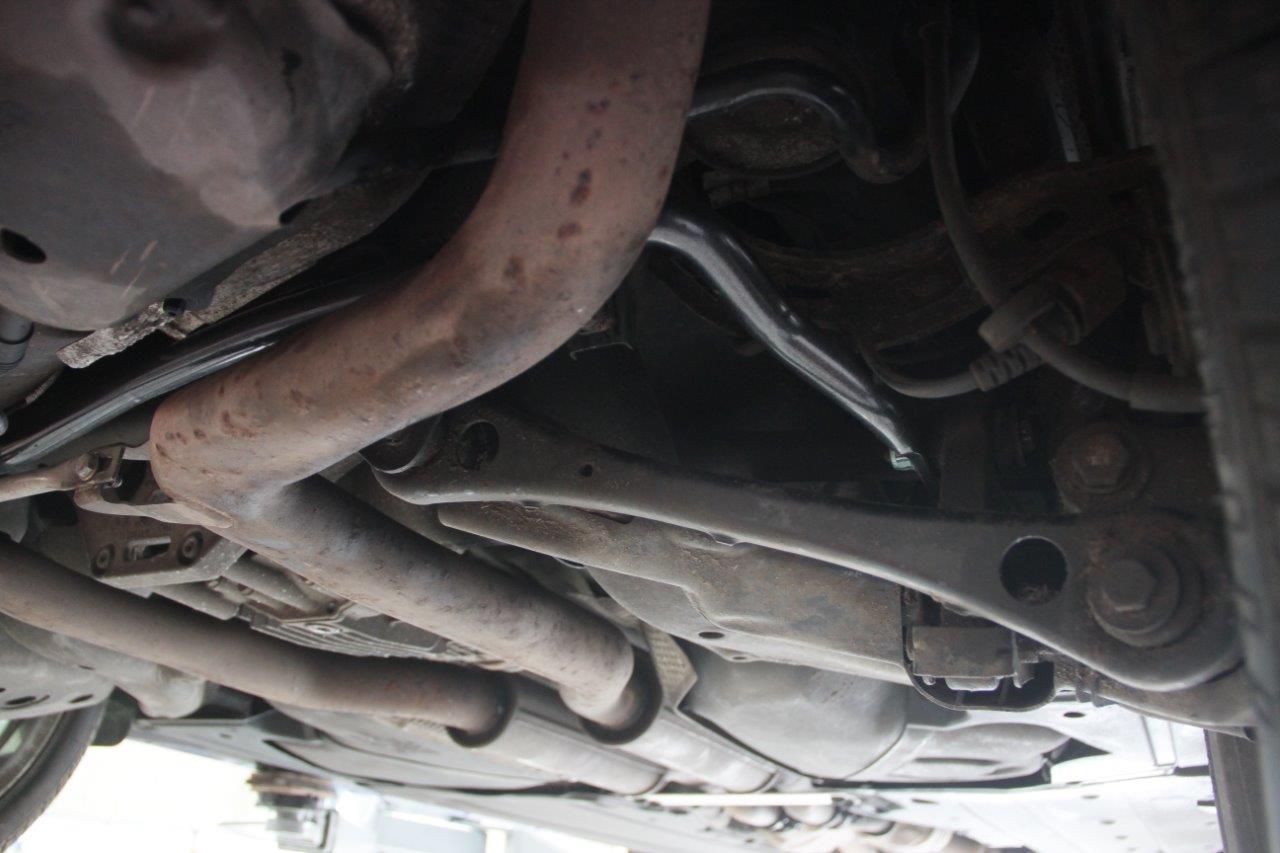

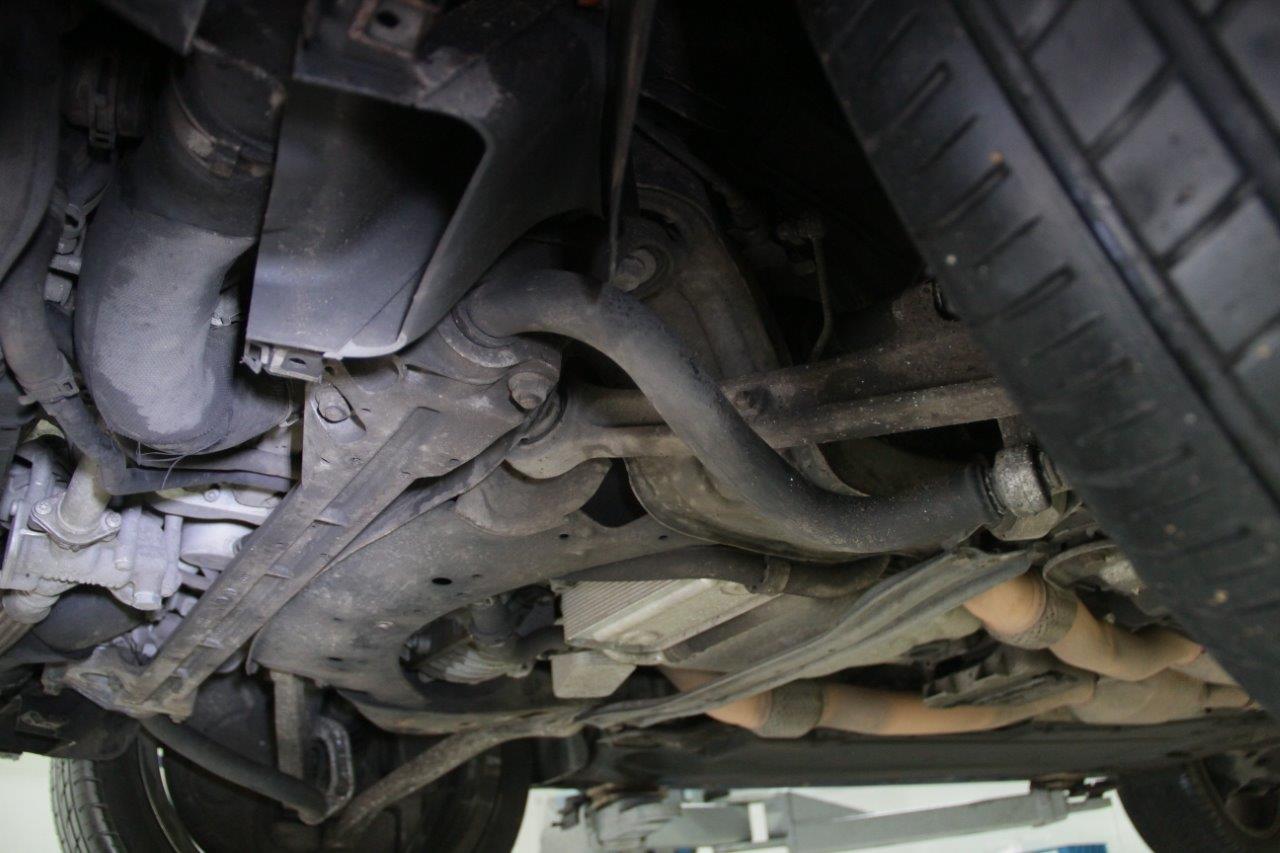

Anti Roll Bars fitted and it does make a difference - more stable in straight line at speed and big difference going around a roundabout coming off - when you get all the weight transfer.
Stock front ones are definitely hollow so light and not very stiff.
Front Stock roll bar is 31mm and 3.5kg
H&R Roll bar is 32mm but solid and 9.3kg
Rear Roll bar is 22mm and 3.8kg
H&R Roll Bar is 26mm and 5.2kg
