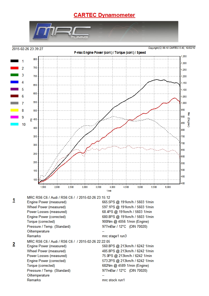

We weren't really looking but a customer traded this in and he kindly managed to get it off audi and sell to us.
Stage1 mapped straight away - so that's all stock without high flow filters - the health check turned into a map.

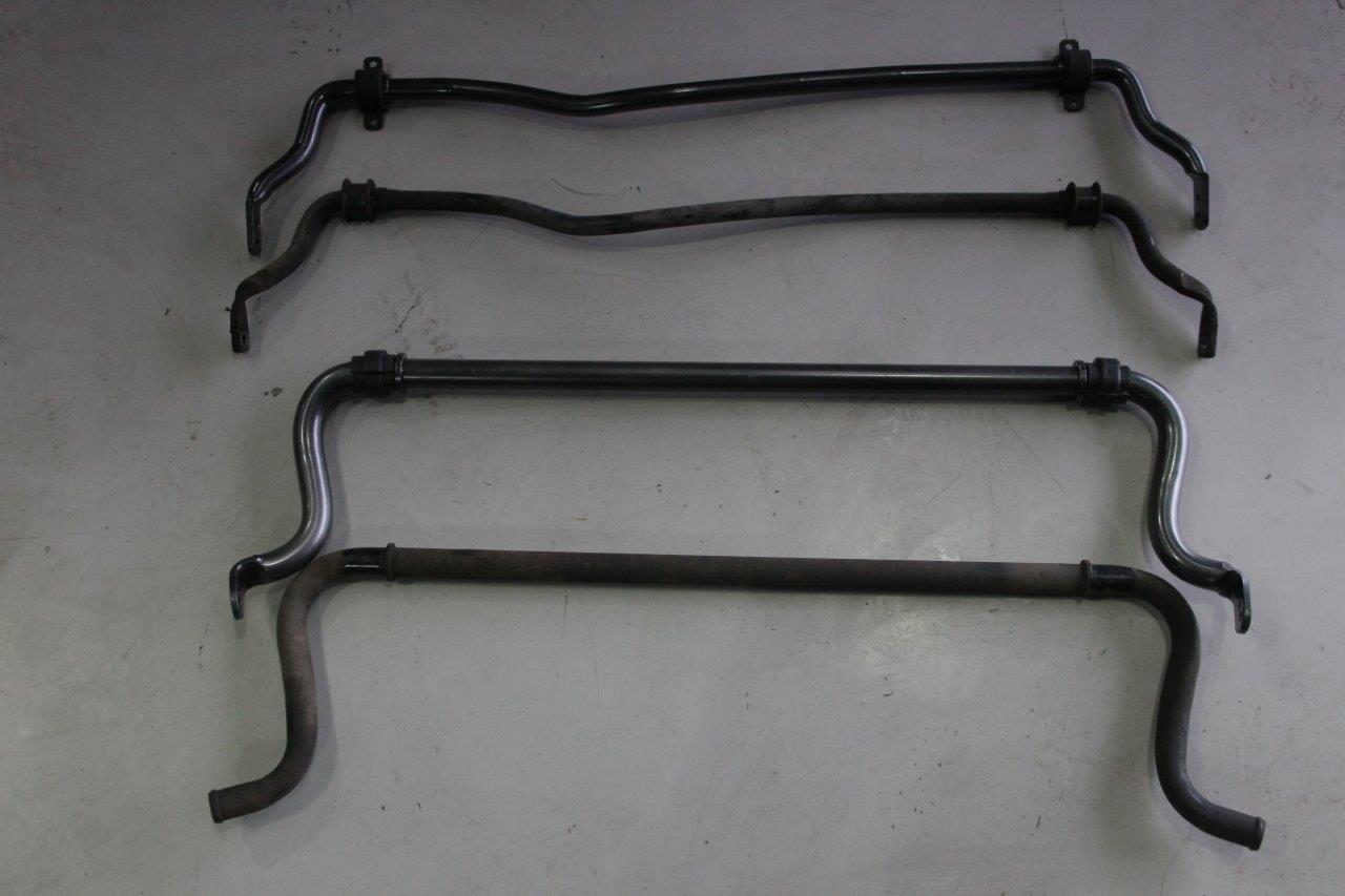

Rollbars next, to get rid of a bit of roll and bit more feel at the front.

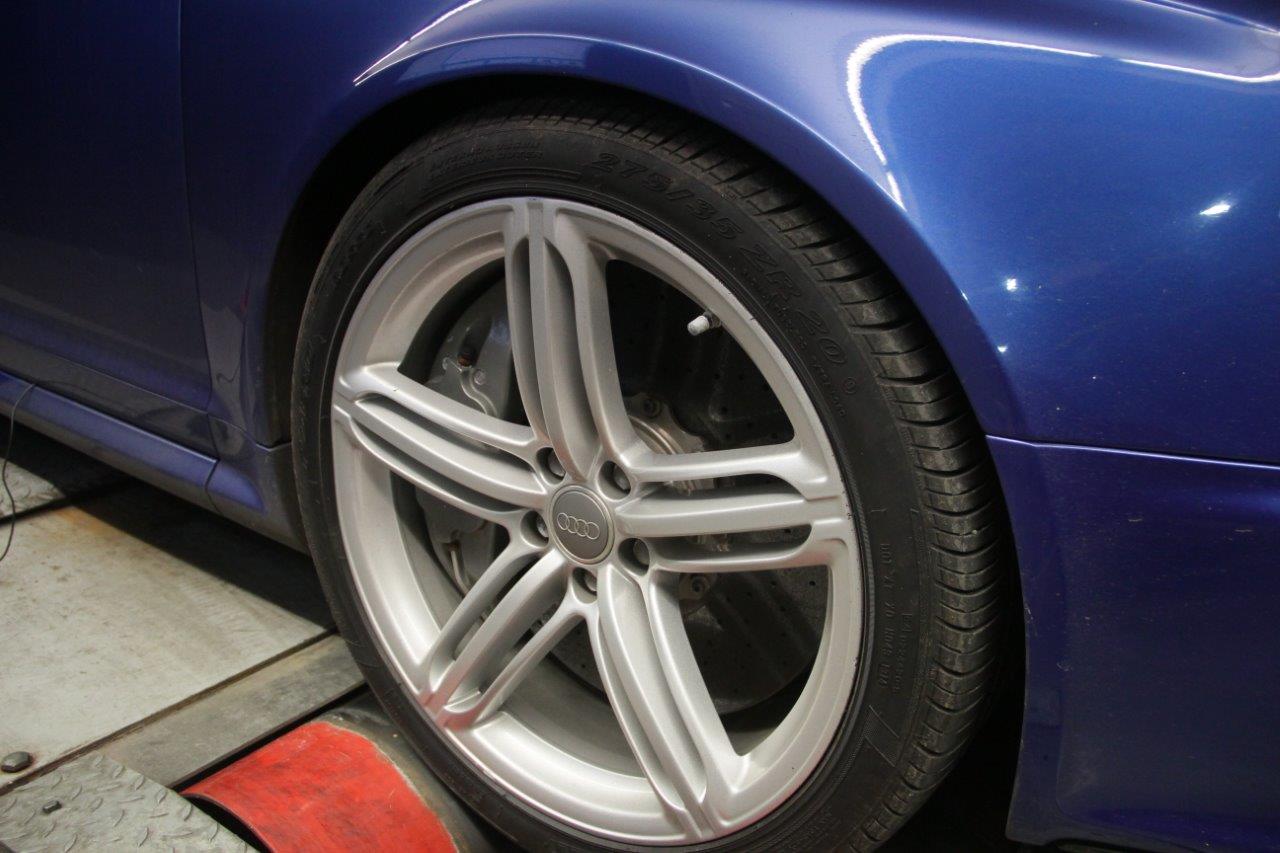

originally fitted ceramics, the sepang and black piano trim made me buy it - all the spec that I wanted.

Looks an awesome find! Quick question - I test drove an RS6 yesterday and the breaks seemed spongy and not very responsive. Any ideas? Are all RS6 C6 plus ceramic brakes?
Thanks in advance.
Dave
Doug_S2
Trader (Expired)
Posts: 1756
Joined: Mon Sep 20, 2004 5:57 pm
Location: Banbury
Re: Finally got one
Post by Doug_S2 » Sat Feb 28, 2015 5:48 pm
Ceramics all round can feel, maybe not spongy, but not as sharp as they should. I would change pads and fluid and bed in then see if the same - if the car has never been driven hard the pads glaze badly and don't bite.

Anti Roll Bars fitted and it does make a difference - more stable in straight line at speed and big difference going around a roundabout coming off - when you get all the weight transfer.
Stock front ones are definitely hollow so light and not very stiff.
Front Stock roll bar is 31mm and 3.5kg
H&R Roll bar is 32mm but solid and 9.3kg
Rear Roll bar is 22mm and 3.8kg
H&R Roll Bar is 26mm and 5.2kg
