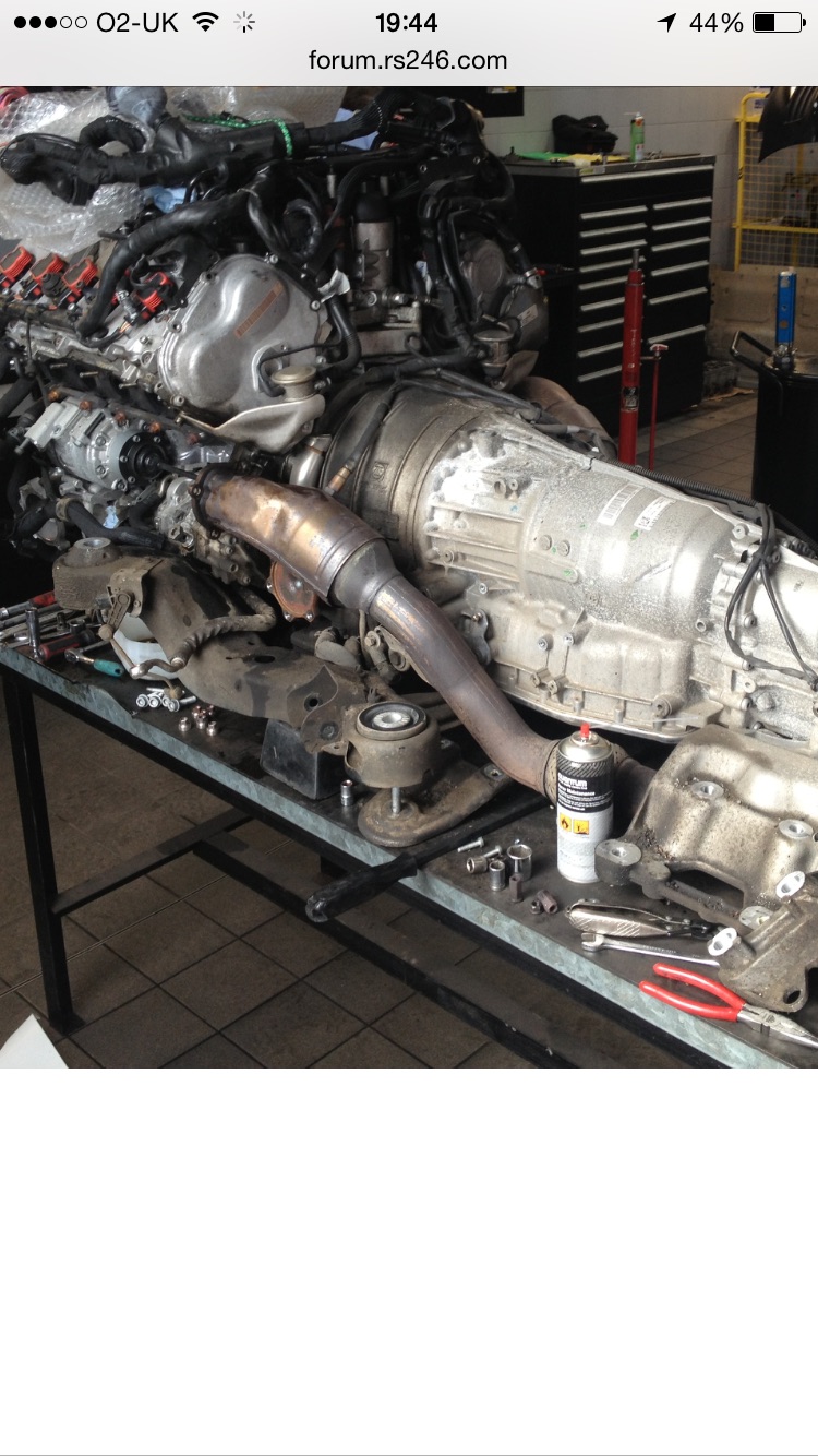

Re: the dreaded oil leak
I was one of the first to suffer
Engine and box was out to sort at Audi.
To be fair Audi showed me the leak when car was on Ramps and engine was still in....could see where it was coming from and it was accessable with spanners BUT engine had to come out to change seal.
I also got all other gaskets done when engine was out to cut down on costs at a later date....head gaskets and a couple of others where "damp" with oil so was a no brainier to change.
This block knocks out serious heat and Audi Tech said "50p" O ring and head gaskets were "brittle" as if heat had got to them and caused them to fail?
Good luck OP.

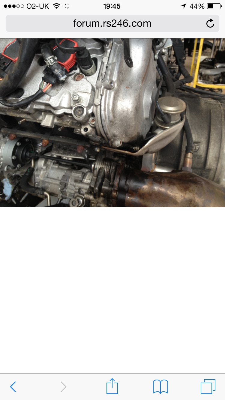

i called the SA in the afternoon to check up on the car and he told me that they might not have to remove the engine and they will try to fix it from "above"....now this tells me 2 things:
1. he doesn't a clue what he is talking about, which unfortunately wouldn't be the first time,
2. it is not the same seal, though i am positive that the leak comes from between the heads and according to ETKA that is where the oil pump is and on top of it sits the oil cooler which can be clearly seen when looking under the intake manifold
nevertheless, i should have some more info in the morning when he said he'd call me back, i am sure i will before he does.
If someone has any pictures or can point better to where this famous leak comes from would be enlightening, mine seemed to be coming from this area on the picture below
l.e. - after having a look again at this picture i might be wrong, seems that the oil pump is on the left side lower part of the engine?!
l.l.e. - i was indeed wrong, at least the leak i saw is not from the oil pump, don't know if there is another one, but at this point mine seems to be coming from the oil cooler between the heads, oh well, we'll have some more info tomorrow.
I think leak was above where oil staining is
You can see oil pump shaft on first pic?
just got off the phone with the SA and he says the leak was caused by the oil filter housing seals, so it means no engine out job, waiting for the warranty approval which i hope will come and then it should be ready by end of week. Have also requested to have the 75k service done as well, perhaps some labor costs will be reduced since the intake manifold is out and could use the opportunity to replace the spark plugs.
first bad news is that the warranty doesn't want to cover oil leaks due to perished seals so i tell the SA that perhaps the oil cooler might be out of tolerance due to all cycles cold-hot-cold so then the part needs to be changed, doooh...it's all about semantics after all, then i talk to his manager and he agrees that that's what must've happened so he instructs the guy to make a second claim which should be approved and everybody will be happy, they get the job done and get paid for it and i am a happy customer! we shall see how this goes on today, kind of irritated the SA can't use his head properly and gets lost in translation wasting my time without the car
, they did give me a loaner, a boring '14 Audi A4 with a CVT gearbox, the most horrible gearbox man has invented....
i hope i'll have some good news later on today, keep my fingers crossed!
well, she's finally back as of yesterday, warranty didn't want to pay in the end so i had chew it
, wasn't all that bad after all now that i look back, it all summed up to cca 1300gbp and included the oil leak fix(new valley pan gasket, oil cooler seals and oil filter housing seals), a new under-tray(i asked for that as the old one was cracked) and the 75k service(spark plugs, oil and all filters), so i guess it's all good, at least i won't have to go back there for another year, if all goes alright. I am still very pissed with the customer service they provide and the fact that it took 2 1/2 weeks to get it back, but i can now enjoy it and that's what counts the most
