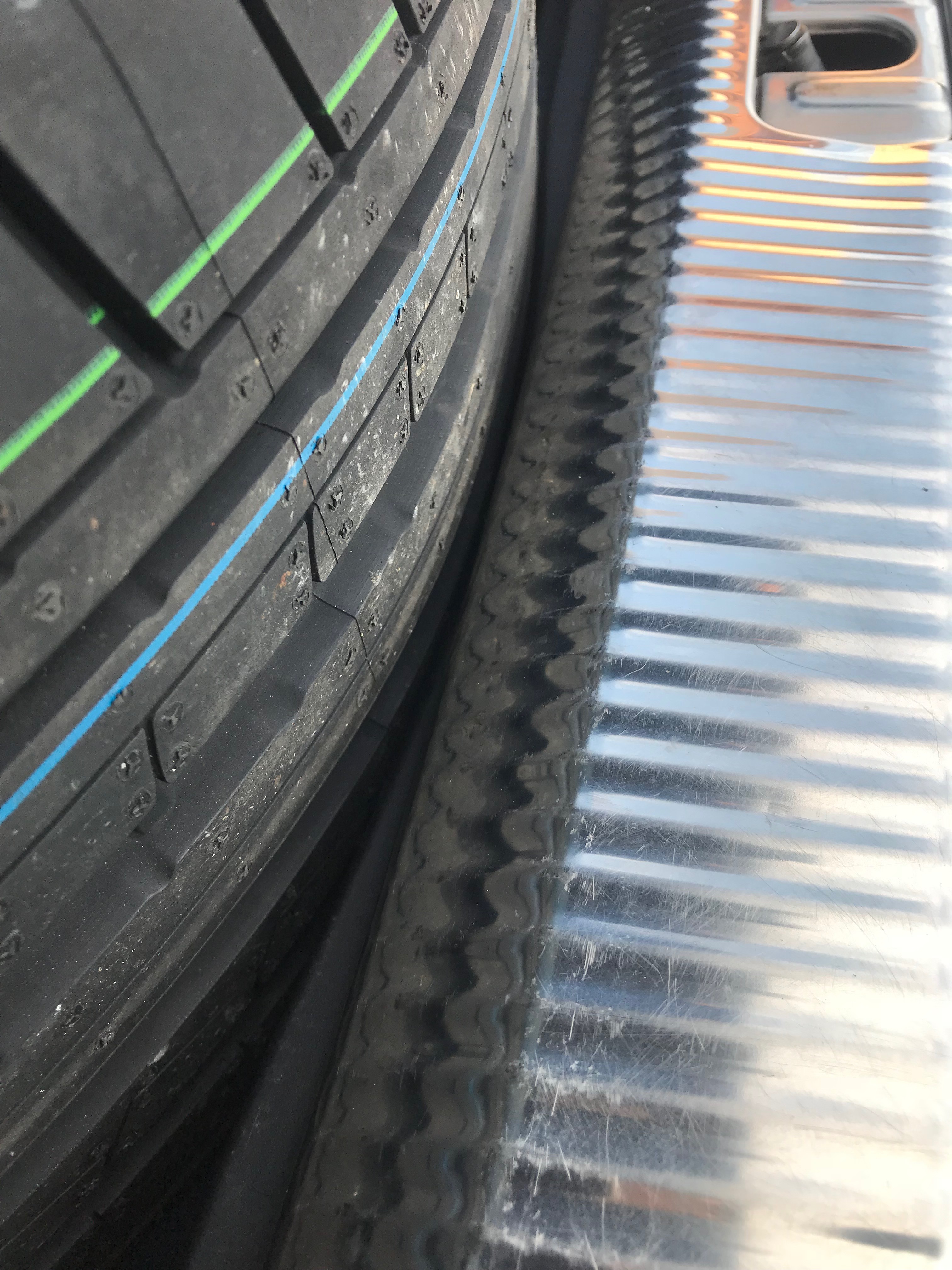

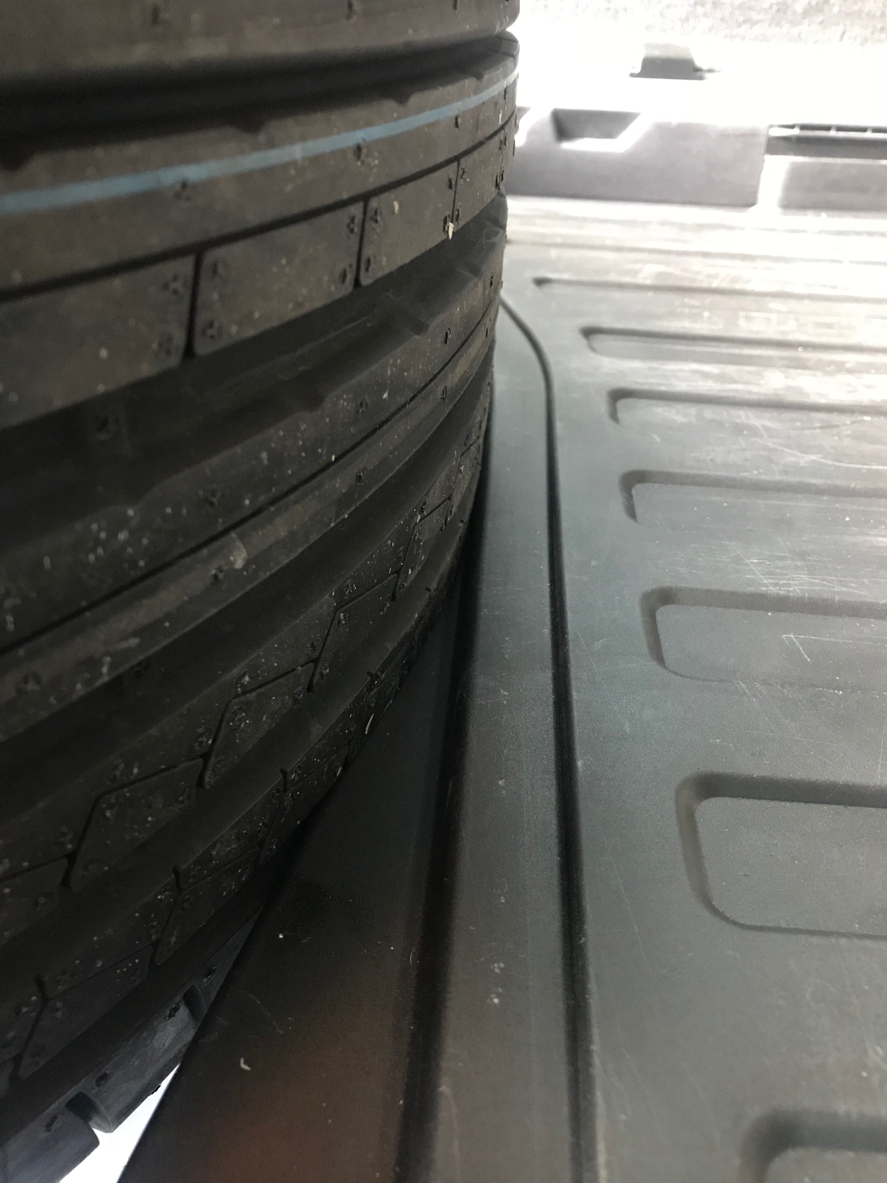

I have a genuine 20" RS 6 spare alloy wheel that I just had a new spec tyre fitted on - a Dunlop SportMaxx GT SP 275/35 R20 102Y XL (RO1).
I took the valve out so that the tyre is fully deflated, and when trying to put the wheel in the spare wheel well, it is a very tight fit. The tread of the tyre catches on the plastic trim of the boot floor (see photos attached). I could probably crush the tyre with my hands and I think that it may just go in, however if I do that then I very much doubt that I will get it out!
Does anyone who has a spare wheel use a new tyre or would a part worn be better? Or are the people that have spares using 275/30R20 tyres?
Any suggestions would be much appreciated,

I couldn't fit one of my wheels when I tried it so hunted around for a space saver that would suit the car and would fit in the well. Eventually found one (after a couple of false leads) which has turned out to be an option for the A6 Allroad. It's 20" and has a 195/50 folding tyre. Fits over the front brakes no problem but I'll always use it on the back.
4G0601011A steel rim with folding tyre (emergency wheel)
D >> - 29.09.2014 6,5JX20H2 ET17
4G0601010C steel rim with folding tyre (emergency wheel)
D - 29.09.2014>> 6,5JX20H2 ET17fit
Thanks for the reply Jim. I remember you mentioning the Allroad steel spare wheel a while ago on your other thread. That's handy that it fits over the front brakes, but I agree with you that it would be better on the rear of the car.
I shall buy one of them when I find one online.

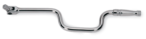

As a side-note, Snap On recently had part number SN4B on promo which is a 1/2" drive flexible head speed brace which is, in my opinion, the best tool to have in the car for removing wheel bolts at the side of a road. I use it with a 1/2" drive 17mm alloy wheel socket that has a plastic outer case so that it doesn't chip the paint if it comes into contact with the wheel.

As a side-note, Snap On recently had part number SN4B on promo which is a 1/2" drive flexible head speed brace which is, in my opinion, the best tool to have in the car for removing wheel bolts at the side of a road....
....apart from a torque wrench obviously! :thumbs:
To be fair, ANYTHING is better than the little wheel brace the cars come with :shock:

Hahaha, I walked into that one!! I did consider that but decided against it. All the rattling about would knock the calibration out over time!
