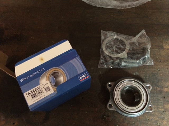

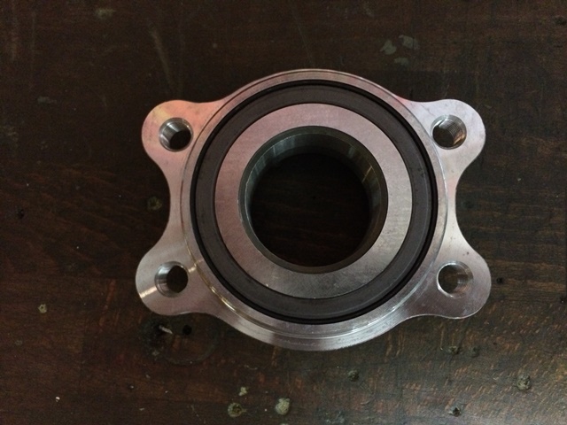

My car was clicking from the front (front right) mostly. Bought 2 new SKF units to replace both of the front units on the car. My car was parked for the month of April and May, and after I came home at the end of May it has not been clicking........ Odd. So I have the 2 bearing sets in my workshop now. Im sure it will begin clicking again. Hahaha, but its been 2 weeks of silence now......
Ohhhh, and the bearings are COMPLETELY sealed 2rs and ZZ bearings. No way to repack them with grease or do anything else to them for that matter. Must be an urban legend.

Sealed bearings....... Impossible to re-pack or grease....
