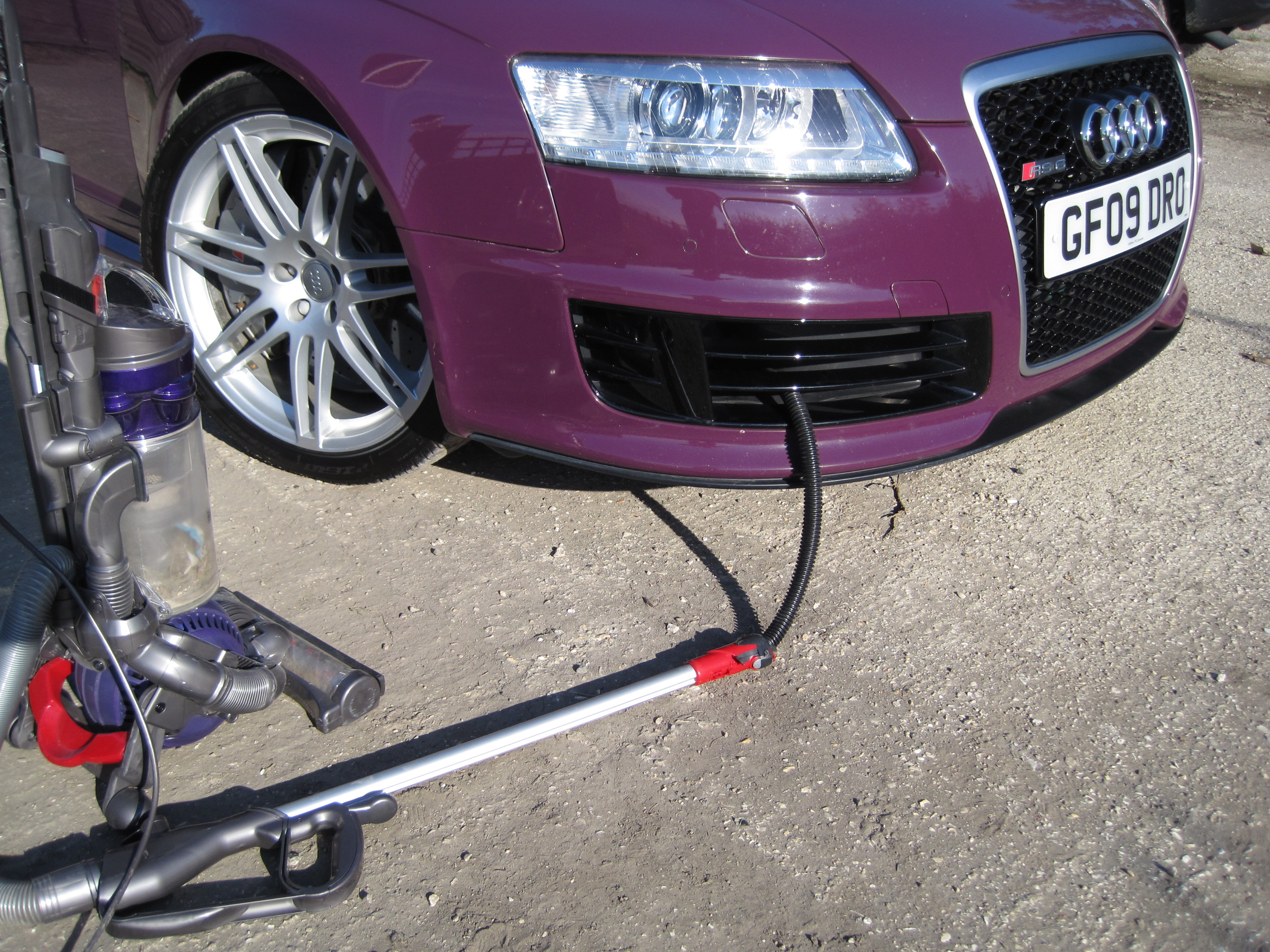

RS6chris! wrote:Always said you cant beat a good blow!!!!!!!!!!!!!!!!!!!
Personally, I think a good suck is better - Dyson, tubing liberated from water butt (giggles), 12" of electrical tape.....
