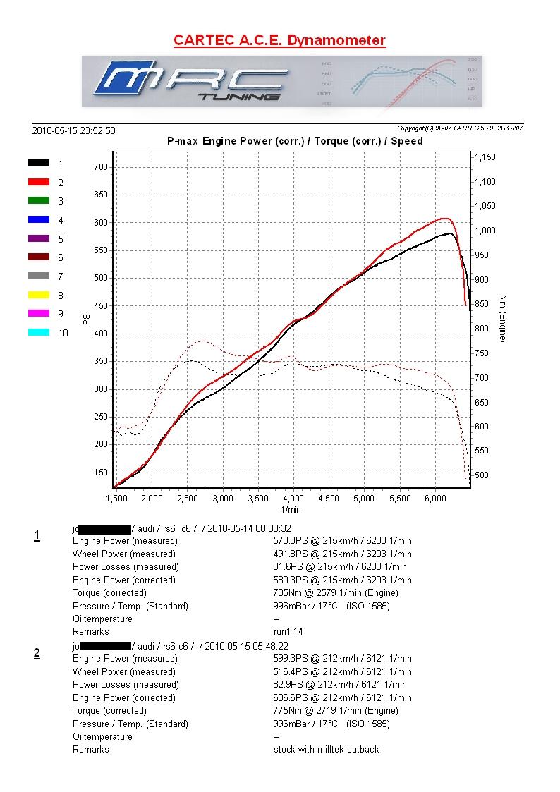

Some dyno plots of one of our customers cars that we will be doing more work on in the future to see what we can get out of the C6
Stock and stock with Milltek:

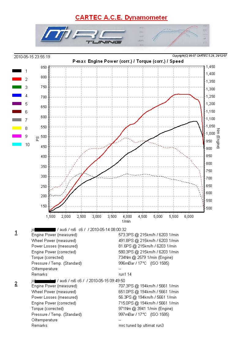

Stock and Miltek with stage2 tune, tuned to be safe

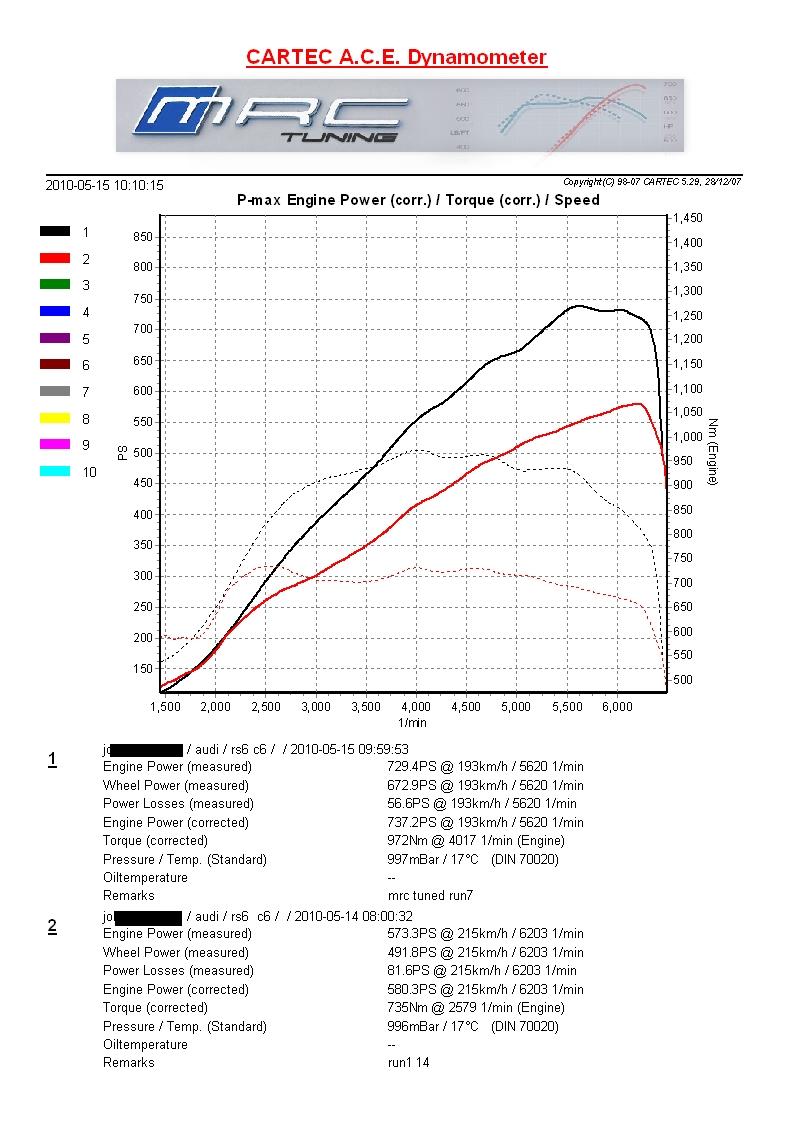

Stock and Miltek with tune that is pushed

Thats some great results there.
