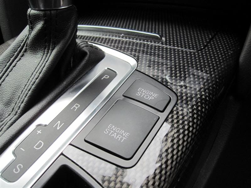

From this:
To this:
Using this:
2010 spec starter switch part number: 4F2905217EVUV
Around 30 quid.
Cheap and easy mod.
Enjoy!

Whats easy is it to fit?
How easy is it to pop the old one out, and is there much wiring to do?
Golfather
Posts: 3033
Location: Berks
Post by Golfather » Sun Jan 24, 2010 2:08 pm
Holmax wrote:Whats easy is it to fit?
Its plug and play.
Pop out the leather gear gaitor from the left hand side, push the old switch up from underneath, replace with new one.
Job done!

Post by Nudenut » Tue Feb 02, 2010 12:35 pm
Its plug and play.
Job done!
When you say "pop out" is it a case of grabbling the gaiter and pulling it up/out? or more surgical, don't want to go in all guns blazing and damage anything :lol:
R8 V10 Coupe, R-Tronic - Ibis White & All the Carbon + Ceramics + Heffner Performance Twin Turbo.
Golfather
Posts: 3033
Location: Berks
Post by Golfather » Tue Feb 02, 2010 1:19 pm
The official workshop method is to remove the climate panel, and then the ashtray to get to the switch from behind the centre console.
But popping the gaiter is easier :thumbs:
