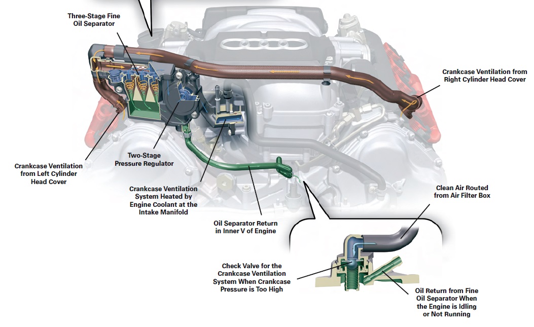

Knowing that the crankcase pressure was too high i began to look for the culprit with the following 2 options being the best bet after checking everything on top of the engine.
1. vent pipe with check valve - 07L 103 217 B circa £40
2. oil separator incorporating two-stage regulator - 079 103 464 D circa £135
The vent pipe is a bit of a nightmare as the entire inlet manifold has to come off to access it so i decided to try the oil separator first and thankfully this was the problem.
Upon removal (which is fiddly but not too difficult if you whip the throttle bodies off) we discovered that the spring operated piston over the cyclones was jammed in and you could blow back into the separator from the oil return pipe.
A swap over and reassembly has the car running smooth again and no faults being thrown up.
