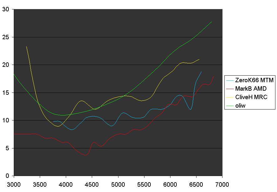

A graph showing timing for MTM, MRC and AMD on similar states of tune cars...
Timing plots.jpg (37.69 KiB) Viewed 1279 times
Mark

CliveH wrote:That's very interesting Mark, and very clear. A lot of MRC tuned cars get even more timing advance than mine.
Yes it does show quite clearly the differneces. I chose you car knowing that the timing was much the same as cars with pre-cats fitted to show a fair comparison.
Hope thats OK 8)
Mark

Oli, you get the prize for the smoothest line and yes the timing does look good
Timing plots.jpg (41.53 KiB) Viewed 1266 times
Mark

Interesting... I run more boost/less timing and Clive is the other way around. I know I would choose the MRC map as this has got to be better for lowerend power & turbo life.
Facelift Imola S4 | Cust K04's, Tubular Manifolds, 3" DPs->2.75" Catback | FMIC | PSS9 Coilovers + ARB's | Brembo 8-Pots | SS + DTS | 5??HP/475lbs/ft | 3.06S FATS on S4 Box

That seems to be MRC's thinking. It must be done whilst using good fuel though
Mark

Mark - thanks for sorting these plots! really helps put things into perspective.
Seems AMD have very poor timing? Was this car mapped with poor fuel/running even higher boost?

Even higher boost I think. I'm going to try and log mine tonight.

Yeah seen that :( , can you plot on the boost graph here what the requested boost is? Obv you have some boost probs though as the actual aint right...
