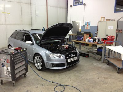

Hi all,
Just began the carbon clean tonight, got the IM off and, to be honest, looks pretty bad in there! The car was doing 10.5 seconds 2k - 8k rpm in 3rd before, lets hope this makes a difference...?
Ready to go !!!

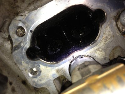

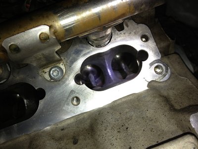

hoiw many miles? those valves don't look too bad

Sorry Arthur, I miss typed! I meant 3-8k rpm @ 10.5 seconds. The cars now done 48k miles, done the clean today, went very well to be honest, and learnt a few tricks along the way :) the first pics I took don't really show the extent, even the IM and flaps were caked in oil/sludge. Going to rebuild tomorrow, and do the engine, box and diff oils.
