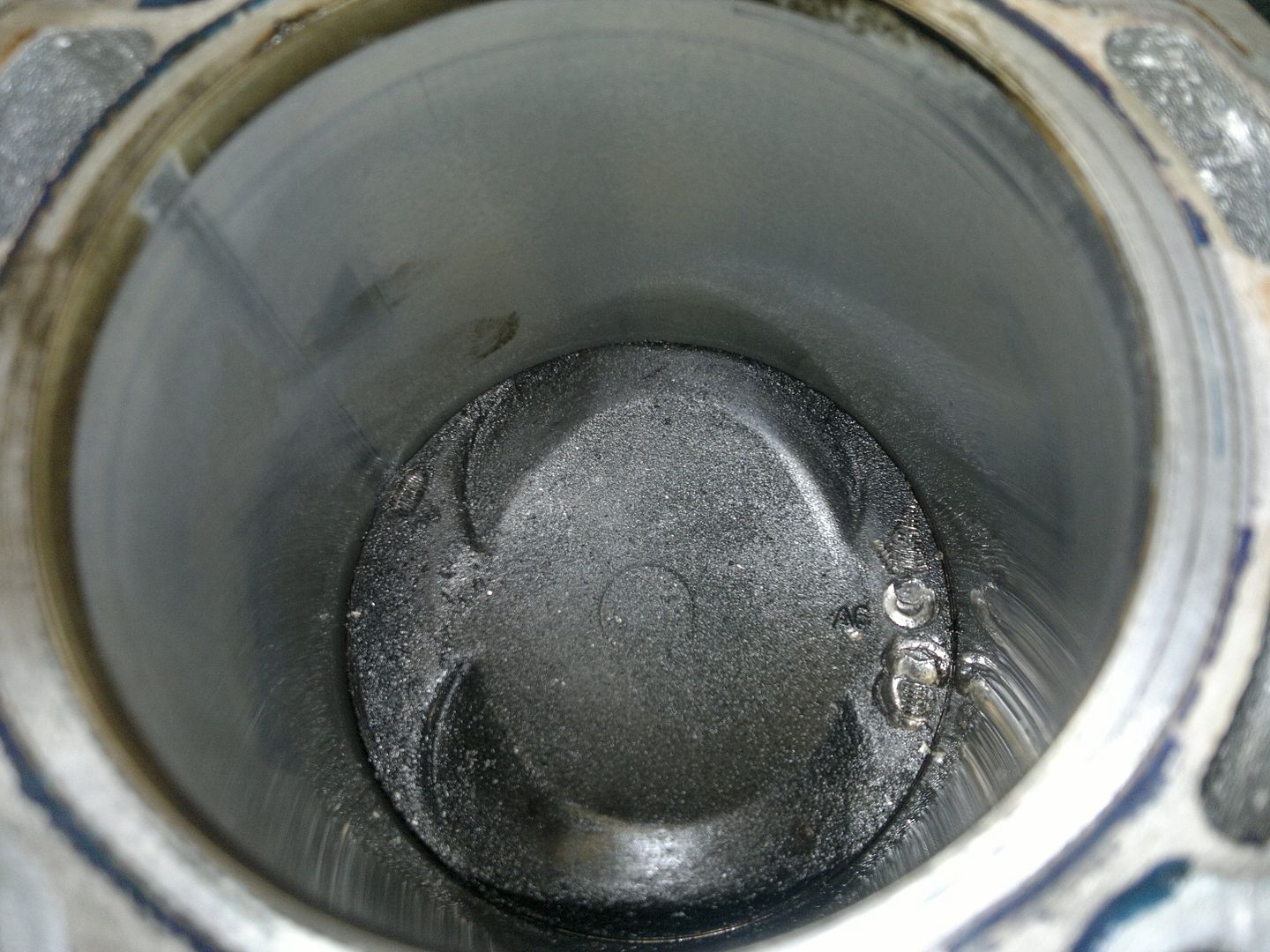

The event that has made me post about this is because we had an RS4 brought in today sounding like a box of spanners ....comp test showed no comp on cyl no5 , we used a bore scope to inspect inside the cylinder and witnessed what looked like the retaining bolt that holds the intake flap to the runner mashed into the piston !! the engine is coming out next week for a strip down and inspection ...i will post up some pics

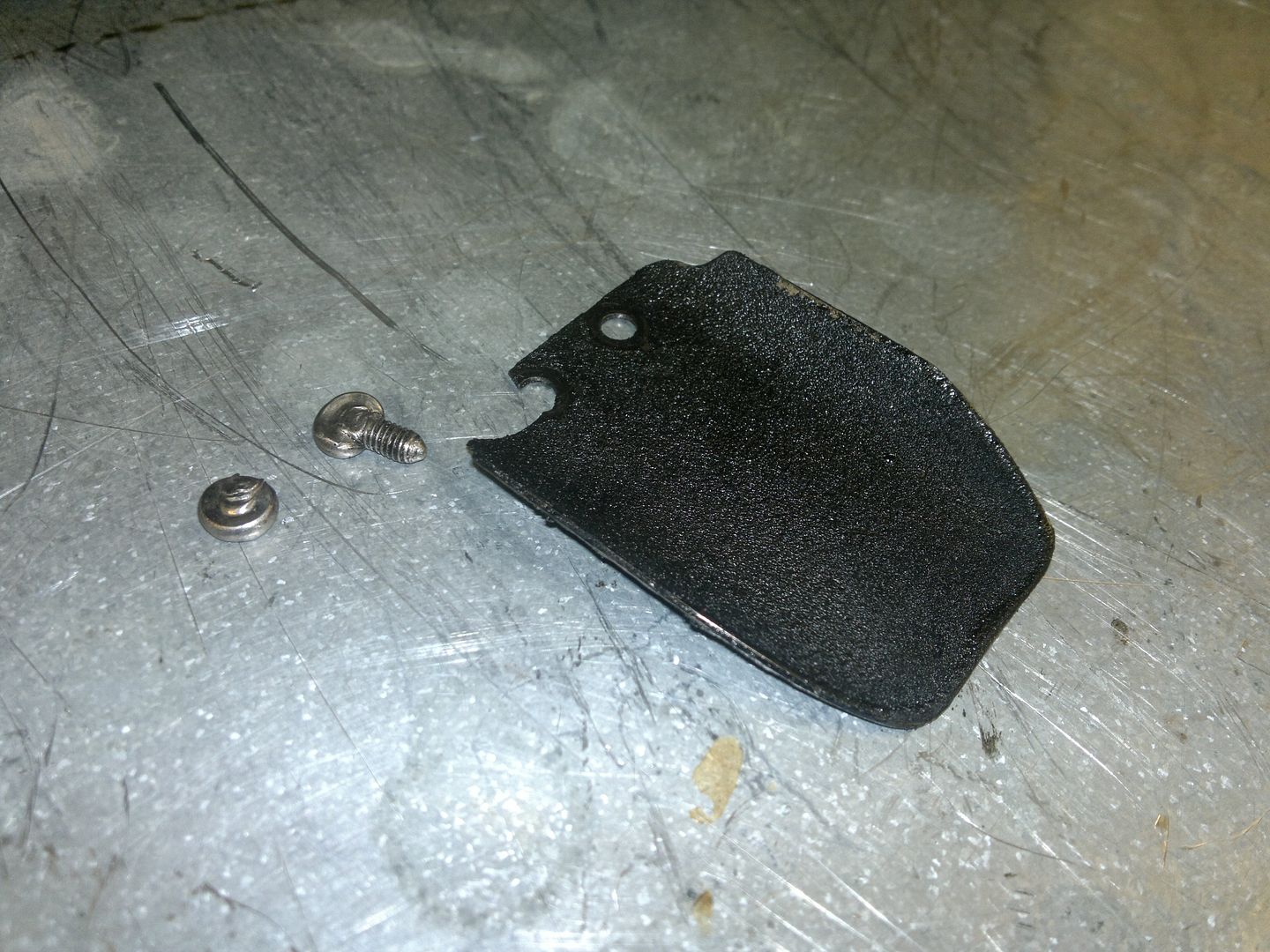

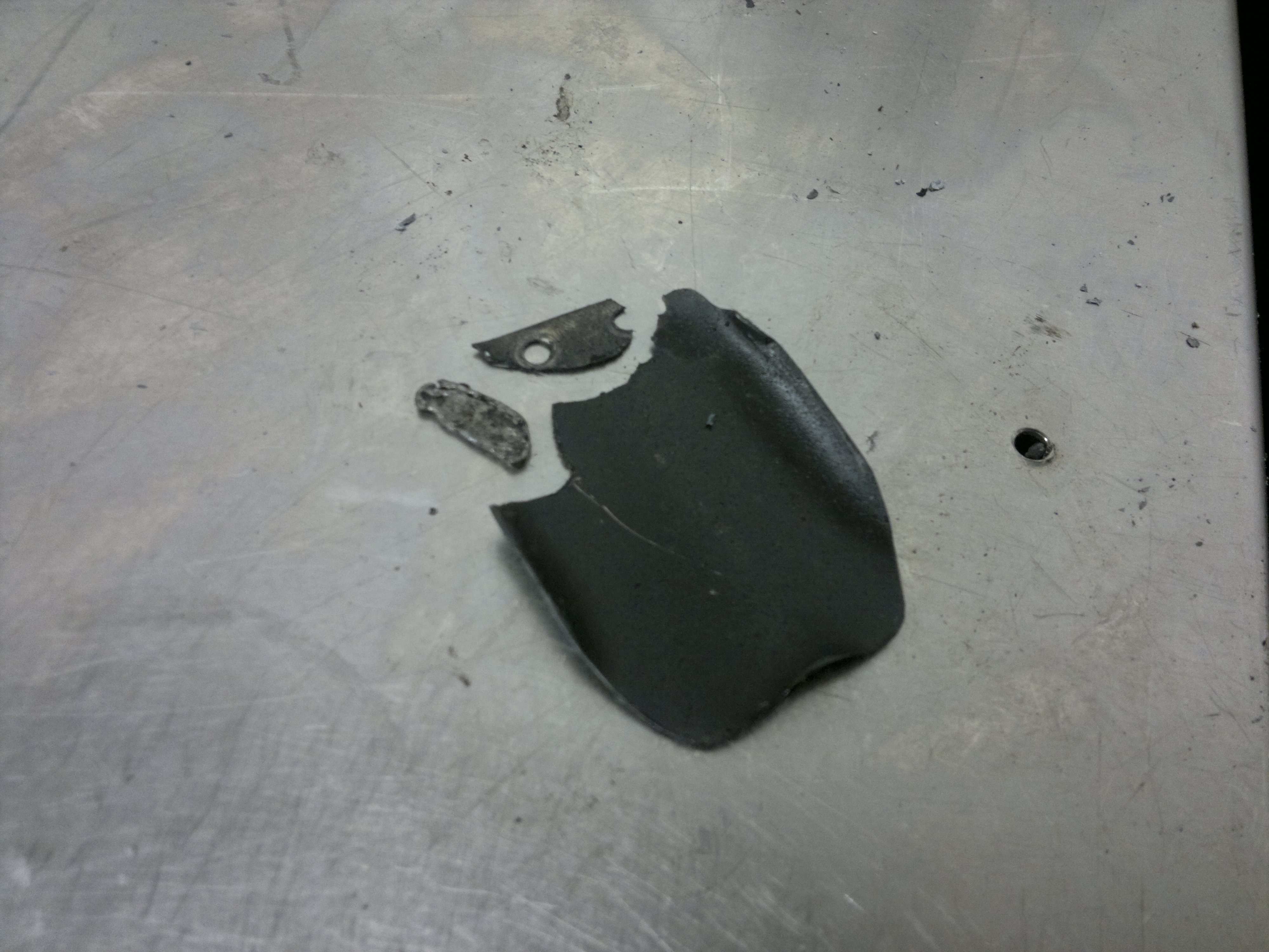

we have aslo had a flap break off from the runner and fragment causing a piece to go through the engine ....in the pic you can see the small mangled piece on the left that had been through the engine.

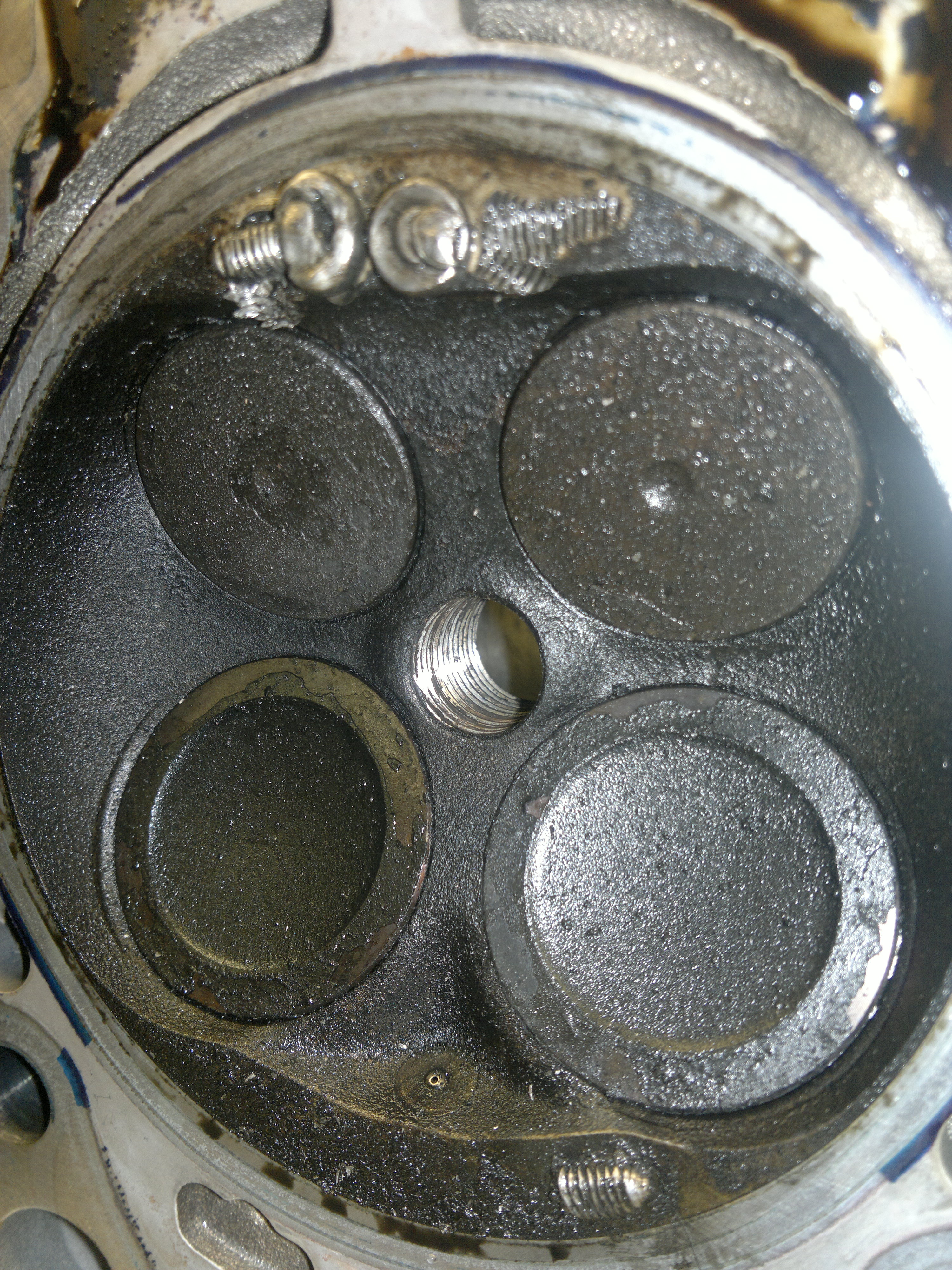

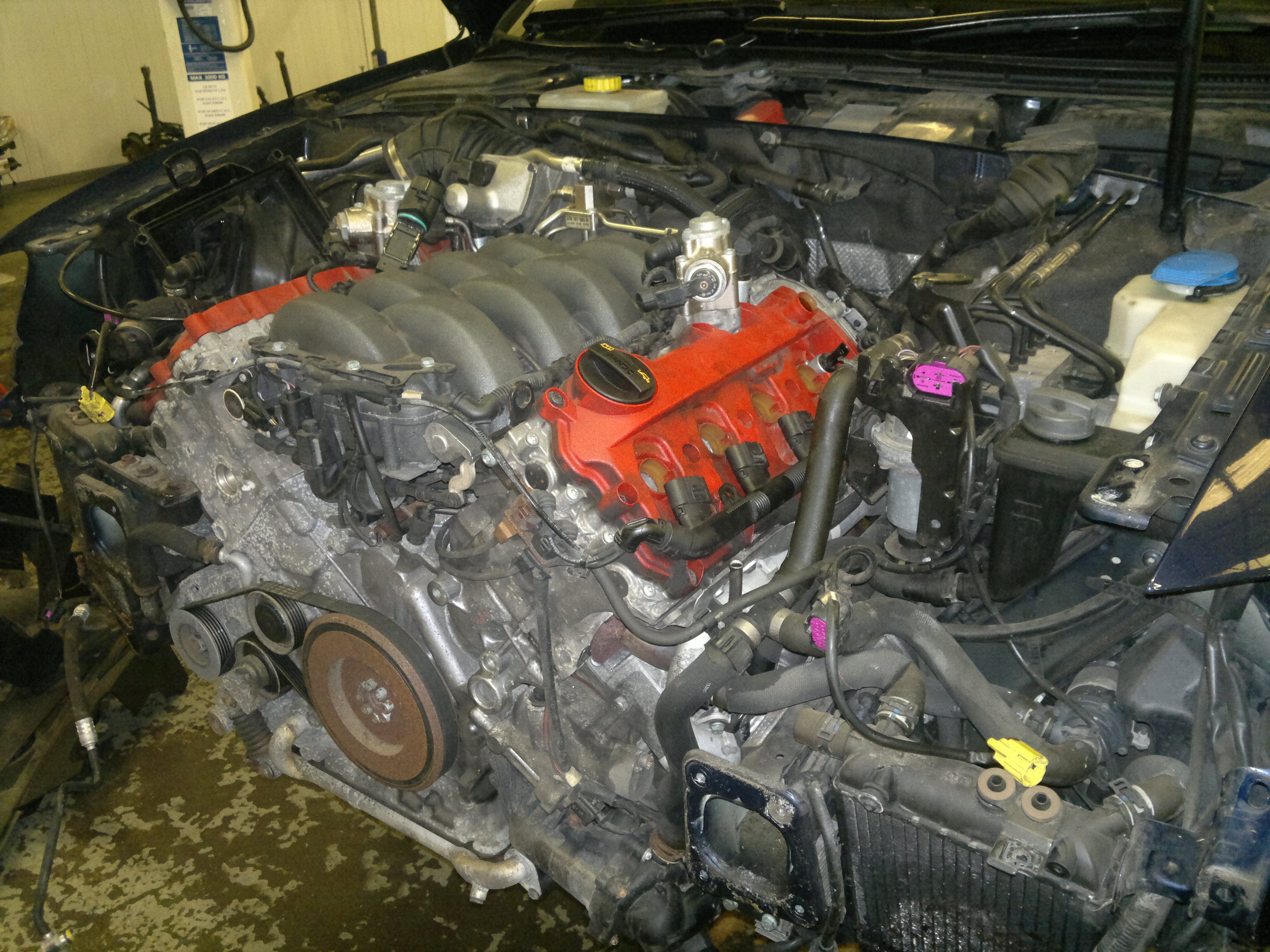

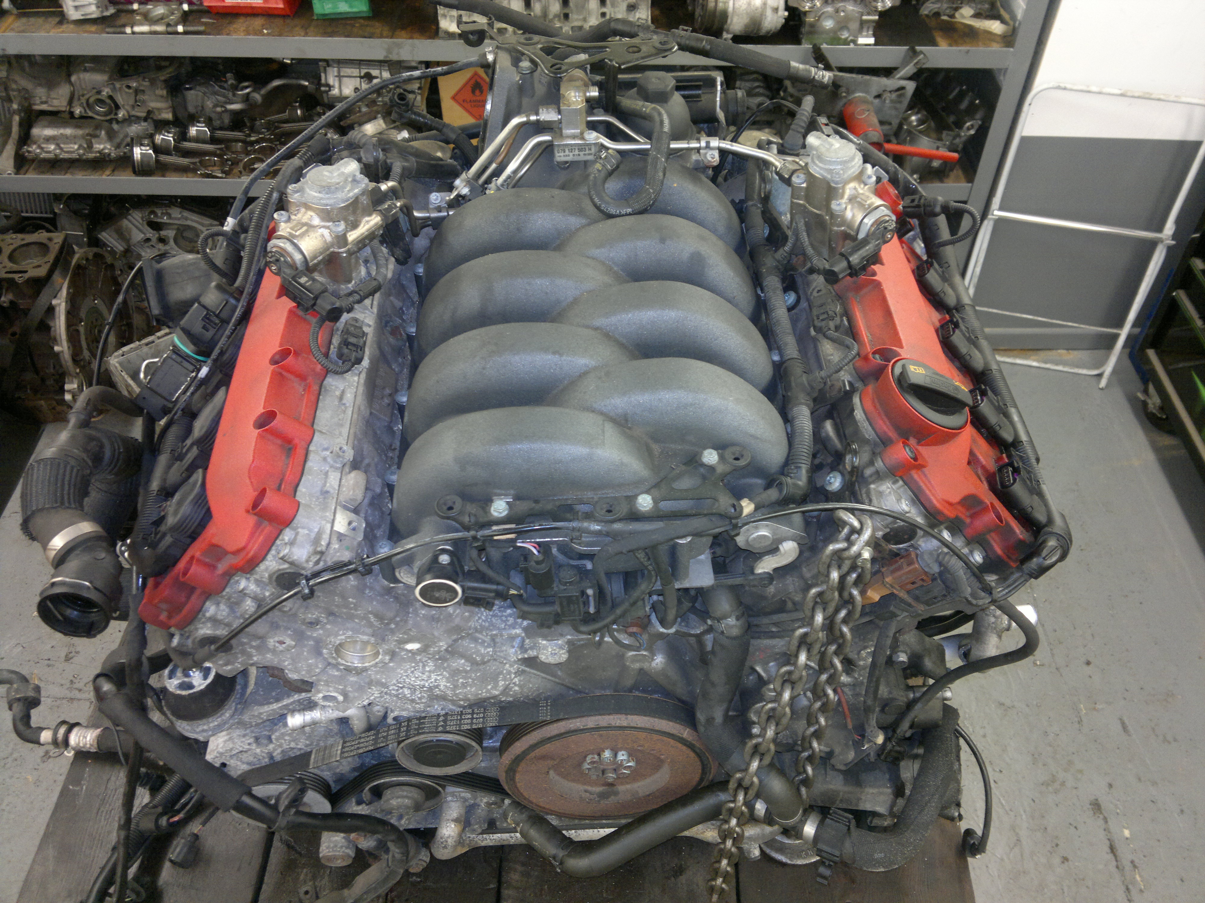

Post by rs4lee » Wed Sep 26, 2012 8:25 pm
engine finally came out of the RS4 that i mentioned above ...here are some pics !!
inlet flap runner bolts mashed into cylinder head by piston

the bolts have damaged the piston and cylinder bore aswell ....if my laptop didnt keep falling over everytime i try an upload pics on here id post the pics up lol ..... i ll keep trying.
customer is weighing up his options ...think he might try and source a complete motor
