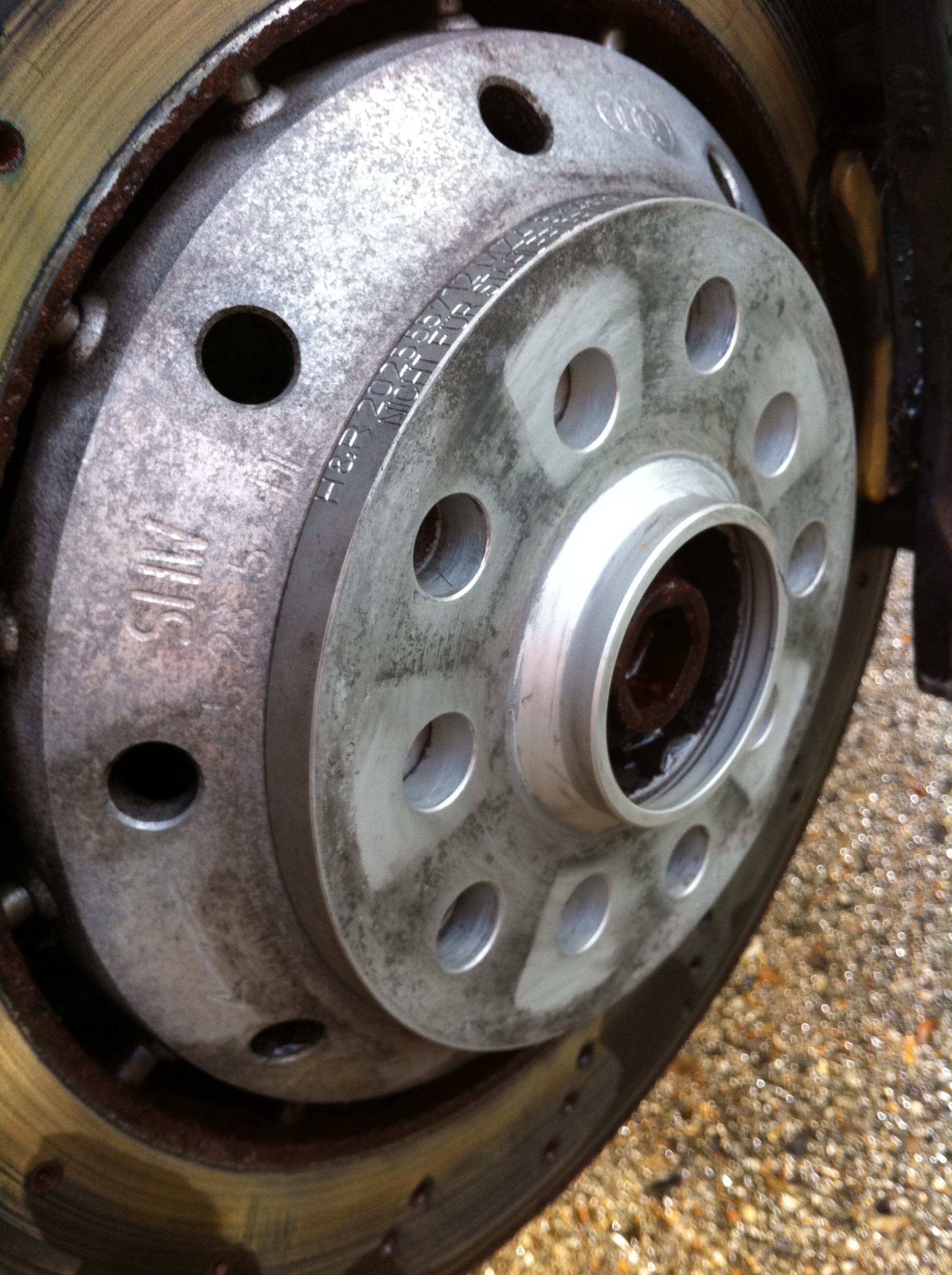

Pls help, I am trying to fit some 10mm H and R spacers to the rear of my car (its on the jack now) and when i push them on the hub they dont quite go all the way on, There is a small lip on the spacer and it stoping at this point about 1mm from fitting flat against the hub, Am i suspossed to flat this part of or am i doing some think wrong, They fit in the wheel dead right, Pls any help would be cool, Cheers Tim. (They are H and R trak+ and are for my car, so they say)

Can you take a pic and post it? What is the part number??
The 10mm ones do have a small bevel lip, what is the diameter of the face?

My rears with 10mm spacers, do they look much different fro this pic..is so then I would say you have the wrong spacers.

They look the same as yours in the picture and the part number is 2055571B mza4+45

If you look at your picture where the hub meets the inside of the spacer there is a small lip there thats whats stoping spacer going all the way home,

so your inside lip is deeper?

Sorted them now thanks, I think they must have been machined very slighty out i just to have 1mm machined of the lip where it buts upto hub and they now fit perfectly and no problems on a fast rd test so all is good and they look great, Cheers

Can you post a pic? They are made from aluminium so should not need shaving down.

Hi sonny, Yes they where H and R and made of alloy as you know, The date on them was 12/2011 so i was thinking they may have been machined very slightly out, the amount i removed was not even 1mm if you did not look really hard at them you would have thought they had gone on correctly but they were sitting very slightly off flat, I had heard some people were having vibration problems when fitting H and R spacers may be this is why, as i say if you did not really look you would think they were ok and sittng flush but if wheel was fitted they would sit slightly on the piss, Cheers Tim.

the hubs come with different hub depths and angles
if you machined it it's not the right one
people have split the spacers by using the wrong ones
when searched for there is no 10 mm RS4 application http://www.trakplus.com/results
faq item 8, note 18 link
http://www.trakplus.com/faq
audi bevel is 45 deg
but height varies: 4, 5, 6.5 and 7 mm
not sure what ours are
looked at mine
AUDI / VOLKSWAGEN
DR / 8 162555716 14.00mm 7.0 x 45 degrees
the spacer will be marked with 7 x 45 or 5 x 45, etc.
ArthurPE
Posts: 3755
Location: USA
Re: HELP with spacers pls
Post by ArthurPE » Sat May 05, 2012 11:03 pm
api330 wrote:They look the same as yours in the picture and the part number is 2055571 mza4+45
wrong spacer
that is 4 x 45, ours take 7 x 45
yours: AUDI / VOLKSWAGEN DR / 10 2055571B 12.00mm 4.0 x 45 degrees

As i say i had the 1mm took of and they fit perfect with no problems on test, They would probaly have spilt if i had not took the 1mm of but they went on perfect with no movement in spacer on hub and no movement when spacer fitted into wheel and they where 10mm spacers as i did measure before i fitted them, I think you maybe right about them being in correct but i just had the 1mm difference removed and it only came of the thickist part of spacer, I will keep my eye on them but as they fit perfectly cant see there being a problem, I will how ever be phoning them on tuesday

what area was machined?
the face/thickness or the bevel
I'm guessing had to be the bevel
you made the wall thickness thinner
look at them see if it says 4x45 on them, 3 mm is a big difference
