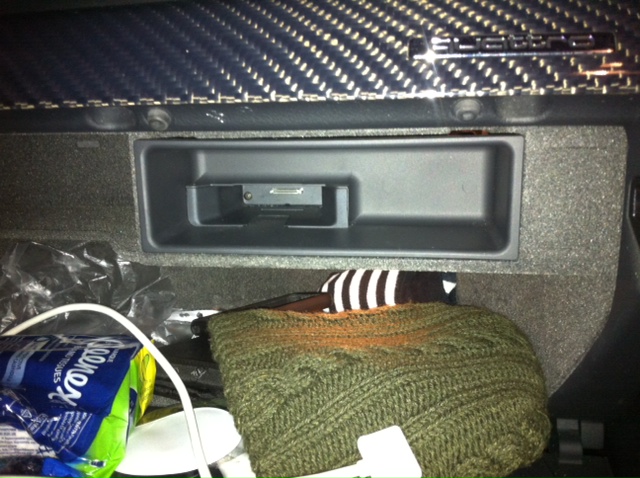

Got any pics of it insitu?

It will come with a 2m Apple male to female lead that I ran from the doc out of the underside of the glovebox, under the edge of the centre console and into the armrest tray so i could still see the screen on my phone
