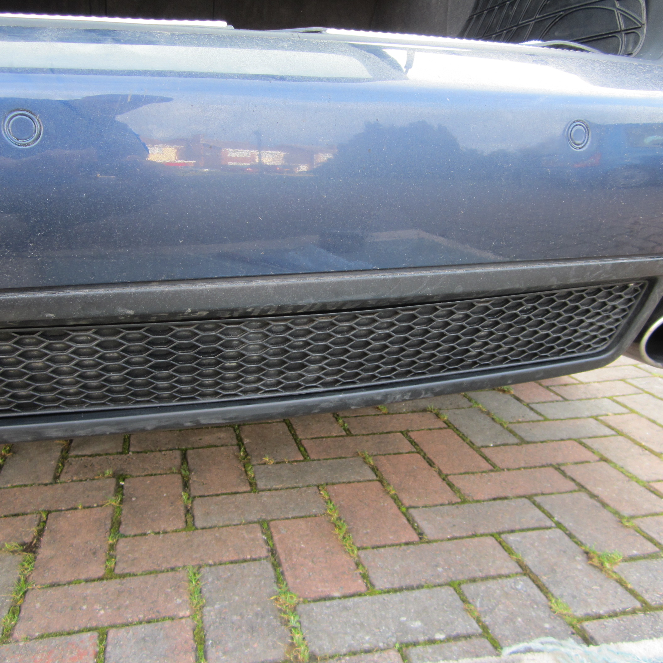

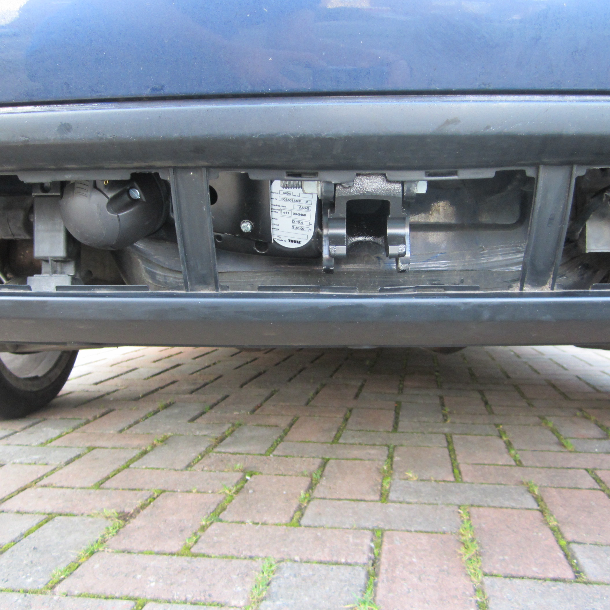

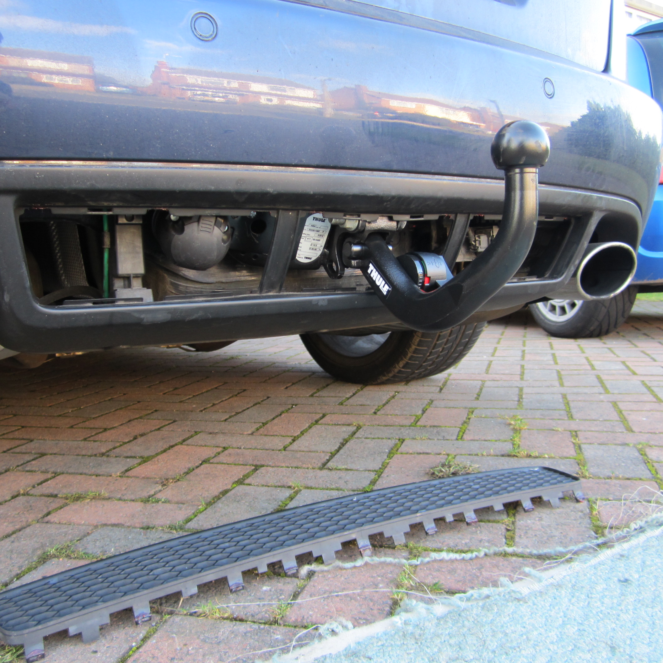

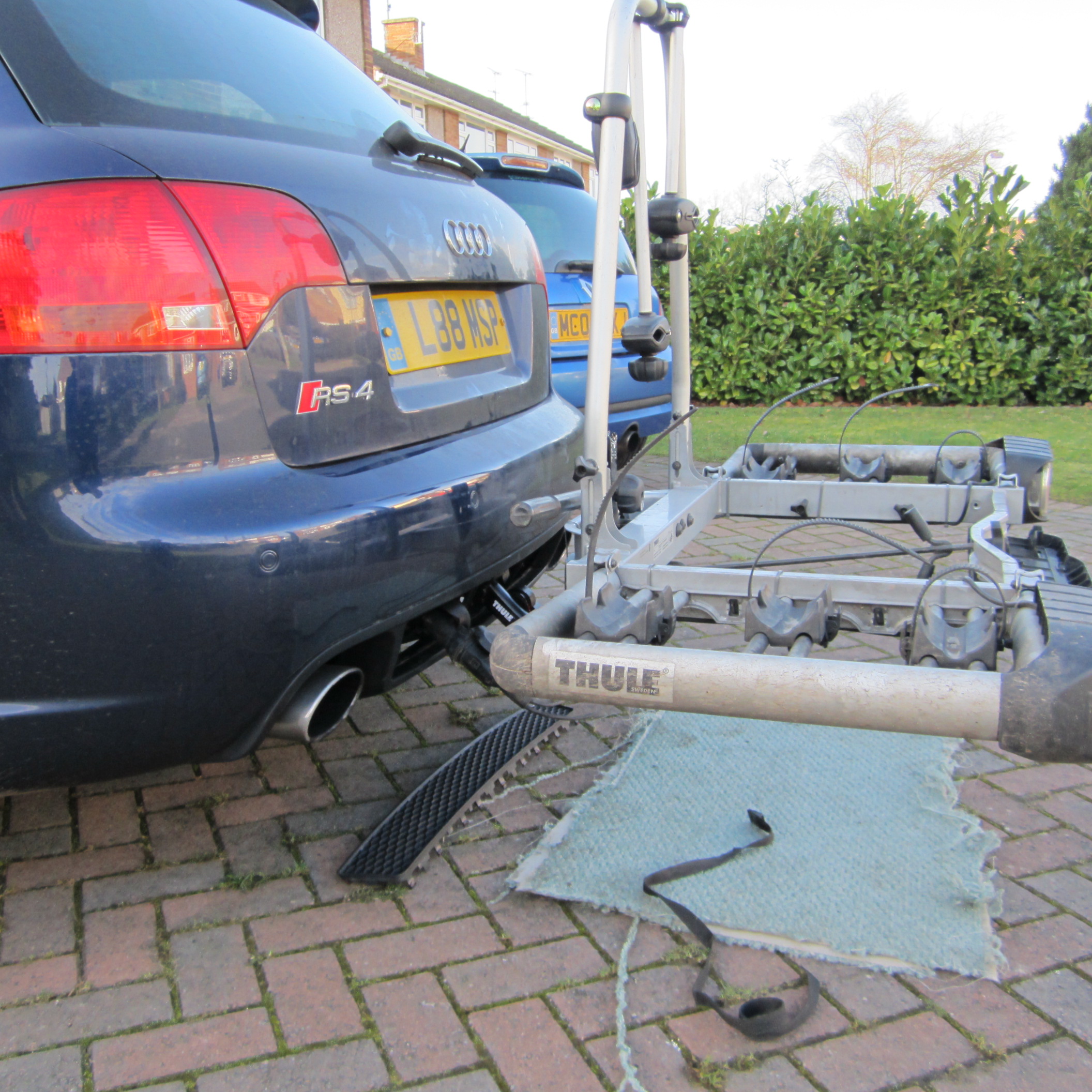

I ordered a Thule/Brink detachable tow bar for A4 Estate quattro, number B440400a from Towequipe.
Getting bumper off was stressful as I don't like pulling on interior trim until sure of where all fittings are located, but got there in the end. I bought a Haynes manual in the end. Actual tow bar fitting was easy, especially with help of an eight year old to hold mounting nut above silencer!
Grill in rear bumper pops in and out, mine had metal clip for added security. I've removed so that grill can be removed easily. Mounting for tow bar touches back of grill, so it bows out now at top very slighly. You can only notice when really looking. No cutting of body work or bumber at all, and almost completly invisible when not in use. I'm pleased with result.
Just electrics to wire in. I've ordered 7 way relay to ensure cars electrics not affected when bike rack plugged in, means I will need to switch off parking sensors manually.
I did take many more pictures as works progressed, so if anyone does want more info let me know and I will create pdf.

Nice work, and that's a great result in my book! Really good that when it's off it doesn't affect the aesthetics, so an unmarked RS when not in use, and and extremely fast stable bike carrier when fitted - I'm definitey going to follow this route based on your experience, so pics or a PDF would be much appreciated.
Also, do you reckon that the grill could be tweaked to eliminate the slight bulge? And from what you've experienced so far, do you think it's worth putting some kind of additional fixing to the grille just to make sure it doesn't come out in normal driving, or does it seem solid once popped back?

Re: Tow Bar....Help!
I'll try to pull pictures and notes together soon.
Nothing you can do with Bulge as cause is the socket for the detachable section, so I wouldn't risk modifying. However it is only slight, and once stood back from car no one would know.
Grill appears solid. I've even greased mine to aid removal as it still needs fair old push from behind to pop out. I've tested at RS4 pace and it hasn't moved yet!

Glad to see other folk have gone and fitted tow bars. I thing the link of my work was posted at the beginning of this thread. Nice to see a different approach to my hacking a lump out of the rear bumper.
I've done three trips to the alps now, fully loaded with 3 bikes and blokes - great way to travel

Kudos to you for having the nads to just go with it mate, looks bang on what you was after, you gotta be well pleased with that!!
