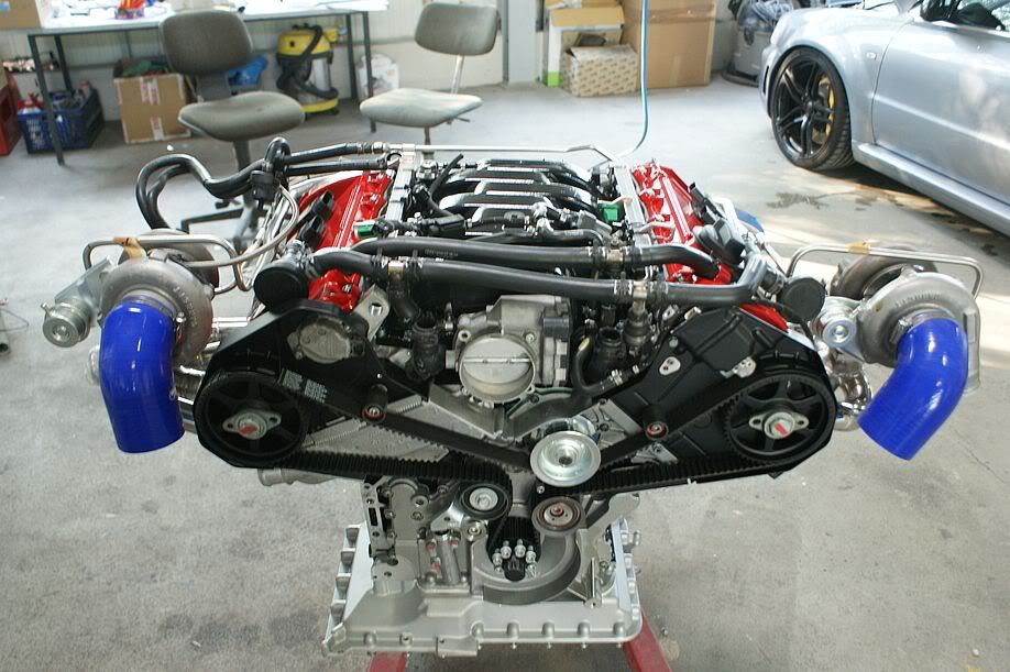

it's alsmost impossible to fit a single turbo set up on the RS4.
this what I'm looking to make. My budget is 20 000$USD
http://www.audizine.com/forum/showthrea ... b5-s4-rs4)

I may be wrong but that looks like a C5 RS6 V8 engine, not the FSI V8 with turbo's bolted on? specifically that is belt rather than chain driven.
Re: TURBO GURU WANTED
Post by bam_bam » Mon Aug 15, 2011 1:03 pm
P_G wrote:I may be wrong but that looks like a C5 RS6 V8 engine, not the FSI V8 with turbo's bolted on? specifically that is belt rather than chain driven.
Yep sure is. That B5 with C5 RS motor is pretty old that now. I wonder if the B5 engine bay is any smaller than the B7...
There was a recent 'Stateside B7 project that was to have a C5 RS engine fitted, I think it was abandoned for some technical reason.
