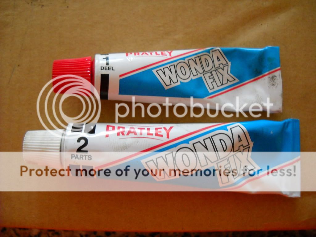

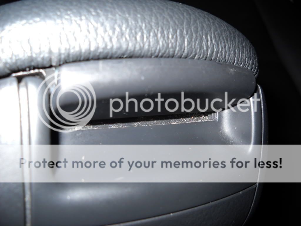

Here is the fix that one of my mates did either that or buy a new clip!
I have however managed to fix mine and it works 100% So I decided to post a small how to:
1.
Here is a view of the broken clip and other parts.

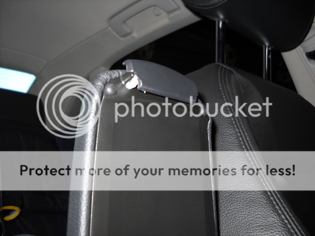

2.
Open the front end of the lid. I inserted a kitchen knife to hold the twp open whilst working.
3.
My weapon of choice was pratley's WONDA FIX, just mix 2 parts to 1

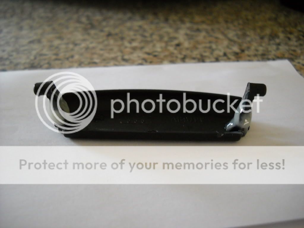

4.
Here you see the same part after I have glued the clip back on. Let it dry completely before attempting to re assemble.
As you can see I was not shy with the glue.....you can always file away the excess with your better halfs nail file.
5.
Re assemble and volia.
I was a bit scaeptacle about the lasting result, but I can feel that it is rock solid and will not give me problems
