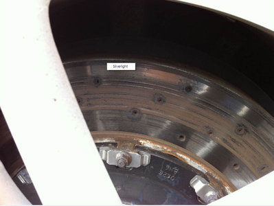

Rate these Audi Approved discs....
Post by neckarsulm » Sun Mar 20, 2011 7:08 pm
https://cid-ac6b22ed80d97a2d.photos.liv ... SDX.Photos
Slough Audi said they don't need replacing as they have recently been replaced.

Sorry, try these

The holes are full of crap
Btw. Im guessing they're both rears?

Post by neckarsulm » Sun Mar 20, 2011 8:01 pm
fronts and car had been recently driven

neckarsulm wrote:fronts and car had been recently driven
How does that happen then, one side so poor relative to the other side? I was thinking maybe there's an imbalance with the hand brake left to right causing the rustiness but if they're fronts???
You wouldn't replace one disc only...

Hard to tell from those photos, but I would say the holes need cleaning out and perhaps change the pads to something more agressive with less dust; Ferrodo DS2500 or EBC Yellowstuff. Cheaper than replacing the discs. Are you getting vibration?

No vibration he (my friend who has driven it) has mentioned.

Harder pads will clean those up then I suspect and probably give better retardation.

looks like the pads are sticking one side

Hard to tell from the pics.
They may have been changed and the car may have stood for a few weeks/months with a good coating of winter road salt.........

looks like they were scored and then left. the recessed bits aren't being cleared by the pads.
should only take a couple of good braking stops to clear the corrosion.
as for recently changed - BS.
