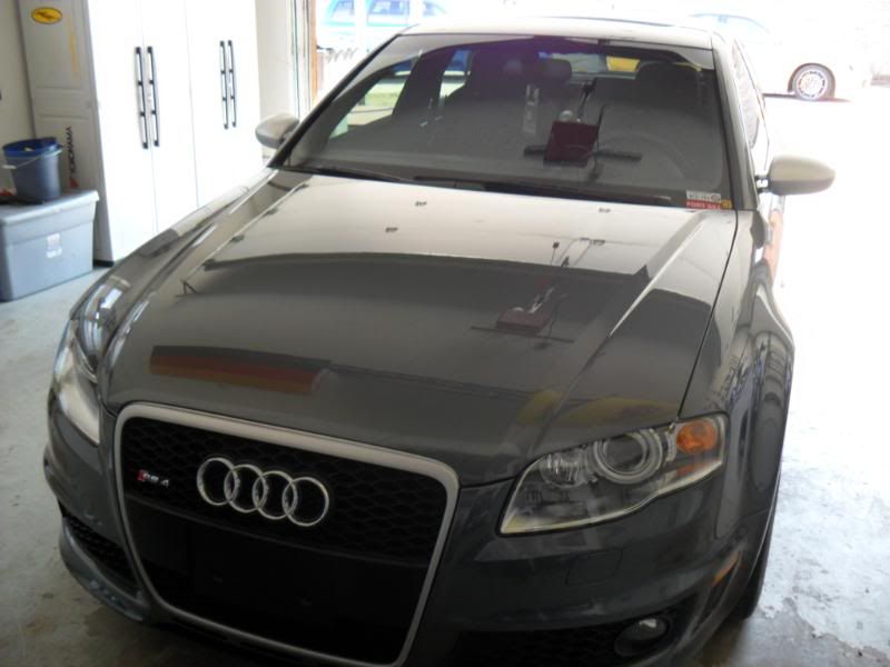

Post by novtec1 » Thu Mar 17, 2011 4:29 pm
caldy wrote:Be careful removing the front. Proper way is to remove the front grille. You can prise out the rings from the housing but there are 12 'sprung clips' to access which are part of the whole Audi Rings and are only made of brittle plastic. There are 3 clips on each outer ring (7 o'clock, 9 o'clock and 11 o'clock when viewed from the front) and 2 clips (6 o'clock and 12 o'clock) on the inner rings.
yes but to remove the front grille you gotta remove the bumper, and once its off you can lift on the tabs then follow the steps above... they are weak and break pretty easy. did this when i swapped out my grille... was a paint but turned out pretty well when i was done.
before
after
Why the S-Line grille?

Post by novtec1 » Fri Mar 18, 2011 4:47 am
well cause it was free and the old one for some odd reason was peeling and chipped up.... so i just replaced it
