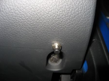

3. There's a small black box with a silver backing on it hanging down under the front number plate behind the grill. I guess this shouldn't be here, should it?

3) Judging by the mods your car has had and the money that was spent on it, I would not be surprised if the module hanging down was a Lidatek 30 or similar Police speed trap laser Jammer, if it is a Jammer and you don't want it any more I might be interested in sending you some money for it.

3) Check if there's a button or something under the dash near the bonnet release. There's usually an on/off if it is what Ice/me thinks it is.

Thanks. I wondered what that little switch was!! Should the module be hanging down with the silver showing as it's v noticeable......

Sounds like a previous owner may have fitted a laser "garage door opener" (otherwise known as a laser speed gun jammer).Guernsey70 wrote:3. There's a small black box with a silver backing on it hanging down under the front number plate behind the grill. I guess this shouldn't be here, should it?
