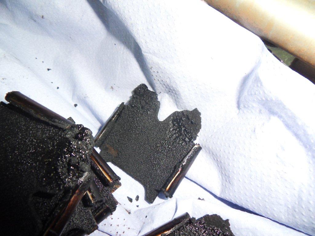

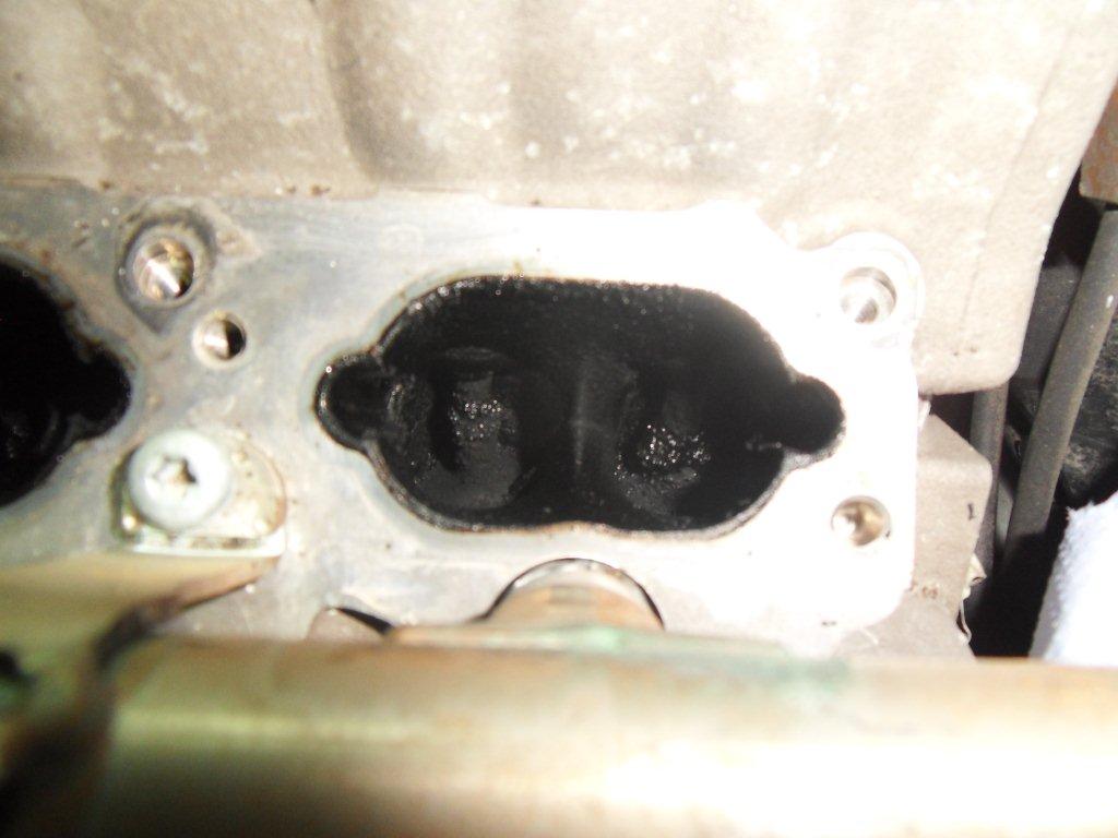

Thanks to MRC who de-coked my car in Dec. Finally got round to posting the pics. Doug said it was one of the worst he'd seen which probably explained why power was down at 358PS at the time.

Shocking, what did the power go up to afterwards?

Doug reckoned the cleaning / porting would take it to 415ish. However, I also has a new air filter and remap done so end result was 434.

What's the history Steve?
Mileage, distance between services, type of use etc?
Any idea how long it'll stay clean?

Previous owner did 20k miles pa for 3 yrs. Mostly sitting at 3500rpm on the motorway. Serviced by Audi on long life approx every 12 months.
I'll do my best to keep the carbon at bay by spinning it up to 8k every so often!

honestly, those don't look very bad...
20k miles?

ArthurPE wrote:honestly, those don't look very bad...
20k miles?
+1
You say ported, do you mean you had the inlet manifold ported and tumble flaps remove?
20k miles?
20K per annum..... :wink:
20k miles?
Eh! Not exactly benifical to optimium performance though.

Yes, IM ported. Car was at 70k miles when these photos were taken.

Give Doug a call at MRC for a quote. Main cost was 11 hrs of labour.
