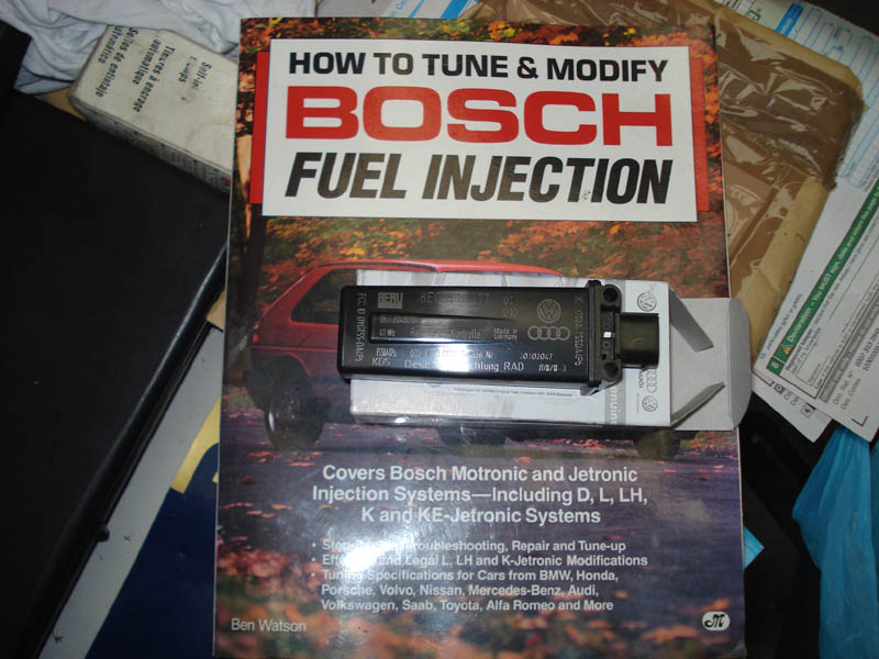

neckarsulm
Posts: 4468
Location: The Point
RE: Re: RE: Re: RE: Re: RE: TPMS antenna fault epidemic..
Post by neckarsulm » Wed Feb 02, 2011 6:36 pm
Got the antenna today, size of a mobile phone.

neckarsulm
Posts: 4468
Location: The Point
Post by neckarsulm » Wed Feb 02, 2011 9:40 pm
Pic of antenna
