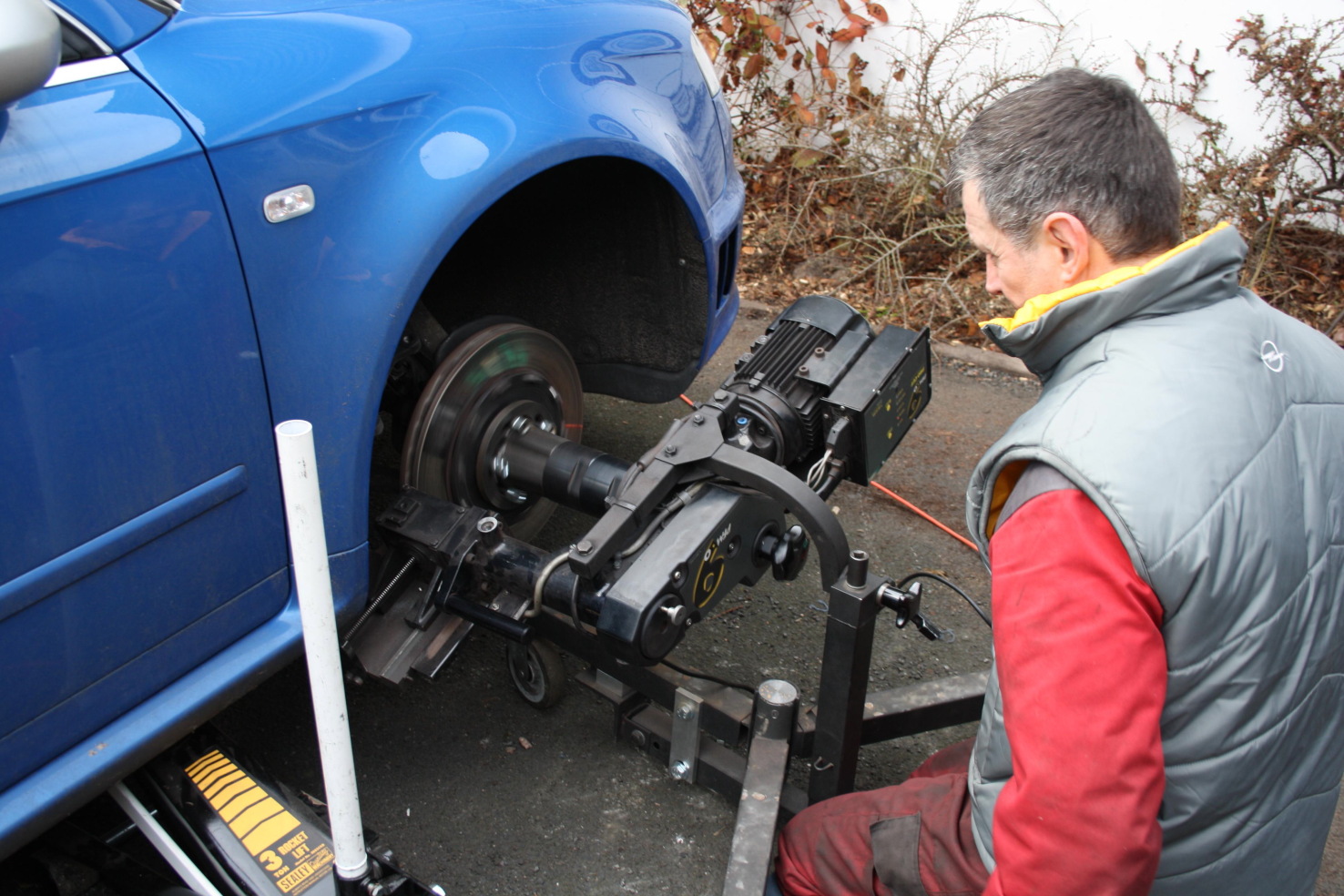

I dont usually start topics on here but I just wanted to share with everyone the Brake Discs, I've just had skimmed today.
I purchased some Front Brake Discs off Ebay which were practically new they had covered a maximum of 500 miles.
I had them fitted last week with new pads by a local Vw Audi specialist . But on driving I was getting a Judder
at any speeds over 35 mph, it got a lot worse over 50. The steering was shaking on breaking.
The discs were badly warped.
I then contacted Marcus Bailey a Disc skimmer from Cambridge. He got back to me straightaway and said he could do them,
although the front discs on the B7 are semi floating. I was quite hesitant on getting them done as people had told me it cant be done.
The chap turned up outside my house on a saturday morning in Birmingham after a 120 mile trip at 9:30 and began work.
It was the first time he was doing a b7 but had done a few b5's before.

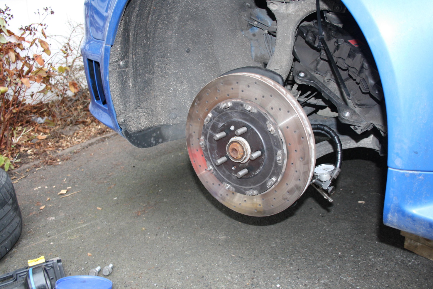

He began by jacking the car up and removing the Caliper and cable tieing it to the suspension. The machine then does its work.
Upon completion 2.5 hours later we went for a test drive, and the car driver absolutely perfect, no judder or anything at all.
Marcus used to be a Gearbox enginneer for the Williams F1 team and I must admit I was well impressed by his service.
He came from Cambridge to Birmingham a 240 mile trip and only charged £130, which isnt even Audi's hourly charge, he saved me £700(Cost of new discs).
I would recommend him to you all.

Just bumping this as after repeated reminders from Doug about getting this done, Marcus is coming out to mine tomorrow to look at my setup and hopefully resolve the last bit of judder I have.
£60 a disc to skim plus 30p a mile if he visits.
Worth noting that EBC in Northampton (pro-cut disc skimmers) - apparently a "premiere workshop" - said that you can't skim discs on the car when discs are semi-floating. Marcus uses exactly the same machine but can. Tells you something about the recommended workshops on the skimmydiscs website!
Anyway - looking forward to tomorrow.

All done. Initial results are impressive so far. Bedding in (doing 60-20 stops) by the 3rd one you could really feel the bite was hugely improved. I used my existing pads so it will take 100 miles or so before they're fully up to performance as the pad needs to be reshaped to the new true disc.
Of course, the real test is the nurburgring. I'm still a sceptic (that the problem wont come back) but Marcus assures me it wont - and if somehow it does, he'll come out FOC to investigate. Can't say fairer than that.

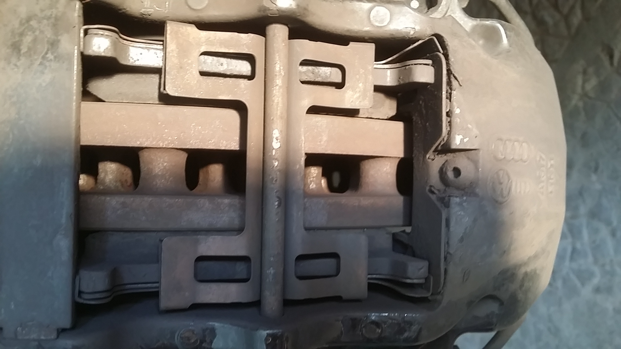

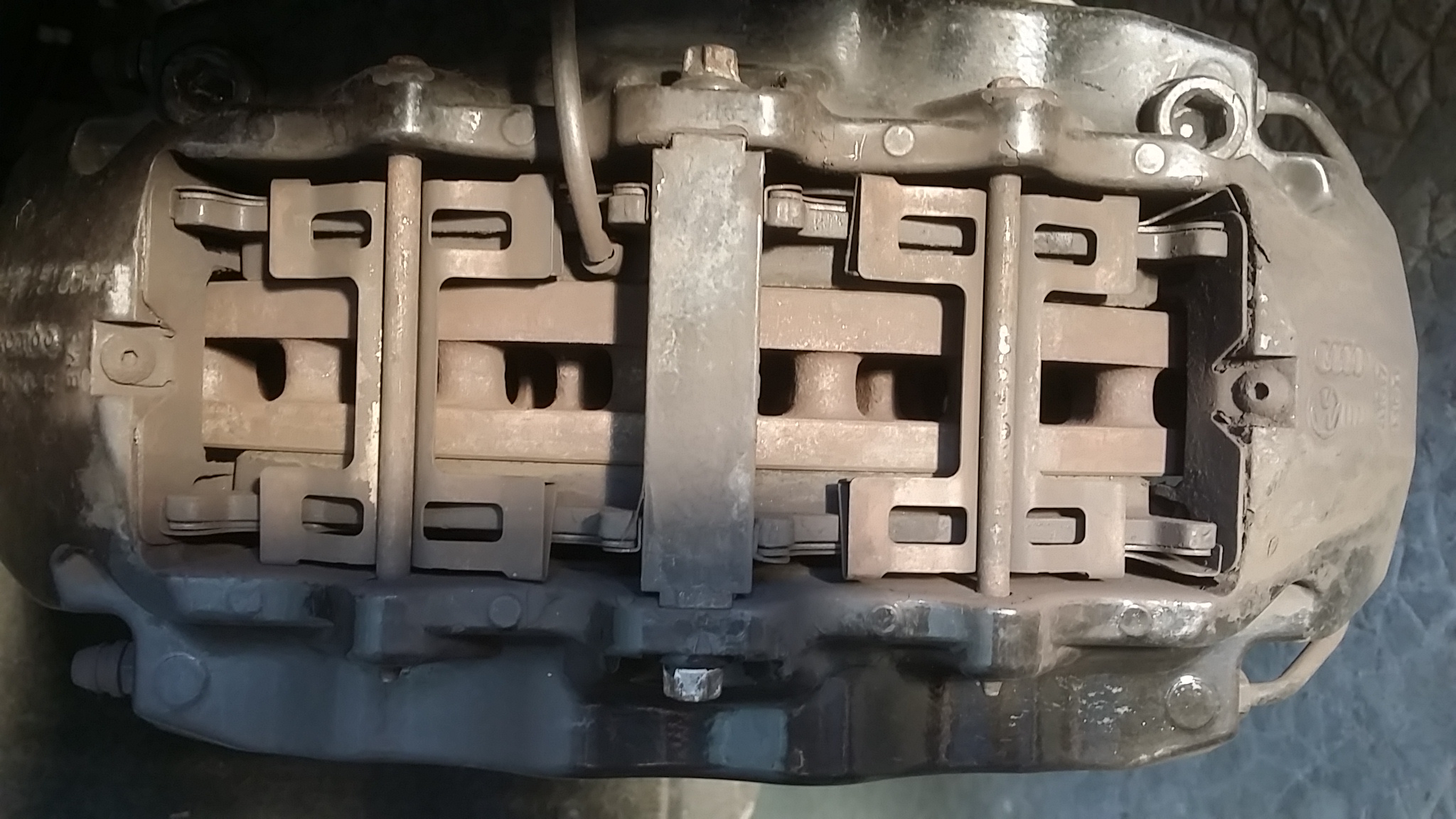

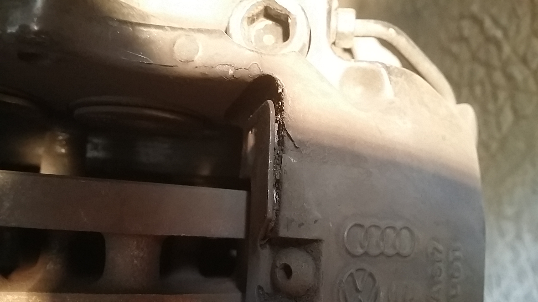

Although slightly off topic, I want to mention caliper corrosion. This has been mentioned in other threads and I have been advised in past posts to remove the corrosion.
I finally got around to doing the job and I was surprised at how much corrosion there was, more in the lower pad area. It used to be quite difficult to push my car because the pads were not able to move away from the discs. I noticed this one day when trying to push the car and hearing brake noise. When I finally took the pads out there was a lot of corrosion to clear away. Basically, my lower pads were always in contact with the discs. It was very, very difficult to extract the lower pads, I struggled for 20 minutes to get them out. Look at photo number two, that lower plate should be flush with the caliper body but it was pushed up by corrosion by about 3mm causing the pad to jam and not be able to move back and forth. It took a while to clean both calipers out completely but it was well worth it. The car moves far move easily now and rolls on slightly downhills which it did not used to before. After completing the job I took the car to Audi and had new discs and pads fitted, and the car has been fine ever since. The caliper corrosion job has changed the way the brakes feel, and I will be doing it regularly. The only disadvantage is the aluminium is now exposed and will corrode more. So, when I have some time I will remove the calipers and have them refurbished and repainted. I can't recommend this job enough. It was a little overwhelming at first but I followed Sonny's post about brake pad removal and no problems. Thanks Sonny!
