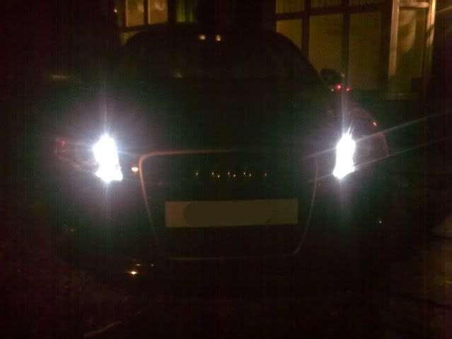

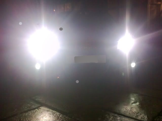

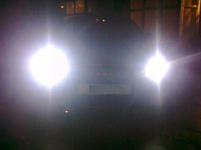

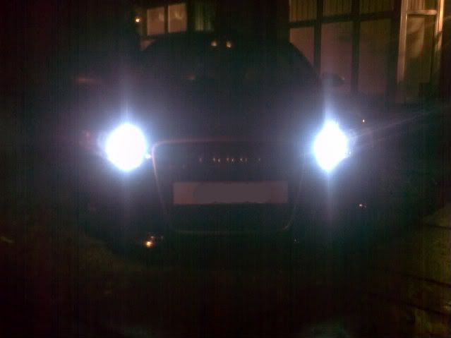

ok so little update i fitted the resistors to the DRL lights, and they look awesome (if i do say so myself) much better than yellow light.
iv not checked how hot they get yet will try that out tomorrow after a run. iv read these are cool running so will be fine to mount inside the headlight unit,
sidelights
http://www.car-mod-shop.co.uk/WHITE%20C ... egory_id=0
(no resistor required)
DRL
http://www.car-mod-shop.co.uk/Canbus%20 ... egory_id=0
http://uk.rs-online.com/web/search/sear ... 4r&x=0&y=0
Dipped + Sides (nothing required)
Dipped + Sides + Fogs
http://www.car-mod-shop.co.uk/LED_Fogli ... ight_bulbs
(not done resistors yet for these)
sidelights
DRL
