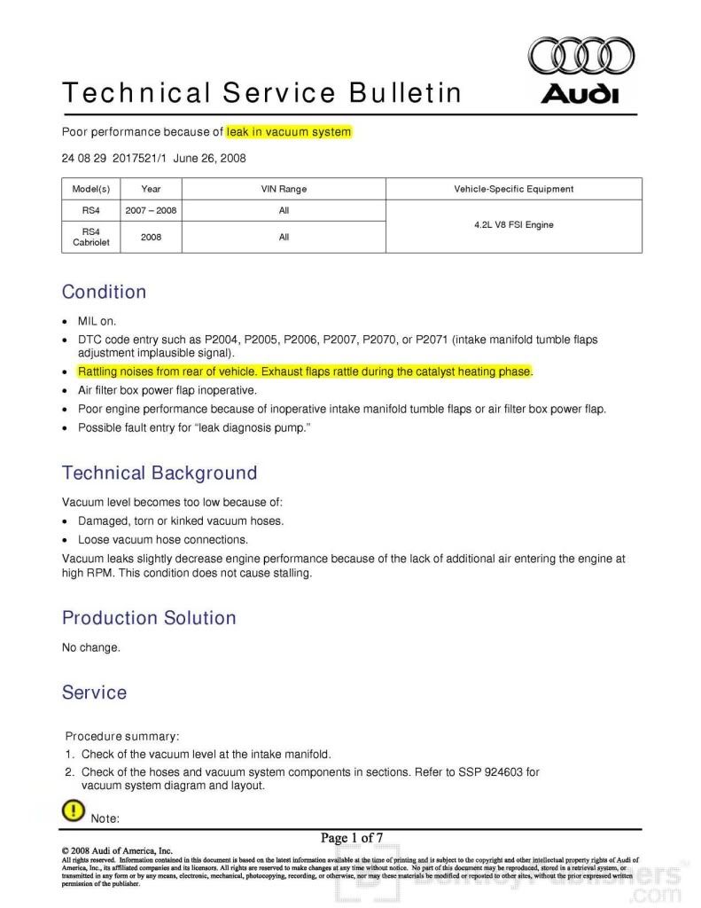

so far I have had the secondary air pump replaced and they said they found a kinked pipe under the rear bumper and repaired that, they said they have also replaced a solenoid all at a cost of over £1000 got the car back yesterday started it up this morning and the flap are still rattling i think I'm being ripped off, the top tech came out from Audi to see the problem from cold start up and he said i needed new flaps til i showed him this post don't know what else to do, anyone got any ideas?

Mine also rattles on cold start up albeit for 10 seconds or so. I suspect that all will to a certain extent as I believe although am not sure that the engine does not have the capacity to hold vacuum pressure so will need the initial seconds to establish vacuum pressure again.
Easy way to check is when you hear the rattle in your exhausts feather the throttle to 1-1.5k rpm for 5 or so seconds and then let it idle. It should go after that, if still audible you have a problem.

my rattle (and slight loss of power) was fixed by audi by replacing a solenoid.
