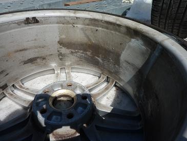

Detailed wheel pics! 6 hours, Farecla gmatt flattening liquid. loads of elbow grease.
before

good job! what products did you use to do that apart from elbow grease???

A friend of mine works for a smart repair company and he uses Farecla products. they do compounds etc. one of their products is called Gmatt flatting liquid and it's a mild abrasive. you apply it with a scourer.I know it sounds awful but after 4 years of grime the wheels were in a bad way. you slowly work the cream into the wheel using water as an adjutant. after about an hour and half on each wheel I then got the tar spots off with intensive tar remover from Autoglym. Finally two coats of wax for protection and an easier clean next time!
